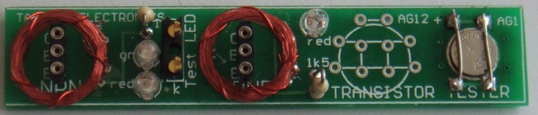

Interested in doing an BJT (Bipolar Junction Transistor) -- tester. Like the continuity tester project just completed, it would be an contribution in the form of an article to this site. I have never done an BJT tester before, and I am interested in hearing, or rather "reading" -- your thoughts on how you would go about engineering such an project.
:: Requirements ::
  1. Battery powered with power switch
  2. Identifies NPN or PNP types
  3. Indicates short or open circuit
  4. Uses LEDs to denote conditions and identifications of types
  5. Budget of $3 max in parts (based on Tayda Electronics pricing)

Basically I am looking to produce PCBs for a dozen or so 'simple' projects with the intent of selling them in KIT form for a few dollars only later on down the track in an hobby electronics shop...
Excellent. Any ideas on adding extra features to this skeleton design?
Looks like an excess use of not needed parts after seeing the one above.

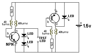

Here is the simplest transistor tester:
Looks decidedly like a joule thief blocking oscillator.
Nigel, I don't see the longer named circuit working. Resistor R2 is shorted, and reversing the transistor leads under test may yield false readings.
