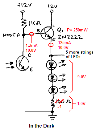

audioguru, thank you for catching that blunder. I am not an electrical guy...more mechanical...so I'm trying to catch onto what you're saying. Take a look HERE.
Now would this work? I didn't quite understand the "3rd transistor", is the 2nd transistor the emitter-follower? So I would put the emitter follower between Node A and Q1?

You can use a 2N4401 transistor that has a max allowed current of 600mA and has the same amount of current gain as a 2N2222.
Now you have 3 LEDs in series. So their current changes a lot if the battery voltage changes or if the actual forward voltage of the LEDs is high or low.
There is not enough voltage available for three 3.5V blue LEDs in series.
The transistor draws base current that reduces its base voltage. I changed the current-limiting resistor to 51 ohms to allow for the voltage drop.
The base current for the transistor is much higher now than the original circuit had, so the amount of light to switch the transistor on and off will be different.

Oh cool! You have straight lines and printed text.
Your 2N2222 transistors are fine.
I showed that there is only 10V available for the LEDs with their current-limiting resistors. Three 3.5V blue LEDs need more than 10.5V.
Two Blue LEDs are 7V so (!0V - 7V)/20mA= 150 ohms for their current-limiting resistors.

500mA?? Six strings of 20ma= 120ma. The transistor is an emitter-follower with a minimum current gain is 100. So its base current is a max of only 1.25mA.
Sorry for the misquote on the emitter current.
Most of the values given for beta in my copy of the data sheet are given at Vce of 10V. Saturated beta is somewhat less.
This emitter-follower doesn't saturate. It is a linear amplifier with 1.8V across it.
For a low current common-emitter transistor I use a base current that is between 1/10th to 1/20th of the collector current for it to saturate as well as it can.

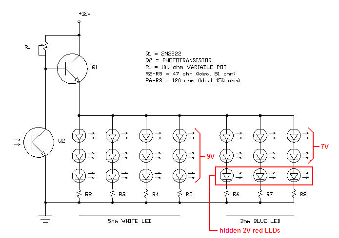

Okay welll for the good news, the modified circut works somewhat without anything overheating or blowing up:
I subbed in resistors that were as close as possible to ideal.
The only problem with the circuit is that with the blue LED's light up sooner and seem to be more sensitive than the white LED's. Could increasing the R6-R8 values help with balancing the current flow? Or...what about this?
Then I could use R9 to trim the gain of Q3 and allow for even load. Is this a good solution?
I worked on the electronics for an hour or so last night and was in the shop for a few hours working on the mechanical bits. Once I finish the electronic design and have all the mechanical parts done I can begin assembling it and show what I've made. :D
Your problem is that the two blue LEDs begin to light with 7V but the three white LEDs need 9V.
So add 2V red LEDs in series with the strings of blue LEDs, hide away the red LEDs and adjust the series resistor for adaquate current and brightness (nearly 47 ohms, the same as for the white LEDs).

audioguru, the fiance loved the "night light" I made. Thanks for the input! Check it out, it's all raw stainless steel polished to a mirror finish and all the edges of the acrylic polished as well...took easily 25-30hrs to build from start to finish.
