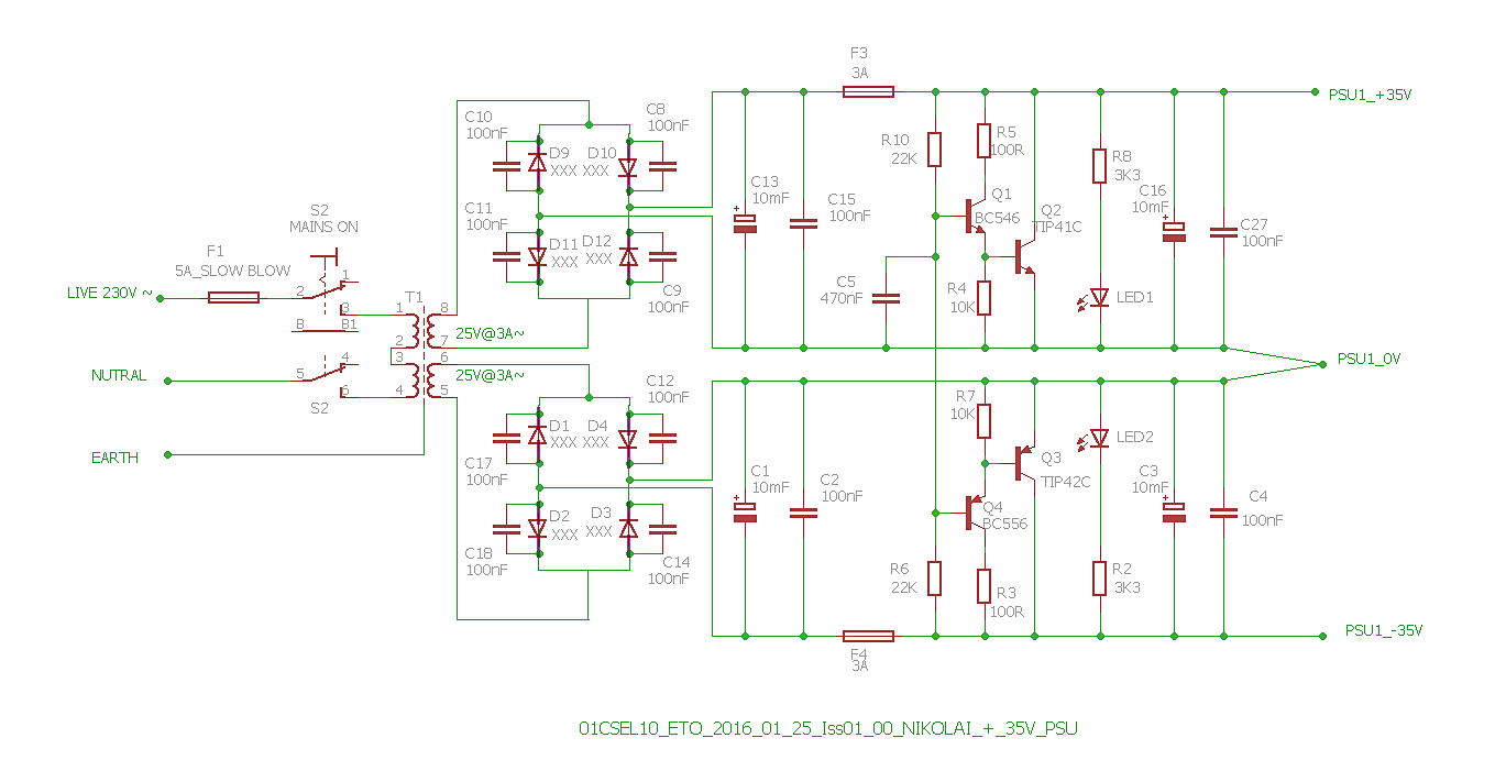

Ah, only need 1 fuse in main power 220V? Because one supply rail which the fuse didn't blow will destroy my amp? Or make a relay circuit that can turn off both supply rail when only one blow?

No fuses are best from a hifi point of view, but if you do have fuses you must make sure that if one fuse blows the other will too. That will protect your speakers and limit damage to the components in the amps.
A relay in the PSU would be the Rolls Royce approach and can be used to provide not only protection but also to eliminate turn on and turn off thumps in the speakers.

Here is a +- 35V PSU which I did before I read your post above:
ERRATA
(1) Change TIP41/TIP42 to TIP35/TIP36
(2) Place a 1R 2W resistor in the collectors of the TIP35/TIP36
The amp need at least 9A power supply for safe reason. So TIP41-42 will not work well, use TIP35-36 instead.

The amp need at least 9A for safe reason. So TIP41-42 will not work well, use TIP35-36 instead
Do you mean TIP35- TIP 36 for the protection circuit. If so they would be better in theory, but TIP 41/ TIP 42 would be fine. The protection transistors don't normally don't do anything, but if the two supplies get out of balance the power transistors will conduct a huge current and blow the fuses pretty fast. After that they will do nothing again so their average power dissipation will be extremity low. They don't even need to be on heat sinks. Not sure what you mean by 9A for safe reason. If you are talking about the transformer current capacity the more the better, but under normal use, the two 3A quick blow fuses should be fine. The RMS power of an audio amp is very low. But you may like to fit 5A fast blow fuses if that makes you happier. Note that the fuses and fuse holders must be solid high quality types.
UPDATE Yes TIP35/TIP 36 will be needed. I had forgotten about discharging the lage reservoir capacitors.

The PSU is not stabilised. Normally the four transistors do nothing. They only conduct if the + and - supplies become different under fault conditions. Then they conduct a large current and quickly blow the fuses, so that both supplies output zero volts and your speakers are protected. If this happens you will need to replace both fuses to get the PSU working again.
It can overload or shorted protecting, right? Because overload or shorted cause voltage drop, so voltages will not balance.

If either supply line is overloaded the line voltage will drop, but the other line will stay the same. The protection circuit will detect this and blow the fuse for the good supply line. Then the transistor on the bad supply line will blow the fuse for that too. The net result will be that there will be no output voltage from either power supply lines.
If both supply lines are loaded equally, say by loud reggae music (continuous bass line), the protection circuit will be happy and do nothing.
