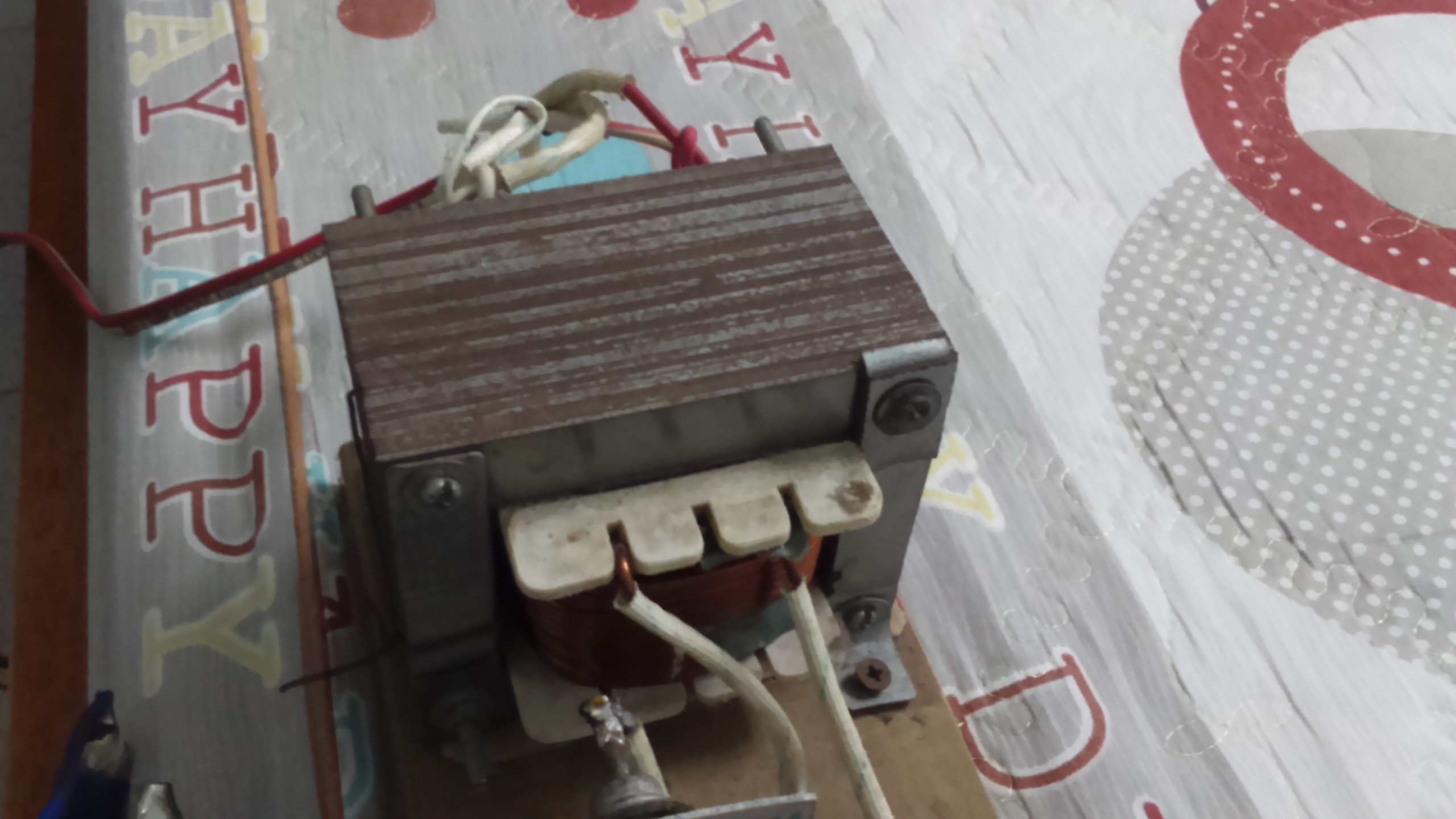

My EI transformer in a cheap half waves rectifier car battery charger. It is noisy, I think this problem cause by iron laminations weren't pressed firmly enough, and magnet wires don't make good contact to the core's insulator.
Thanks.
My EI transformer core size is: 5.8x3.2cm
Hi Nikolai,
Sorry to say that the battery charger transformer will not be suitable for a high end audio amplifier. The transformer is one of the foundation components. The buzzing, if what I think it is caused by, should be quite easy to fix unless the transformer is being run close to the core saturation points (negative and positive). As a matter of interest though, are the dimensions you give for the core that the wingdings go on? Can you post a picture of the transformer?

The battery charger transformer is probably made to be intentionally lossy or "energy limiting".
Yeah, that's what I though- some low grade cheap material- the exact opposite to what is needed. A nice jucy microwave transformer would probably do the job, but may be too large for a reasonable size case, if not a torroid.

Hi Nikolai,
That transformer is not good enough in all respects for an audio amp, but would probably be Ok for making a bench power supply for example. Yes, I think a torroid is the way forward.
