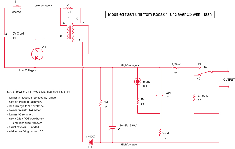

Flash Camera Discharge
Attached is a modified circuit from a flash camera. I'm not too sure how this is working and am still trying to figure it out. But maybe you can get some ideas from this since your trying to accomplish almost the same thing. There's a transformer in this design and not sure why it's needed.

Oh so the flash requires the high voltage. 1.5V wouldn't be enough to activiate the gas inside the tube?
With the capacitor storing that much energy I wonder if dliqdzovuk idea can be used to discharge the cap.
