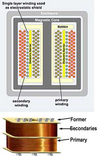

I'm a hobbits. I'm going to re-wind a laminated EI core transformer.
I've to choose between two winding options.
-First wind the primary(230v) on the bobbin, add lamination layer (lamination paper, etc), the wind the secondary(24-30v) on the lamination layer (like the top pic in the attachment).
-Using a partition on the bobbin to make separate sides for primary and secondary (like the bottom transformer in the attachment).
I want to know which is better and why?
Please suggest me.
rgds.
Didar

There are a couple different ways to view this.
First, the layer on layer method provides the tightest coupling which means less leakage inductance. This provides for the least isolation safety however.
The side by side method is the best for isolation, and is actually required in order to pass a certain safety standard class that is good enough for humans to use in everyday life. There is some leakage inductance however, and that can be good because it helps filter the DC output if you intend to make a DC power supply out of it with rectifiers and capacitors. The output voltage will be reduced with load however.

Didar Said "re-wind a "laminated" EI Core transformer.
So GUY's, It must be an Iron Core, 50 or 60 Hz Power Transformer.
My Opinion, Either Secondary Over Primary, Or Side By Side is OK.
If you have a Separated Bobbin for Side by Side, it gives better Isolation and is generally Easier to work with.

you should seperate 2 coil because heat release from coils not small. if wire wasn't wind well, quality of wire and core not high (such as poor core made from steel without silicon) your coils might overheat cause burn or hot wires have high resistance so it decrease transformer efficiency. if you wind the primary first then add layer layer then wind the secondary, your may have trouble if primary coli have a problem and need to replace.
my transformer used in lead battery charger wound primary coil first then the secondary. after short time, low quality diode broke down, DC current from battery passed through secondary coil made it generate heat to burn, the primary coil also "semi-burn" because heat from the primary. It spent me a lot of time to rewind my transformer.
BUT the first windind option make the transformer more efficiency (as MrAl said) than the second if cores and winds are good because less inductance leakage.
You can buy core like "C core" to improved efficiency. I saw this kind of coils in many Russian machines and power amplifiers. Very little hot and less hum release to the air.

If your Primary Inductance Value is Correct for the Line Frequency and you use a 24 AWG for the Primary and a 16 AWG for the Secondary.
The Output Voltage should remain fairly Stable with 2 amps out.

If your new to winding transformers definately wind the pri and sec as seperate windings for safety.

No problem then. Keep the 2 windings apart.
My laminated EI core transformer core size is 25mm x 30mm, primary 230v, bobbin height 38mm (between top & bottom boarder, window width (from bobbin to core arm) 12mm, primary wire diameter 0.315mm(without insulation), secondary wire diameter 0.914mm

You have not specified the frequency nor the current, nor the secondary voltage required.
Just to start, assuming 50Hz and 10 percent max primary over voltage and laminations interleaved 1x1 and Bmax=20kG, you should use at least 5 turns per volt.

Based on the 5 Turns per Volt, If you wind 1150 Turns of 24 AWG for the Primary and 130 Turns of 16AWG for the Secondary, you should get 26 VAC out at 2 Amps.
Assuming you have Enough Space.
Don't Know Spacing of a Split Bobbin, So Using Secondary winding Over the Primary .
Based on 24 AWG (.53mm dia wire) with careful winding you should get about 56 turns in the 30mm Space
So it will require approximately 21 layers of wire, so that is an approximate 22mm in height.
Their Might Not be Enough room for the Secondary.
