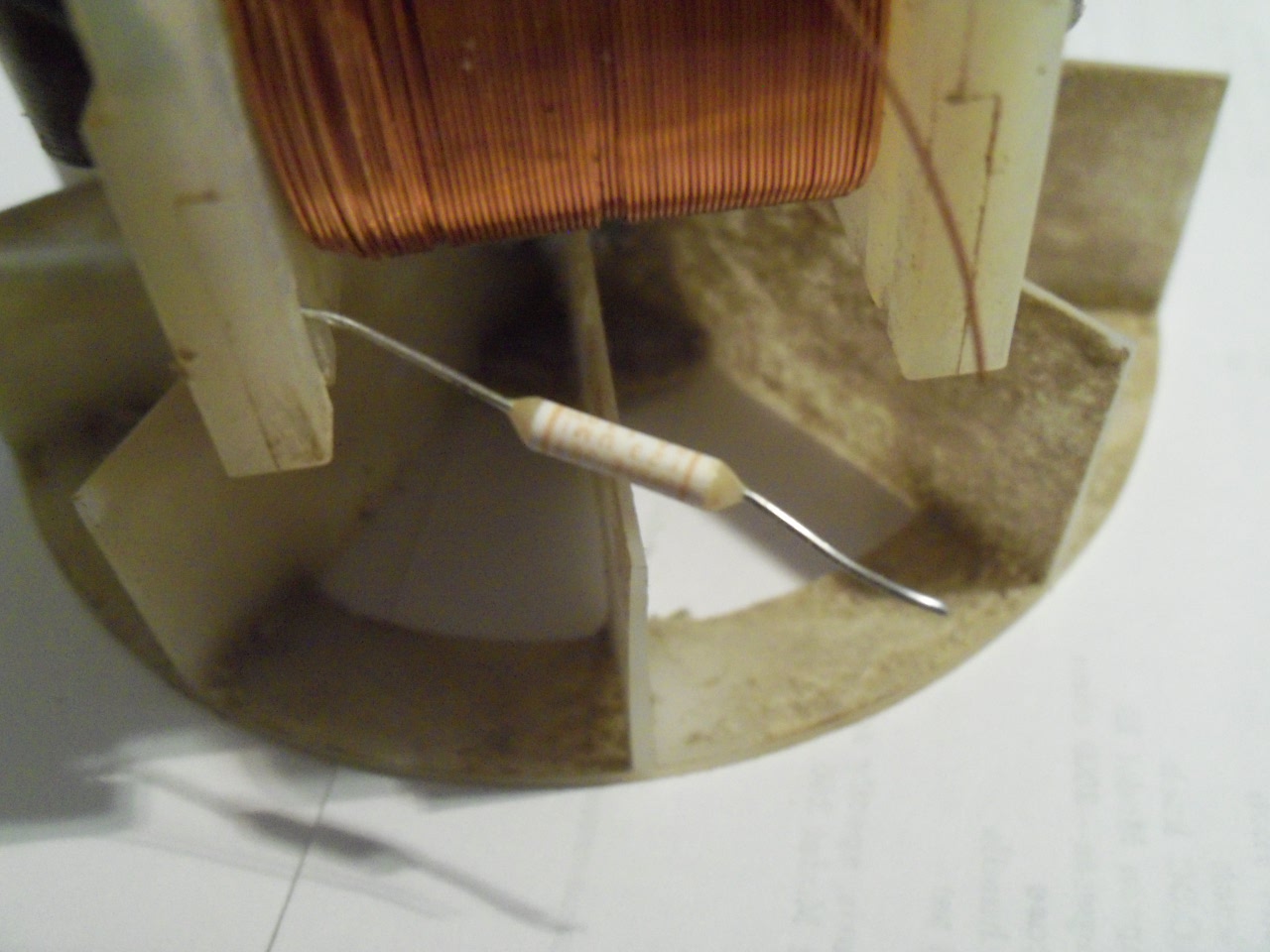

Does the fuse OPEN by temperature or amps or both?
What is the official name of this fuse?
Where can I buy a new fuse local?
I was hoping I could use a 1N4007 diode for a fuse but probably not.

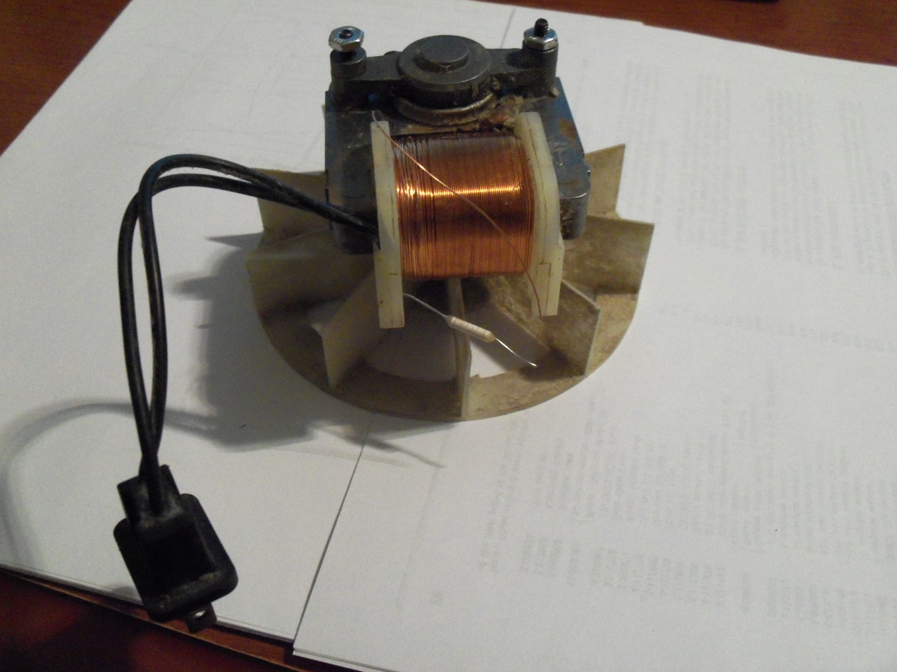

Exhaust fan in both bathrooms stopped working, both motors needed oil now they both turn good again. I bi passed fuse on work bench works both motors run good.
It looks like it could be one of these?
YES that is it. NO one local has a clue what that is. LOL. Both hardware stores said, people buy new bathroom fans almost every day because the motor stopped running, I had no clue it was something so simple as a hidden fuse.

because these fans are usually employed in high humidity environments, the fans that I have had to replace look exactly to the one in your picture.
And again, the shaft has almost seized, and therefore the motor draws a lot of current attempting to turn.....and the double-whammy of not having an airstream to cool it.
It's a standard thermal fuse - easily available at any electronics parts company (such as RS above) - no good asking at a hardware store, it's nothing to do with them.
However - as far as the fan (or whatever) manufacturer is concerned, it's a non-replaceable item (RS sell them for manufacturing, not so much for repairs) - if it's blown there's generally a reason for it. So if you replace it. cure the fault as well or it will blow again.
That appears to be a shaded pole motor, the most ineficient of the AC variety and run Very Hot, which is normal. ;) .
Check the oilite bearings for drying out.

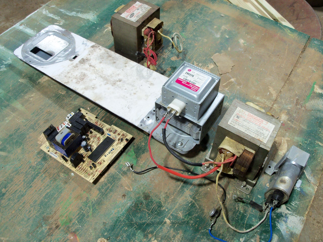

Thermo fuses are in tube audio amp output transformers & power SP transformers these days.

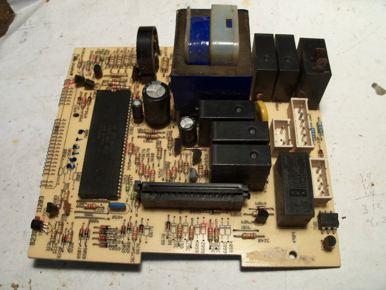

There is a thermo fuse inside the tiny 120v transformer on a microwave oven PC board.
I got 2 free microwave ovens on CL big over the stove cabinet mount, I scraped them for parts. I hope this little PC board transformer puts out 12 VDC I need 12v to turn on a mosfet when 50v PS comes on. When I get time I will see if the transformer works it could be a bad thermo fuse.

In decades of repairing microwaves it was VERY unusual to find a duff low voltage transformer.

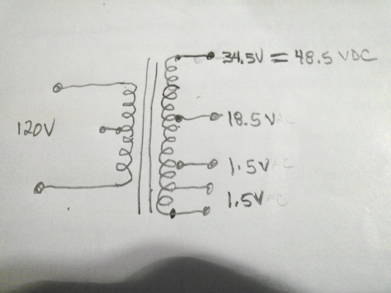

I don't recall ever seeing a microwave oven PC board with no step down transformer. Most test 9v or 10v some are 12v but this transformer it strange look at the drawing. There are 6 relays 1 is marked 24VDC. 24.5vac goes to bridge rectifier = 48.VDC on my meter, the big cap next to transformer is 100uf 50vdc.
