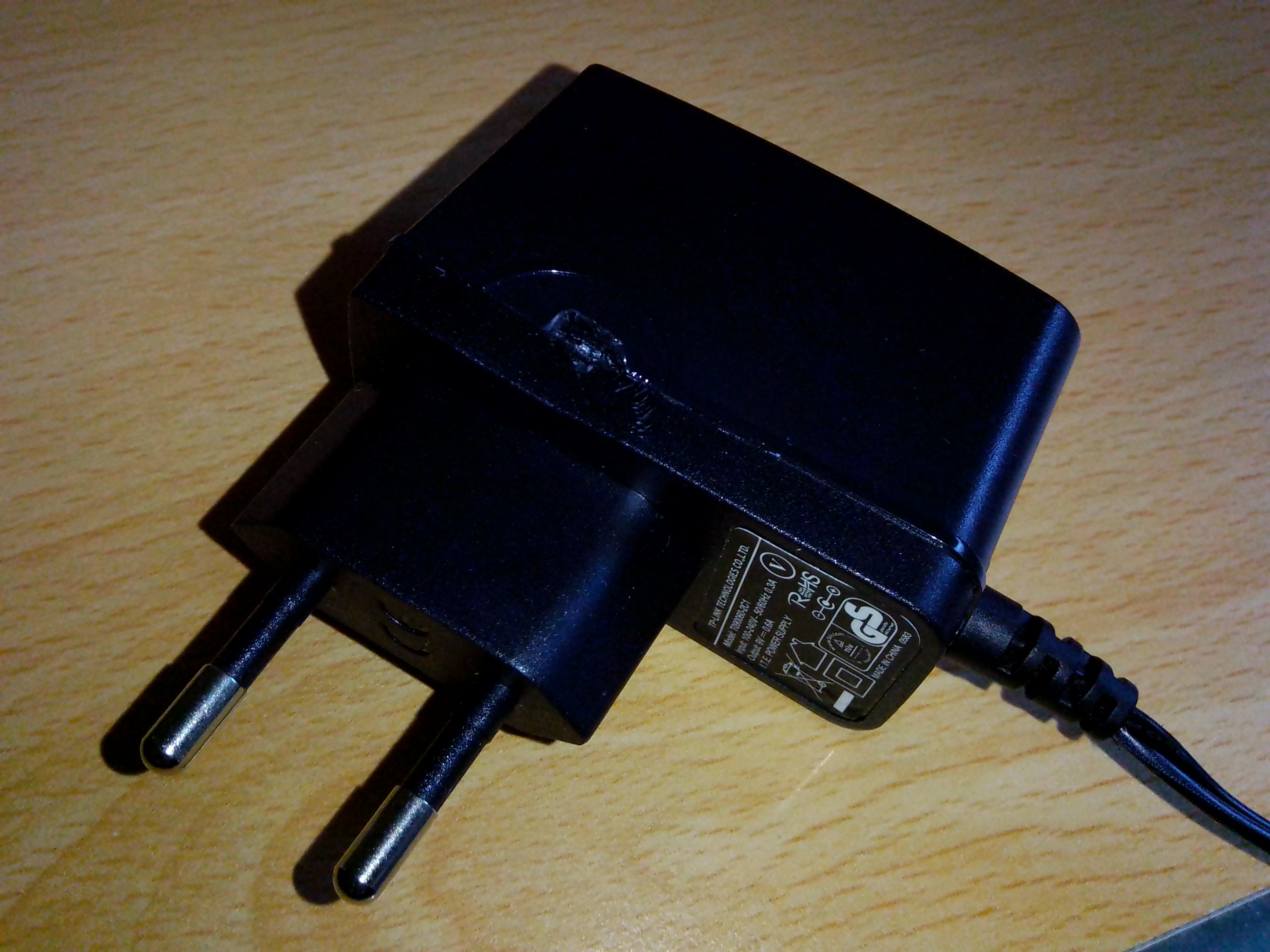

Most likely high ESR electrolytics in the external PSU, a VERY, VERY common problem on routers (and much other equipment) - I've even seen it where it's wiped out ADSL for most of a street.
If you've got a laboratory power supply, try feeding it from that instead and see if it works OK.
It would have been a good idea to try the PSU from one of the new ones on a 'faulty' old router, and see if that worked - but that ship has long since sailed.
I used another PSU and it seems it's working fine now.
Take the old supply apart, and you'll 'probably' be able to see a swollen or leaky electrolytic.
I've found the best way to split them is to saw round the seam with a junior hacksaw, gives you better control than a sharp knife or Dremel - oops, straight through the transformer :D
I thought adapter can be pryed out, but it seems that is welded together, so I will need a hacksaw after all.
I knew that! :D
That's why I specified a saw.
Question is, how to put it back together? :rolleyes:
Run a bead of epoxy resin round the seam, and wrap insulation tape across the two halves to clamp it together. You can use other glue if you wish, but epoxy is probably more permanent, and fills the gap from the saw cut.

I tried that, you can see it on the image, there's a hole made by screwdriver.
I tried to pry it out, but the damn thing wont move a notch, it's like a one solid peace.
There's no other way except to cut it.
