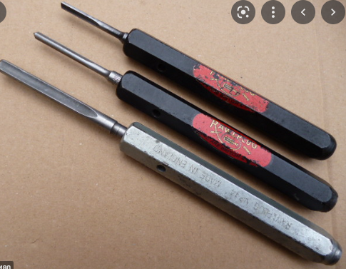

Yeah, this have changed since my start out days, Drill Rawlplug holes for fixtures with a hammer bit !. o_O
'Chasing' brick walls for sheathing with a lump hammer and cold chisel.
