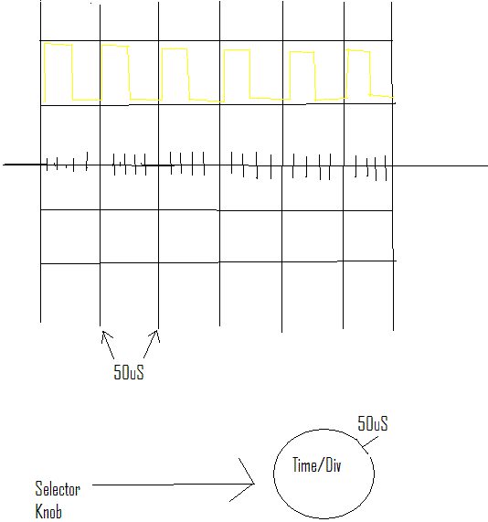

Scope grid for 20KHz
Ok, that is rock solid in between, However, from zero to peak it slopes upward?

Nah, you did not blow the chips. I seriously doubt it. The curve is a function of how long it is taking the capacitor to charge up. It is part of an RC time constant. As long as it is switching high to low and back, then it is working fine.
