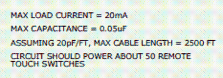

You shouldn't need a lower impedance driver, as the capacitance of the cable has been accounted for. Reflections won't be a problem either, since risetimes are slow. This is from the PDF that contains the schematic:
Cable? Well I was referring to like coax but I said he had some audio cable. Isn't that about 75 ohms? I see your spec on the length but my concern is with noise. If he used shielded cable that would eliminate any chance of noise getting into the circuit. Now he is using a MOSFET for the line driver, correct? It would tend to have a high impedance output and input and would be a bad match to say some coax cable like RG-174U. It all hinges on rather there is any noise pickup. Even running it through a buffer with a low Z out will reduce noise with open wire. Especially on the receive side.
