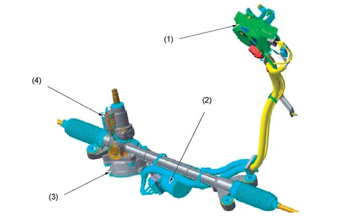

hello I'm needing some help I'm wanting to increase the power steering assist in my mums car who's struggling. I need a electronic devices to modify the torque sensor, has anyone done this before? It's a 5v sensor with two analogue outputs. 2.v volts at no torque and goes higher or lower depending on left or right. the second output is the mirror image of first. any ideas?

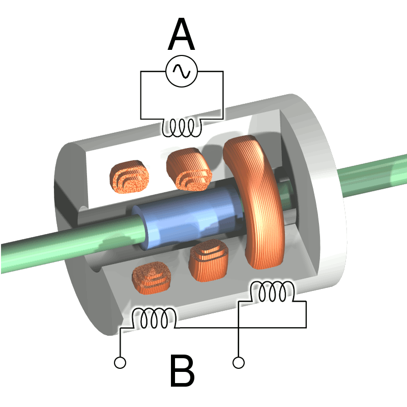

That sounds like it could be an LVDT sensor? They have two sets of coils and a moving armature.
In the centre position the outputs balance out, with equal and opposite voltages induced, but as the core moves the coupling is stronger to one coil than the other and a signal is produced, with the phase dependant on which direction the movement is in & amplitude dependant on the amount of movement.

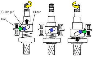

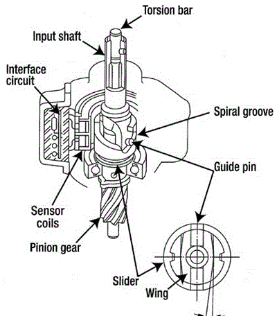

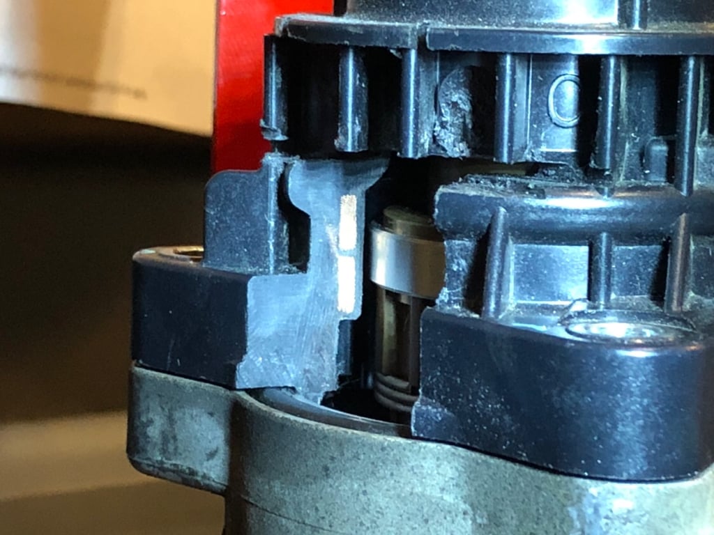

Hi Jimmey898, I wanted the same but for different reason. Possibly a turn know to either provide more or less steering assistance for track use. I hookup a multimeater and the power that goes to EPS rack is about 5v but polarity gets reversed. So for example where 0 is center if you turn left the positive cable is red and negative is green, when turning right the red becomes negative and green is positive. This is on the electric motor side. But I think the best would be to modify the input signal that comes from the tq sensor. It's 3 wire interference sensor. Inside it has two coils top and bottom and aluminum ring inside that is sliding up and down on the steering shaft. When you turn the wheel the friction of tires will cause the torsion bar twist on the shaft forcing the inside ring either move up or down to different coil.
I thought maybe it's possible to modify the tq sensor signal to either trix the EPS module that the torsion ring is farther in the interference coil. I think the more interference in the tq sensor the more assistance is added.
Here is tq sensor that I cut out to expose the two inside coils.
