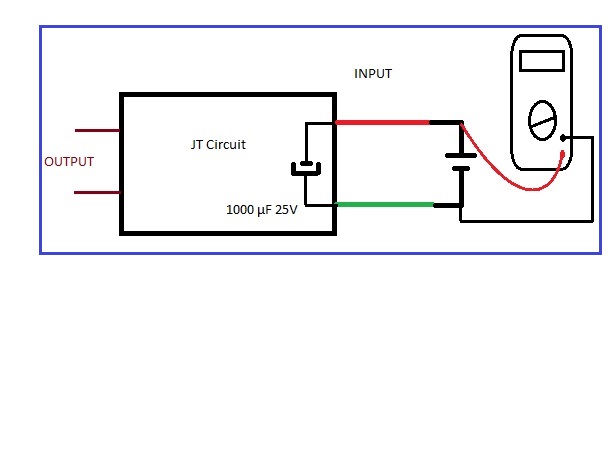

There is another observation: I attached a 1000uF/25V cap across the battery input of the JT circuit and tried to measure the input current with my DMM with 10A scale DC. It still went out of range!! Any more ideas on this will be greatly appreciated.

Not sure how you are measuring this. If you have the cap across the input of the board and your meter external to that, it should work.

Please find the circuit attached....
Thanks.
Thanks.View attachment 99827
To measure the current, you need to insert the ampmeter in series between the power source and the load. You need to break the red wire and put the meter there.
As you have it shown, you'll just measure the short circuit current of the battery. Which, even with a AA cell, could easily overload the meter.
Yes as Chris nicely pointed out in the post just before this one, when you measure current you need to connect the meter in SERIES with the load, not in parallel as you have it shown in your diagram (nice diagram BTW, very clear).
So connect the meter in series with the load (only) and try again.
Extremely sorry....That was a GROSS MISTAKE on my part in doing the diagram. I should have connected the DMM inseries with the JT circuit I/P. However, practically I did connect the meter in series and got out of range reading on 10A scale!!! Thanks.
