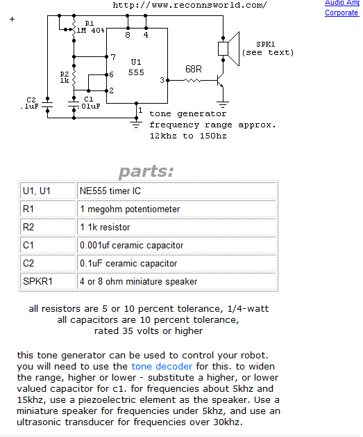

The max output high voltage of the 555 is only 4V and the minimum voltage is 2V.
With only 2V across it an 8 ohm speaker gets only 125mW for a sine-wave or only 0.25W for a square-wave.
No that's a worst case scenario when driving a load of 200mA.
In reality the saturation voltage won't as high. The load seen by the 555 will be the beta of the transistors multiplied by the emitter load.
For 2.25W an 8 ohm speaker needs 12V p-p and a 555 cannot supply enough current. The amplifier needs a 14V to 16V supply.
No, I was talking about the single ended driver I posted previously.
https://www.electro-tech-online.com/attachments/tone-gen-gif.32336/
The saturation voltage of the transistor is negligible, if the P = 6²/8 = 4.5W but the duty cycle will be about 50% so that becomes 2.25W like I said.
Without anything to limit the base current of the transistor then the 555 and transistor will both curl up and die.
Yes, you're right, you need a 68Ω base resistor.

I don't see why not. There are 1000s of commercial products which drive small speakers in this manner and all they work.
True, if this were an audio amplifier the speaker would clip sooner but it's not, it's just a simple buzzer so it doesn't matter.

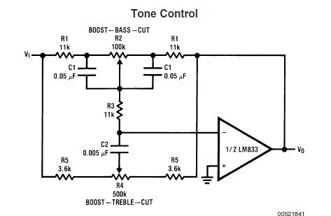

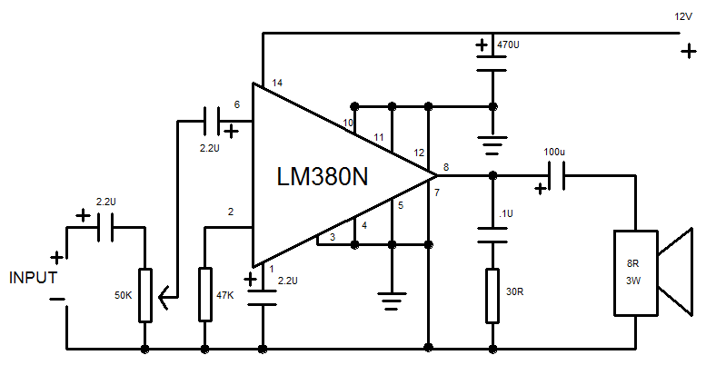

I have drawn a rough schematic using the LM380 which i have attached, if this is suitable for the 8 ohm 3W speaker can i also add a Tone Control using an IC. I have attached a Tone control schematic as well, this one using a LM833.
If i can use it, how to connect it correctly to the LM380 circuit attached?

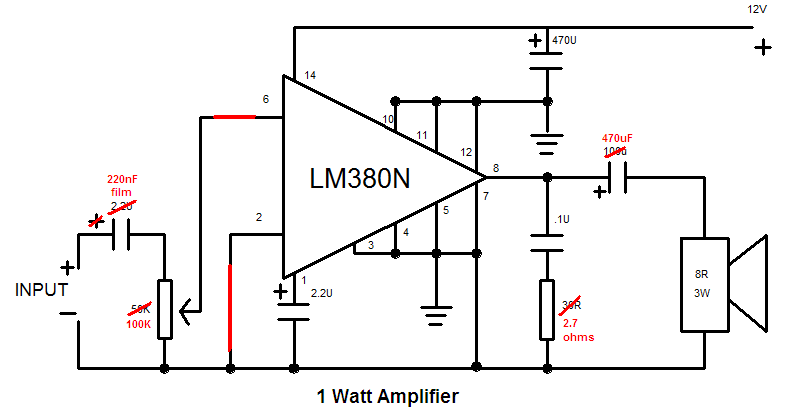

I corrected your LM380 1W amplifier.
The LM833 tone control circuit has one input grounded so it needs a dual polarity supply. It must be fed from a very low impedance like the output of an opamp.

I hope you know that a tone control won't alter the frequency, it'll just alter the loudness of different frequencies so I don't see the point unless this is an educational exercise.

Thank You for sorting out the amplifier schematic for me, much appreciated:D.
I understand what you say with the tone control circuit.

I understand about the tone control, i may need it to change the Bass tone so the speaker doesn't sound to cheap, maybe.
