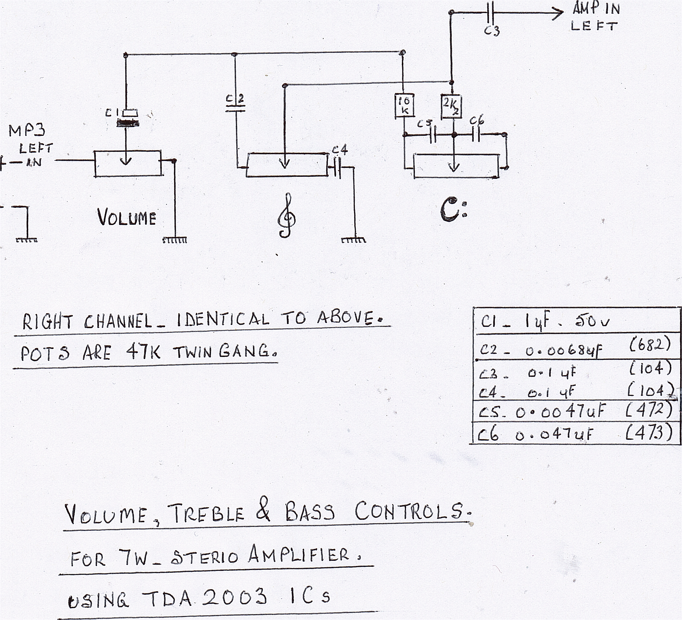

The 7w stereo Amp.that I built,using the Vellerman circuit (one of my earlier threads) works o.k.Now I want to replace the twin gang volume pot with
3 pots to acheive vol,treble & bass control.I have the 47k twin gang pots,&
a good selection of caps & resistors,I've designed a circuit that I think might
be suitable. The question now is-will it WORK?.Any suggestions welcome,and
I look forward to your EXPERT oppinion.Thanks Terry::confused:

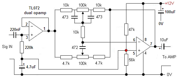

Your tone controls are passive and therefore cause a huge signal loss. Also the input must be from a very low impedance. Your volume control is not a low impedance.
Most tone controls are active with an opamp so there is no signal loss. The first opamp in my circuit provides the tone controls with a very low source impedance.

A quad op amp would, of course, allow you to build Uncle $crooge's tone control for two channel stereo with only one op amp package.
Your circuit looks interesting, I presume I need 1 for each channel? I've had a look at the data sheet,I shouldn't have done that,it's confusing.it shows pins1&7=out,
pins 2,3,5&6=in,this seems to indicate that the 8pin chip can be used for both channels.I will keep searching for a circuit with volume,treble & bass controls,
I have an unlimited stock of LM324N ICs,could 1 of these op-amps be used?

Your tone controls circuit is also missing a resistor to ground on its right side (for the bass control).

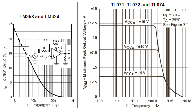

The TL072 has two opamps in it. Pins 1, 2 and 3 are for one opamp and pins 5, 6 and 7 are for the other opamp. That is why it is called a dual opamp. The TL074 has four opamps in it. It is called a quad opamp.
They are low noise, have extremely low distortion and have full output frequency response to 100kHz.
I forgot to add a volume control to the input of my circuit.
The lousy old LM324 quad opamp is very noisy (hissss), has 3% of crossover distortion and has a full output frequency response up to only about 1kHz.

Hi, i was looking for a schematic of an active tone control and i happen to stumble into your's and it looks interesting. Can you add a loudness switch with it? I think i saw a similar circuit on google but it uses a tapped potentiometer and some additional resistor and caps connected between the tap and the switch, i'm guessing that the switch must be some sort of a bypass to disable or enable the loudness function?
A tapped volume control is very rare. You can add a bass boost switch around the first opamp.
