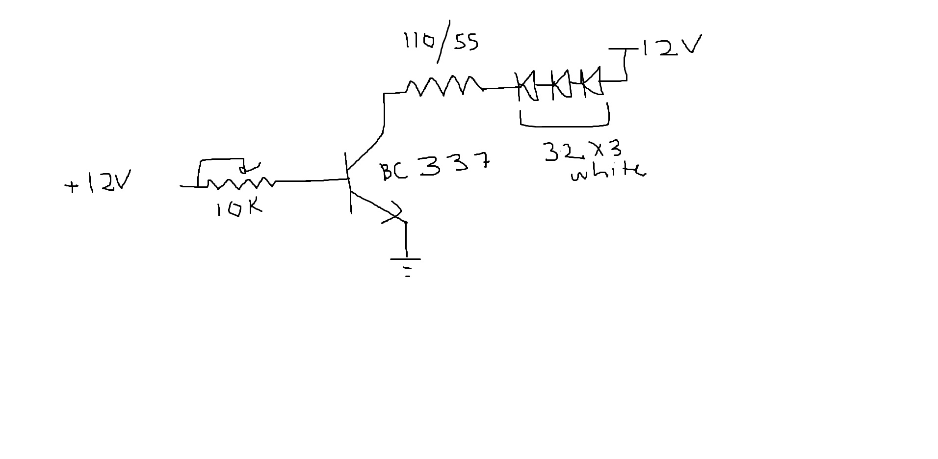

Experiment reading......using white led...
the bias of Bc337 is connected with 12V at 5.5k bias resistance...
Ib I1 one LEd I2 Two series LED I3 three series LED Rb series Resistance at collector with LED
2.1mA 83mA 51ma 24mA 5.5K 110 ohm
2.1mA 150mA 89mA 40ma 5.5k 55 ohm
but according to data sheet 1:10 so, at base current of 2.1mA it should reach maximum 20.1mA ..

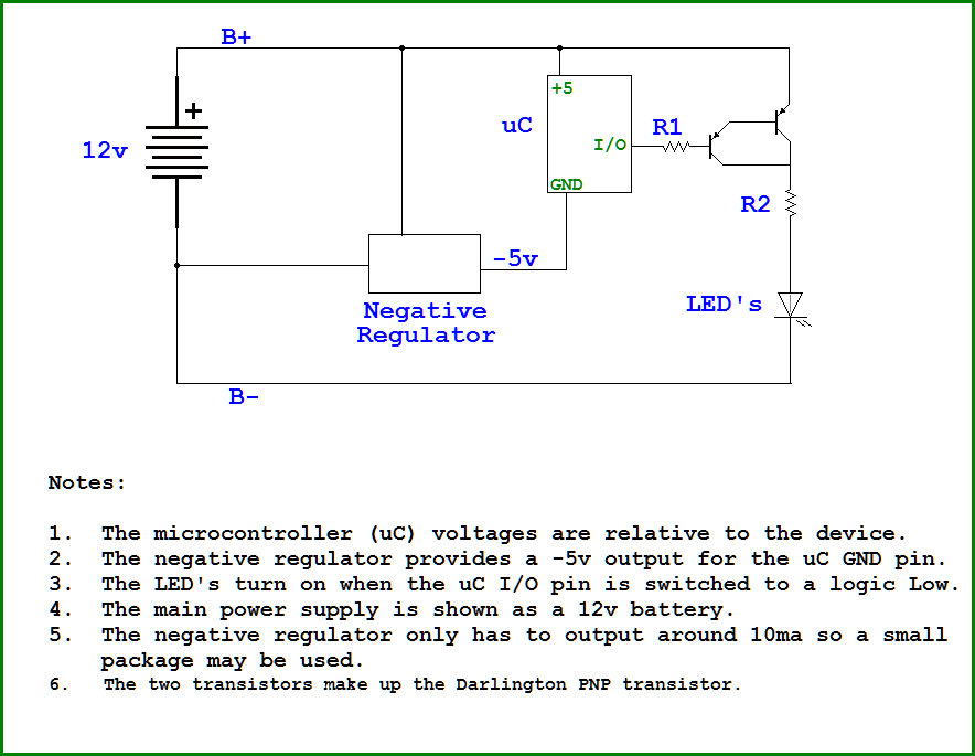

Here is a circuit that could work for your purpose.
The function of R1 is to limit current into the base of the Darlington transistor.
The function of R2 is to limit current through the LED's but the reason this resistor is needed is a little more complicated than that. It does limit current through the LED's, but another reason why it is there is because we can not depend on the Beta nor the transistor voltage drop as being constant over the whole operating time of the circuit. If we try to depend on the Beta being constant then we could get too much or too little current, and if we try to depend on the voltage drop being "just right" so that it drops the right voltage when turned on then we could end up supplying too much current to the LED's. If on the other hand when the transistor is turned on it happens to drop too much voltage, then we can not use that transistor for this circuit and would have to go to another type, probably a single transistor driven in another way.
Because of this a test has to be done to find out if the transistor can supply enough current with a low enough voltage drop to be able to drive the LED's properly.
Note we had to use a negative voltage regulator here because we had a PNP transistor to drive, but if we used an NPN transistor (or Darlington) we could use a positive regulator.
A problem that may show up here is because we are using a Darlington instead of a single transistor (with proper driver transistor) we dont even know if it will work right to start with. Because the LED's drop around 8v (from your other posts) if the transistor drops 4v then that is cutting it too close and so the output current level setting may not be reliable. It would be better to use a single transistor with another transistor driver set up differently and then use a proper size resistor for R2. A single transistor with driver may only drop 1v and so that means we can set the current level with that single resistor R2 and it should remain at that level.

I mentioned using a series resistor for the LED's in my post with the schematic. But if he wants to use say four strings then it would be even better to use four resistors, one for each LED string. So that would mean there would be four R2's as shown in the schematic, and four strings of LED's as shown in the schematic.
He also seemed to want to use a uC i/o pin to turn the LED's on and off so i showed a uC connected to the transistor and a voltage regulator for the uC, and that it is slightly unusual because we are trying to use a PNP transistor rather than an NPN (either Darlington's or not).
I also mentioned that the Darlington's voltage drop is a little harder to work with than a single transistor with another driver transistor set up differently. So i favor not using a Darlington and just using two transistors maybe one PNP and one NPN or something like that. That would give us much more predictable results and at the same time result in a circuit that is more stable over environment changes.
For example, a smaller NPN driving a larger PNP, with a base resistor for the PNP too and emitter tied to +12v, and a +5v regulator for the uC, and the uC i/o pin drives the NPN transistor base through a base resistor. That would be a better circuit to use rather than the Darlington. Of course we still need the LED strings current limiting resistors, but now the change in LED current with environment will be less so we can be more sure of the LED operating current over long time periods of operation like years.
I also suggested a 10ma base current for the Darlington which allows for high collector current even with lower gain. 10ma times 300 brings us up to 3 amps.
In post #27 Ritesh explains an experiment but did not show a schematic and did not say its supply voltage. He used a base current of 2.1mA and we hope he connected the polarity correctly for the collector and emitter. He wrongly thinks that the transistor will limit the current to 10 times the base current because he does not understand that it is a SWITCH. Luckily he used a series current-limiting resistor with the LEDs.
He used one white LED (maybe it has a forward voltage of 3.2V), a 110 ohm resistor and got 83mA which is enough to burn out an LED. Then the supply was probably (110 ohms x 83mA=) 9.13V + 3.2V for the LED + 0.1V for the transistor= 12.43V.
The LED used is Oval which has high brightness than normal ...work on 3mA to ~150mA for good brightness i have noted the current by testing.

Ritesh,
DO NOT use a trimpot in series with the base of the transistor like that because if its is turned down so that its resistance is low then the base to emitter diode of the transistor WILL BURN OUT!
You are using the transistor as a SWITCH then its base current should be 1/10th its collector current.
With three 3.2V LEDs, a 110 ohm resistor and a 12V supply the collector current is about 20.9mA then the base current should be 2.09mA and the base resistor should be (12V - 0.7V)/2.09mA= 5.4k ohms (use 5.1k), not a trimpot.
The shape of an LED has nothing to do with its brightness. Some LEDs are focussed into a narrow beam and appear bright only if they shine directly at you or shine on something that is small.
Some very bright LEDs are round but are made to operate at a high current and be fastened to a heatsink.
EDIT: If the current-limiting resistor is 55 ohms then the current in the LEDs is about 42mA then don't they burn out?
