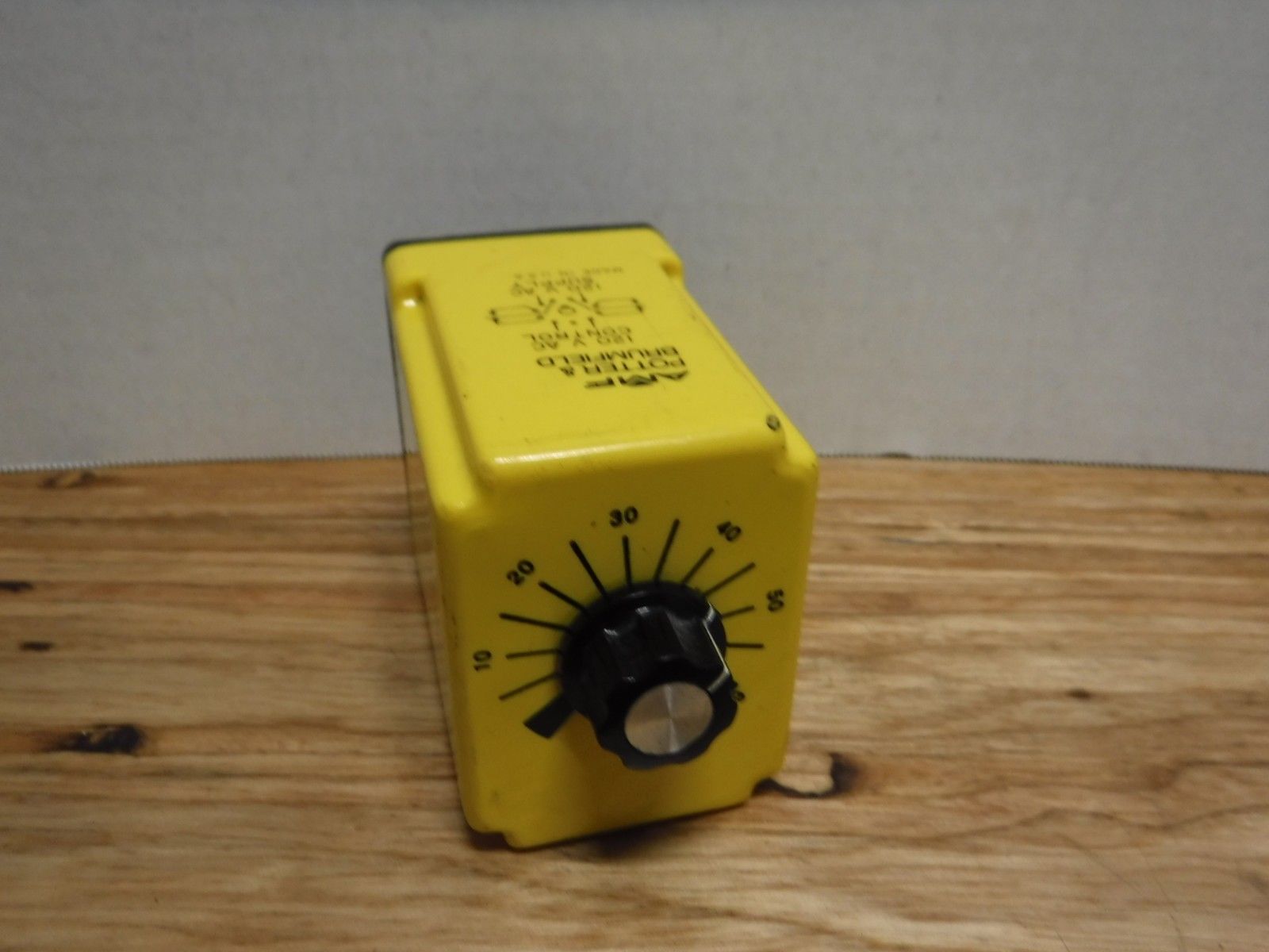

Without seeing the circuit I would say, wire a potter & brumfield 60 second relay into the circuit. When machine goes into free play mode wire it so 60 second timer comes ON. Set timer for 5 seconds to close the key switch. When relay closed key switch machine returns to normal then timer relay turns off until next time it go the free play mode again. Potter & Brumfield relays come in several voltages this picture is only 1 of many that are avalible. This relay is $12 on ebay.
