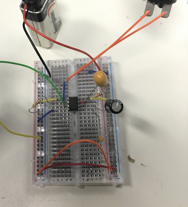

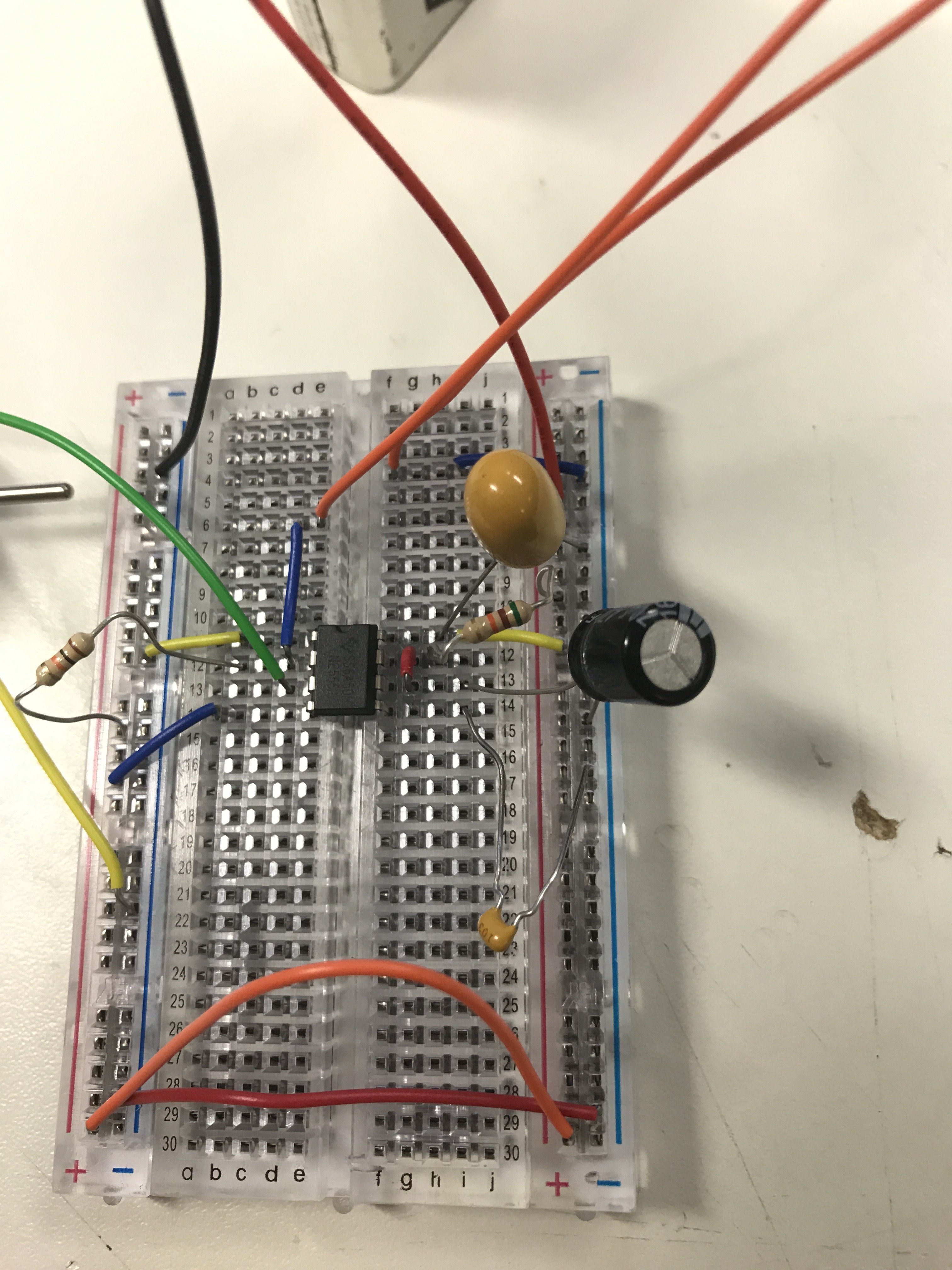

Hi i am a student and currently doing a project and i have very little knowledge about circuits and electronics. So, i would like if someone can help me on this circuitry that i needed to do. First i am required to operate a washing agitator through vibrations using a 12V motor and i have a 555IC , capacitors, resistors, a switch and a 9V battery. I am required to create a "time delay" so that when i press the switch to On the motor it will run and without me pressing the button again to switch it off it will stop on its own after like 25secs. The pictures below is what i have researched on so far and tried connecting it, it is supposed to give a timeout of about 26secs. However after testing it , it is not consistent. Also, when i press my switch to start the motor, it works however when i press again to stop the motor , sometimes it still continues running. So is there any way i can solve the problems? Thank you guys in advance. I do say i am really a beginner in this.

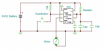

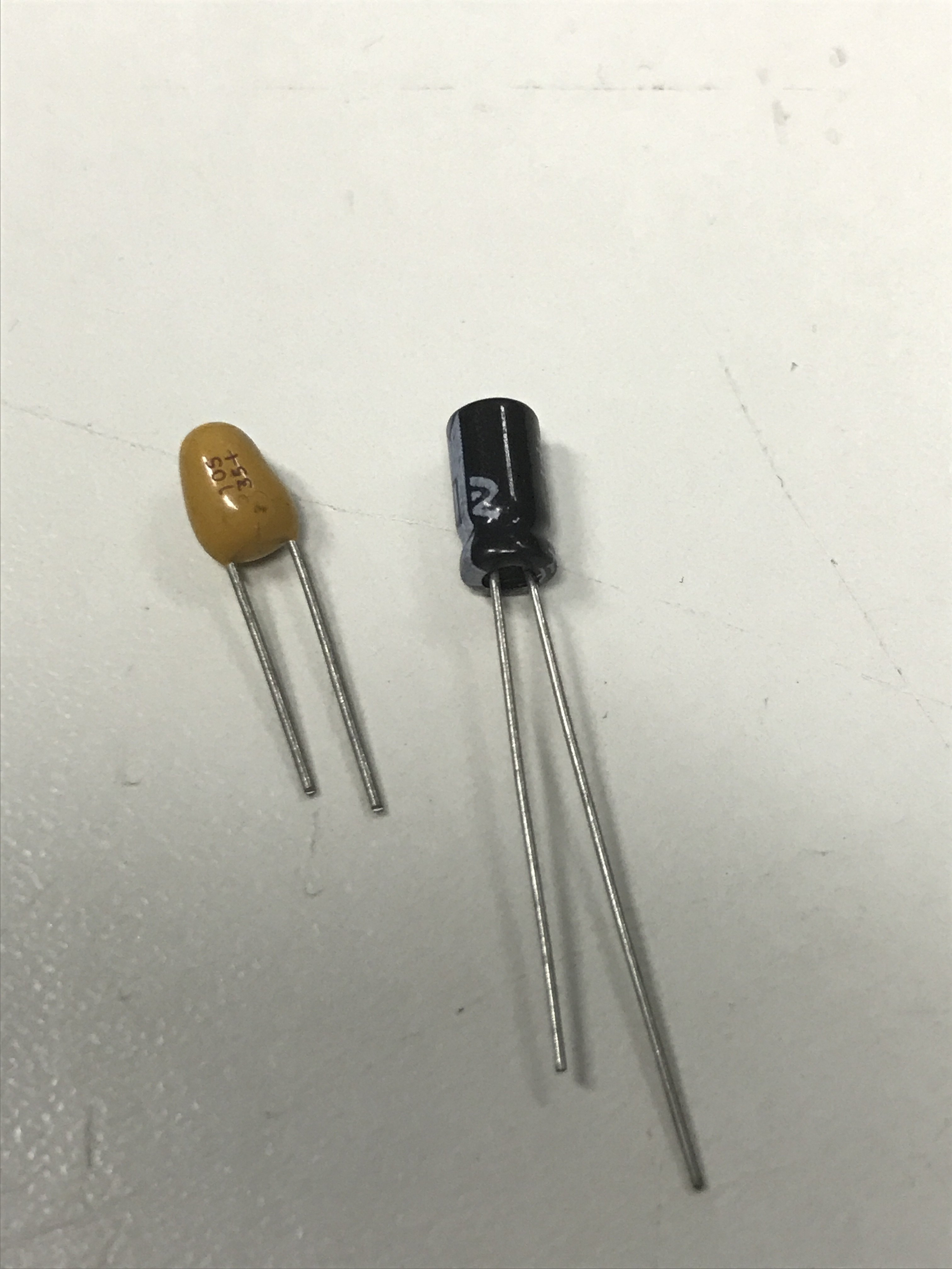

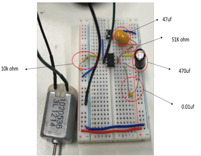

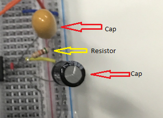

Using the below pic, what are the values of the indicated parts?
Cap(s) will have a number followed by "μF". The Resistor will have colored bands.
Normally, a "One-shot" 555 circuit will have only ONE cap where your circuit has 2 (as shown below).
Also, when "bread boarding" a circuit such as yours, you have to be very careful that each component's leads (wires) are making good connections with the contact(s) of the board. Make sure the polarity symbols, if present, (+ and -) of the caps are attached to the correct bread board terminals.
This is an equivalent schematic of your circuit (values are intentionally absent):

I am using a 10k ohm resistor on the left side and a 51k ohm resistor on the right. As for capacitors the top 1 is 47uf and the bottom one is 0.01uf. This i suppose is supposed to give a time out of around 26secs.

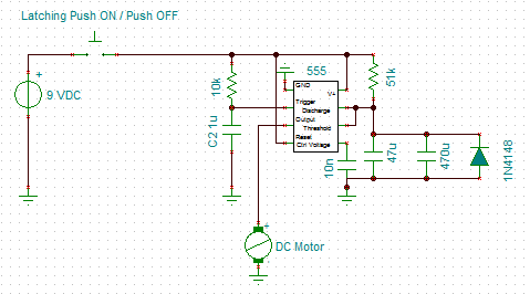

This is a self triggering, 29sec, monostable delay timer circuit. Pressing the push button once "latches" it in the ON position. The timer output will remain on for the time duration set by the 2 caps and the 51k resistor. To restart the timer, press the switch once to turn it off and then again to turn it back on.
If at any time during the ON delay period you wish to terminate the output, just press the switch to turn the timer OFF

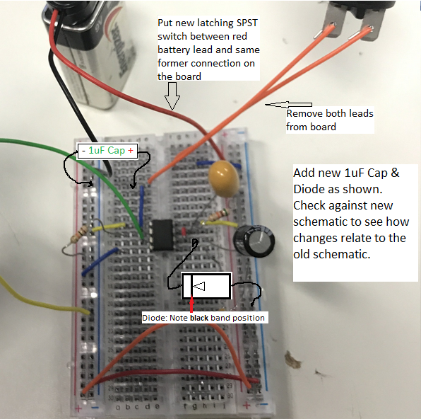

You'll have to find a SPST "Latching Push ON - Push OFF" switch, like this. The added diode (in this case, a 1N4148) is for rapidly bleeding off the 2 caps between power application(s) of the timer. This will maintain the accuracy of the delay timing when re-powered (everything starting as close to zero as possible).
Other than this circuit, there are no 555 latching timer circuits whose output can be toggled between On and OFF with only one SPST switch.

Sorry, but do u mind showing me how to connect it on a bread board? I am still new to electronics and i dont know how to read a schematic diagram properly. Especially the wire pins its confusing. I really do thank you so much , would really appreciate it!

No. The new switch is a "latching" type. What that means is when it is first pressed, it is turned "ON" and it stays ON (is "latched" in a "down", or ON position) until it is pressed a second time, which releases the latch, allowing the button to rise, placing it in the OFF position. And ANY latching SPST switch will suffice. The one I suggested was simply the best, in this case, of the many available.
Working on that now. I'll post it later.

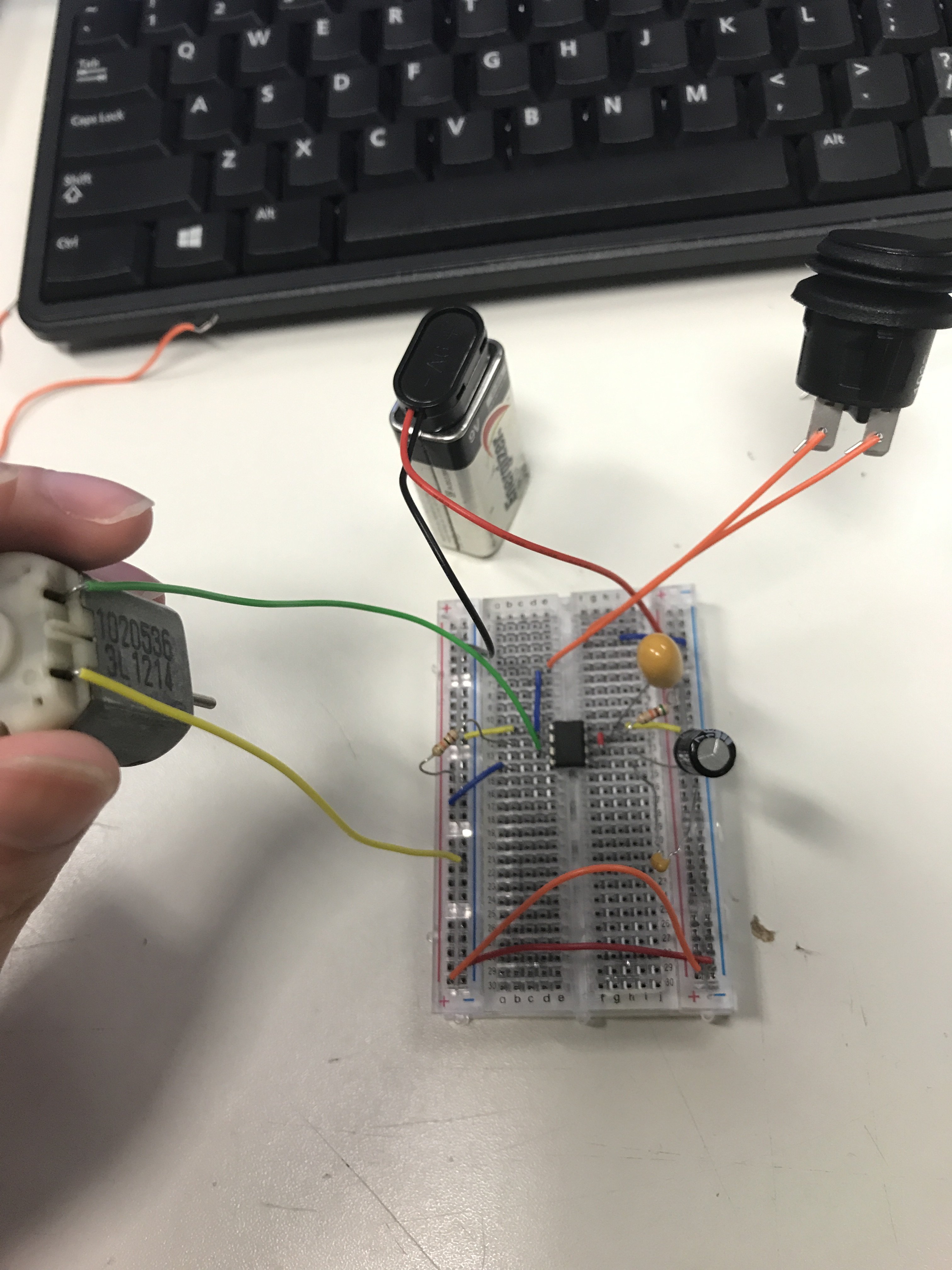

How do i know whether the current switch im using is a SPST switch? my switch currently sounds similar to what u said i think hahah
Thank you so much!!!! really appreciate that u are taking ur time to help me!
Single Pole Single Throw switches have only two connectors.
Latching SPST switches also only have two connections, but the button itself, when pressed down (which often makes a "click" sound with each pressed) will remain in the down position (ON) until pressed again, releasing the latch (again clicking) and returning to the up or OFF position.
Note differences between old:
and NEW

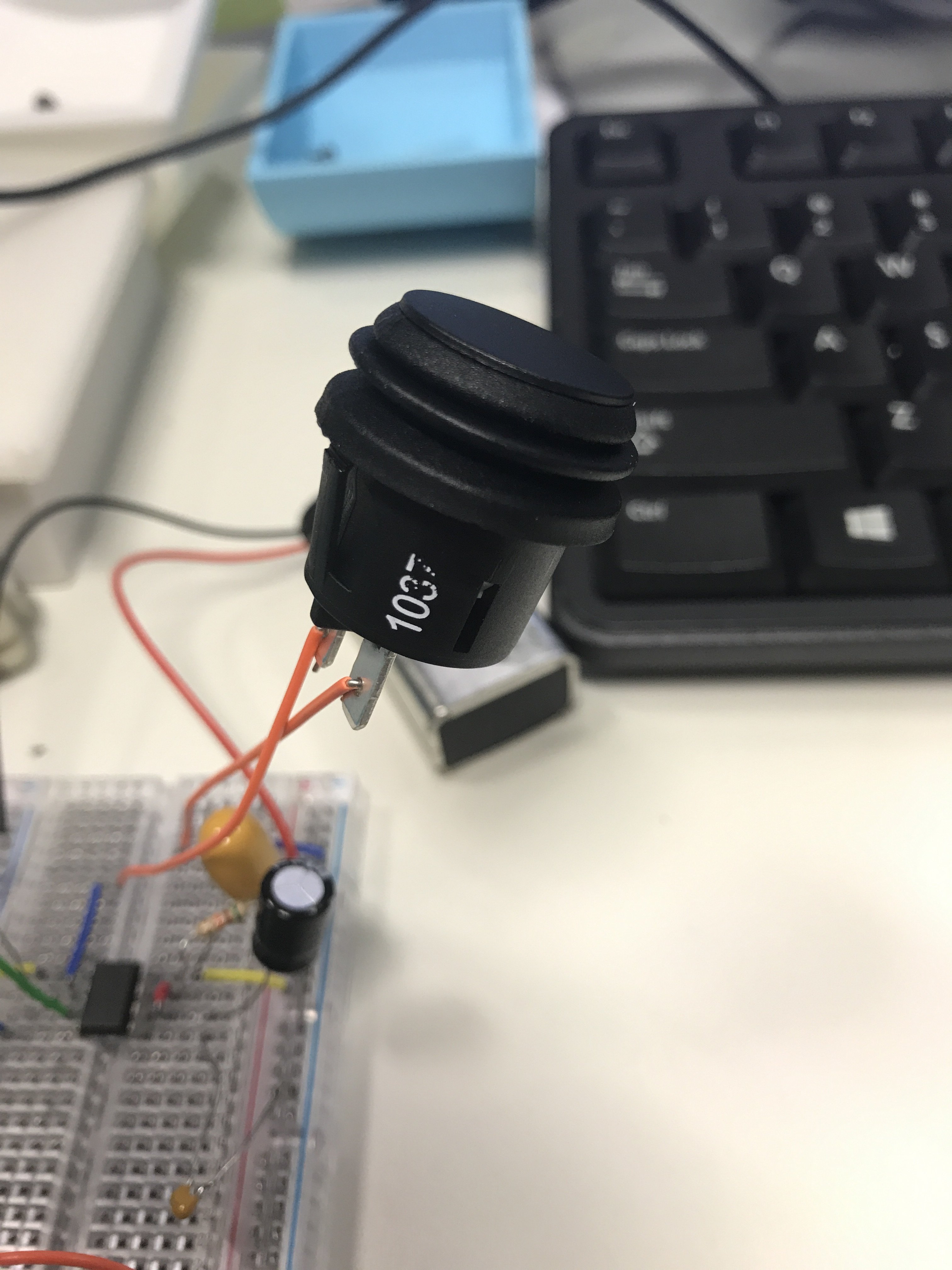

The switch im using does have the click sound and remains in a pressed position when pressed and the goes back up when pressed again.
This is the switch i am using currently.

Sorry but what do u mean by putting the switch between red battery lead and same formal position as the board.
For the 1uf capacitor do i use the 35V or 50V?
Also, just curious if i do not put in the diode in the circuit will it still work? Since the diode helps to gives accuracy of the time delay timing , or will the circuit not work at all? Because i do not have the diode now , however i want to try whether it will still work close to the 29secs at least.

However now after i have added in the extra capacitor i test my circuit and it starts running on its on without me pressing on the switch.
Also, does the leads of the battery like where it is placed matter? currently the black battery lead is on 3 row negative terminal and the red is on row 5 positive terminal.
I do think that some how after connecting the capacitor it does not link to the switch thats why it starts on its on once i plugged in my battery?
