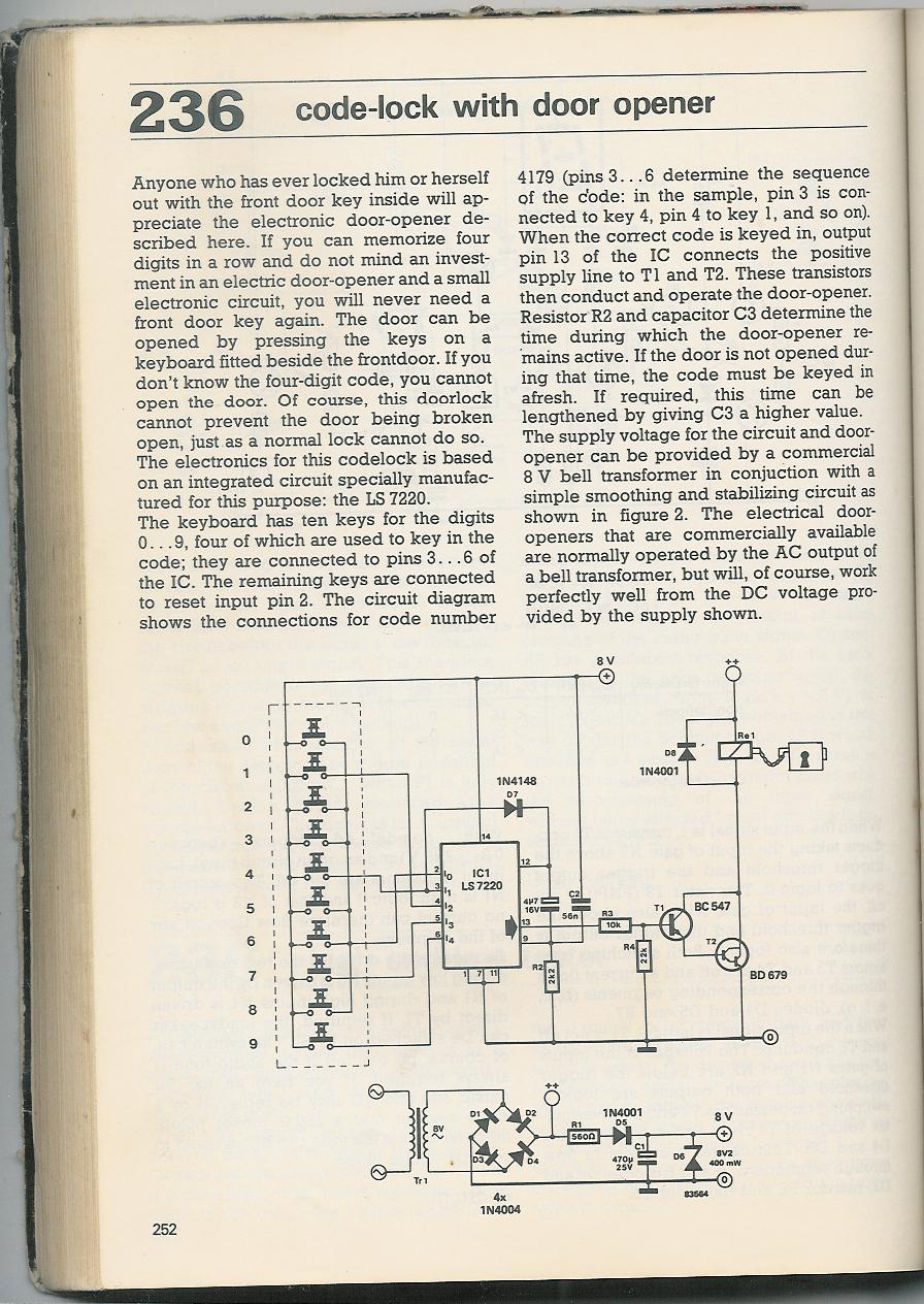

Time d..............elay circuit.
in your diagram, make the capacitors from base to ground and increase 1k. also use a discharging capacitors when you connect so.
see the attached schematic for a code lock, it can be helpful to you for the part of lock
why increase the values? what do you mean by discharging capacitors, im using electrolytics. is this shchemtic relevant for an alarm or an actual lock. im looking for a keypad entry to basicaly disable the alarm.
