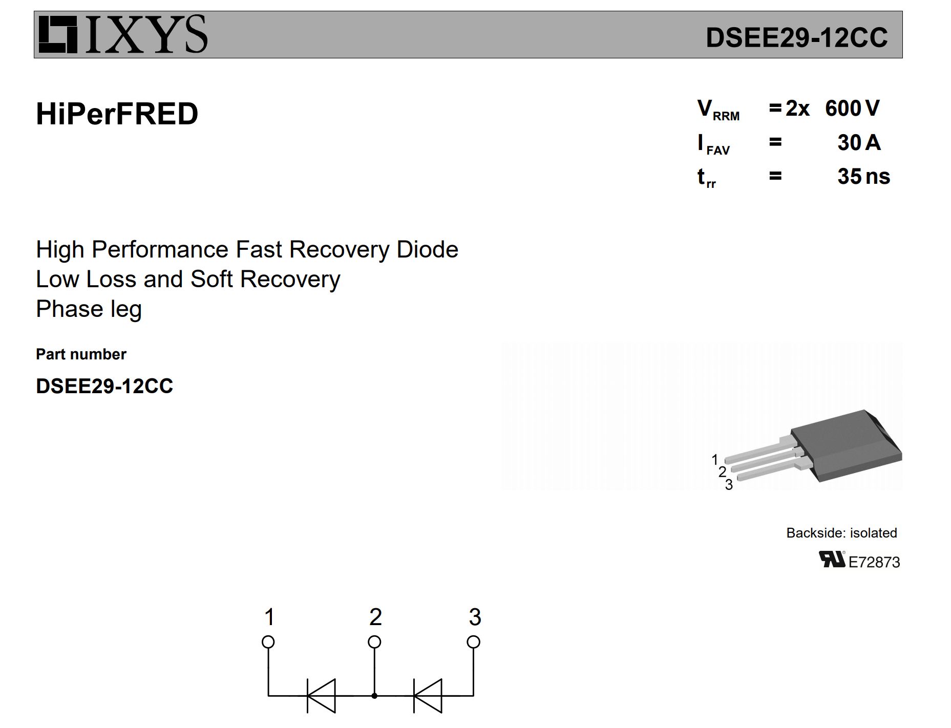

I need to replace some of these - they are failing mechanically (fractured legs) on some kit we have but while I can find the actual parts by number, they don't match the pinouts on the part. I've confirmed with a Fluke meter and a multi component tester that the pinout is the same as that printed on the component but all the parts with this number have a different diode configuration ........

Already been there and done that. I'm measuring the forward voltage drop as 0.2-0.3v with low currents and 0.5v @ 5A (my bench supply won't go more than that) - the higher voltage diodes have a much higher forward voltage drop.
I've also got to stick to TO220 size packages as these are in a space constrained enclosure (three are mounted side by side on each side).
It is more the fact that nothing available with this part number actually matches the pinout of this unit that is annoying me. You go to the original manufacturers website, dig out their datasheet and the diodes are in a common cathode configuration.

I've found the ixys catalog that had that part in it; it seems to be the only dual schottky they have ever made with that configuration in a TO220 or similar package.
Looking at their current products in their web site, it appears they may have dropped schottky rectifiers completely, as there are no low voltage device listed, that I can see.

If you have space, you can combine the two middle AC (~) pins and use this...
DC (+) would be your anode and DC(-) would be the cathode and the two AC(~) can be coupled and used as the center node to replace your device.
The forward voltage is higher but I'm not sure you measured a working or a defective diode array.

Hmm nice find but no cigar .......
"Showing results for DSB20C60PN
Instead of DSB10P60PN"
The DSB20 has the wrong diode configuration (again !) - the DSB10 is correct but obsolete.
