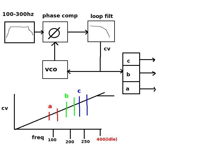

To distinguish between 3 frequencies you'd have to compare the output from all 3 filters and choose the one with the highest amplitude. Even then, you wouldn't know for sure if the signal was exactly in the passband of one filter without also monitoring the amplitude of the unfiltered signal. Not to mention what would happen with a non-sinusoidal input.
Typically a PLL is used, instead of BPFs, for tone signaling decoding.

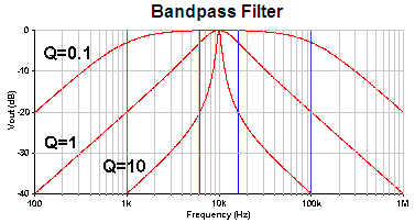

Your bandpass filter have a low Q of about 2.9. The Q is the ratio of the center frequency to the -3db bandwidth.
Look at the curves of a single bandpass filter and you will see that a 200Hz filter with a Q of 2.9 will pass 100Hz at about -12dB which is about 1/4th its original level. It will also pass 250Hz at about 1/4th its original level.
Make the Q higher for a narrower bandpass or connect two filters in series for a narrowed bandpass.

If you want to be able to treat the outputs of the three filters as three independent signalling channels then you will need to make sure that they have adequate attenuation at the other frequencies. Looking at the numbers, the tightest spec will probably me making the 250Hz filter reject the 200Hz component. You need to make the response to the highest level 200Hz component be low enough so as not to interfere with your 250Hz level measurement.
You could do this with active filters, although they will be narrow band and will probably require tuning. No major dramas though.
You could make a simple tuned receiver for each tone - then you would use baseband filtering to reject the other tones.
If you are good at DSP you could do a single chip solution...
Guess you can't use a standard DTMF tones? There are single chip solutions then.
another way would be to use a single PLL circuit and window comparators fed by the VCO control voltage. all he would have to do is set the 1st comparator to trigger when the CV is locking the VCO to a 100hz signal, the second for 200hz and the 3rd for 250hz. if the pll's free-run frequency was outside of the activation band (400hz for instance) then the comparators would all be off when the VCO is idling. for a low frequency pll, the lock ranges would be narrow enough that false triggering could be eliminated with a simple time delay and a NAND gate. if the comparator is active for too short of a time, the trigger outputs remain inactive. that way, random trigger events from noise, or the VCO CV passing through the windows of the other comparators (such as the CV dropping from the idling range through the 250 and 200 ranges as the PLL accquires a lock on the 100hz signal) will not false trigger any of the outputs.
something like this...... the "a" output is only high while the CV is within the range between the red lines, the "b" output is only high while the CV is within the range between the green lines, and the "c" output is only high while the CV is between the blue lines.
