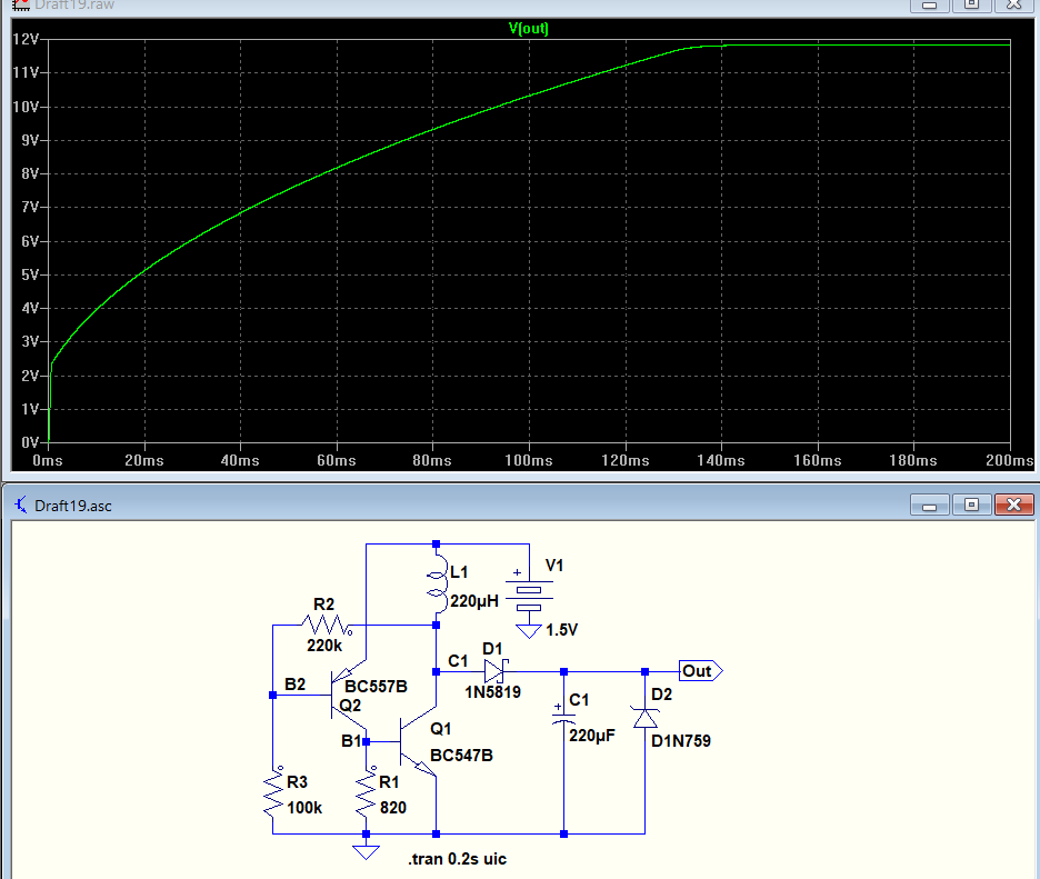

The very simple circuit that the boost converter voltage from 1.5 to 12 does not work in the Proteus software...why????

I wanted to simulate the simple circuit that I executed from the Imic site, so that I can make changes later on, the Proteus emulator file does not work.

Circuit doesn't make sense..
It's a Joule Thief type oscillator to generate a DC output from a single alkaline cell.
Works in LTspice (below):
Spice normally does a DC bias calculation before it does the transient response, which causes the oscillator circuit to then end up in a quasi-stable steady DC state with no oscillations.
You need to prevent that initial bias calculation by using the uic (Use Initial Conditions) command, or whatever command stops that calculation in Proteus.
That's a bad design - a large proportion of the input power will be going through Q2 collector - Q1 base & effectively shorting the source, rather than doing anything useful.
It should have a series resistor in the Q1 base circuit, possibly with a small capacitor across it to speed up switching.

Well, I sent the file to the engineer, you can edit the Q1 base which is connected to the resistor
I have proteus.
Post the proteus project file, not a .rar file. Zip up the project file first if necessary.
If you do that, I'll take a look.
