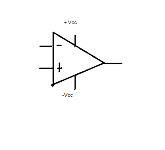

I read different material about opamps and in some I found +ve rail supply on the same side of the non-inverting input & -ve rail supply on the inverting input side. On some other places, a came accross a different scenario where I found +ve rail supply on the inverting input side and -ve rail supply on the noninverting input side.
What I want to know is which representation is the correct one. If the both were correct, then does it mean that changing the position of rail supply has no effect on the overall functionality of the opamp?
It's not the position of the rails with respect to the input that matters, it's the connection of the rails to the opamp power pins. The polarity of the rail must always match the polarity of the power pin it's connected to.

He's talking about how they are drawn, not the physical location in the chip.
C. Jung always has the +V at the top and the inverting input above the non-inverting one.
Both are valid.
Schematic drawing varies to keep things looking as clean and simple as possible. I prefer to keep the inverting input on the "bottom" of the symbol but will swap the convention in a heartbeat if the seem looks cleaner. Autorouting drawing programs are sometimes locked into certain conventions and will rat's-nest the wiring to get around it.
