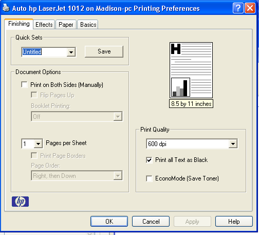

I have the same printer and this gives me the most toner setting it to print
text black
I guess equal and heavy toner distribution is a matter of the printer driver software.
The same issues come up when printing on transparencies for photo films. Many laser printers cut back on toner automatically if there are large fully black areas to print. (The larger the area the more faint will be the print)
My Epson EQL5700 had the option to select toner saving or full toner all over a print.
Using the full toner option the print was deep black over the entire layout.
I'm now using a (cheaper) Fuji-Xerox Docuprint 203A which doesn't offer that option (always prints full toner) and it prints a full DIN-A4 page fully black without any change in toner density. (checked on a light table with a transpararency)
Run a test and check what has to be changed. I wouldn't change toner cartrigdes for a satisfying print result. I'd consider that piece of equipment junk!
