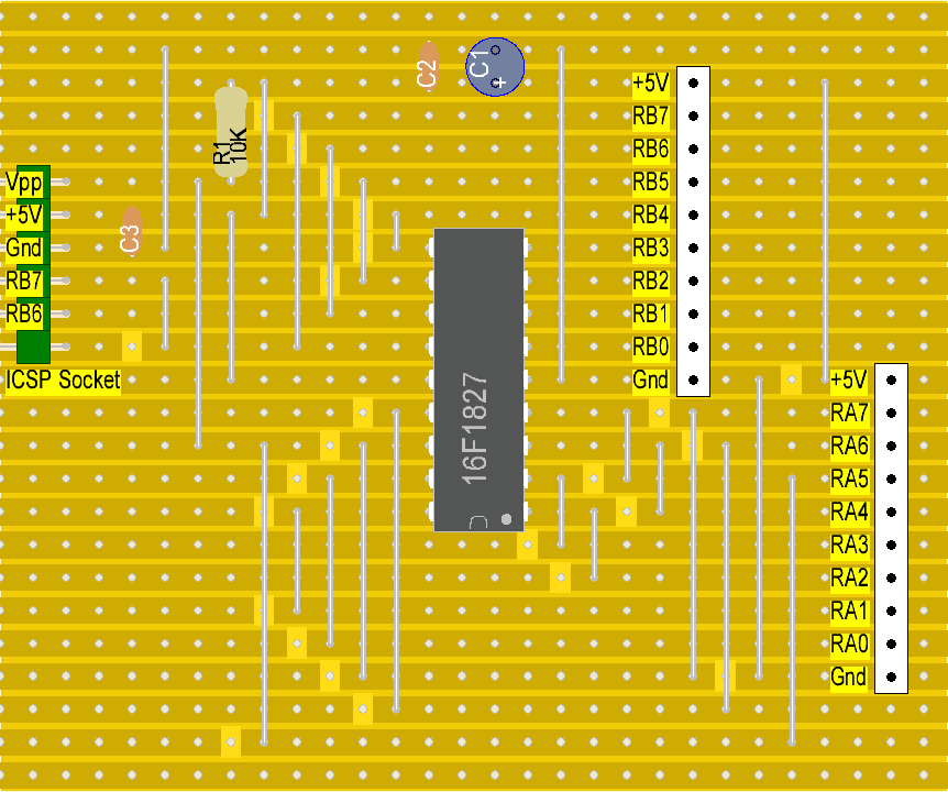

Here's a Pickit2/3 veroboard layout for an 18 pin PIC, the Pickit simply plugs directly on the right angle pins at the left.
I'd suggest you use the 16F1287 as in the diagram, it's my PIC of choice now, as an enhanced 14 bit device (and is nice and cheap).

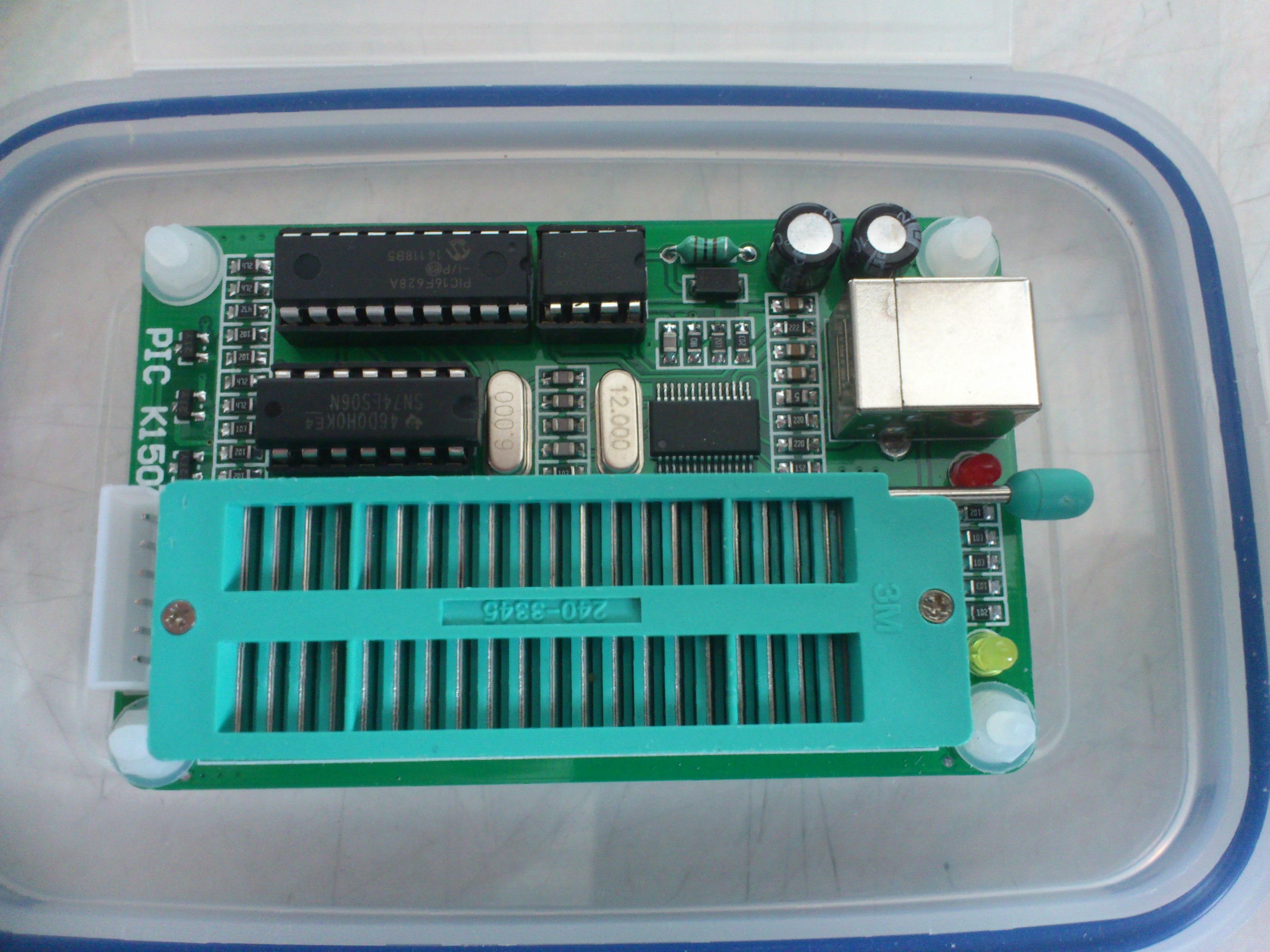

Programmer .. ..
See attached pic ...ture :)
I built some timers last year for my son using a 16f628a in a kit that came with .hex so all I had to do was load it, so I bought this K150. Has not given me any problems so far ..

Is that programmer OK ?
Yes! For the midrange... Trouble is I have migrated to the enhanced range...
The pic16f887 has replaced the pic16f877... Much cheaper ( I buy many )
The pic18f45k20 has replaced the pic18f4520 ( My main processor )
The pic12f1840 is my new pic12f675.....
All these newer chips are far superior in every respect..
I have recently used pic16f1825 / 8 / 9... These are awesome... The pickit2 has taken a bit of a back seat as the pickit3 is needed for the majority of new chips..
All the pic32's need the pickit3.
BUT!!!! As you are starting out and will probably use the pic16f628a... Good choice..

Yes, I can see that is all fair comment. At the time when I bought that K150 I was going to program 8 or 10 16f628a's and then not do anything more .. I didn't realise then that electronics would become such a fascinating hobby ... and as you say, it will do to start the journey.
If I get to advance and need to update the programmer you won't be able to silence my delight !
