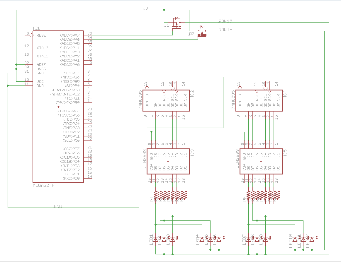

Since this circuit is using the HC595 as a high side driver it won't be easy to replace with something more powerful. The Fairchild data sheet says 35mA per I/O pin but there's a 70mA limit for DC on each power/ground pin.
Let's do some research - if we turn the LEDs around then we could use p-channel MOSFETs on the 16 rows and a small transistor on each of the 125 columns.

The limit for each HC595 is a total of 70mA. 15mA*8 is already beyond this limit, but I was accepting the same risks as the original designer did.
If you turn the LEDs around and use a high side P-MOSFET for the rows, you can use a darlington package like the ULN2803 for the columns. The main advantage is one package replaces 8 transistors and 8 base resistors.
Can you draw a schematic (even on paint), to tell me how i can connect the P-MOSFET the ULN2803, and one or two LED for example?

Sorry my reply took so long, here it is. Note that pin 10 of the '2803 isn't connected. (It's for diodes if it was used as a relay driver).
There are many other parts that can be used as drivers. The main advantage of the 2803 is the single package for 8 buffers. If you have other cheap buffers, we can look at them. Each section of the '2803 can be replaced by a 2N3904, 2N2222, or BC546-7-8-9-50, with a base resistor.

Thank you for the schematic! :D
Can you tell me what's the program that you've made that schematic? And if you can send me the schematic file it would be great, i want to write the rest of the schematic with all the LED and all the other circuits.

Can you draw a simple schematic on how to connect the correct pins to the LED? I've almost completed the previous schematic that you've sent me, but i agree that it will be required a lot of soldering (or at least a much bigger PCB).
The essence is you connect the signals Drain0...Drain7 to the LEDs where the signals QA....QH were connected before we added the drivers. SEROUT is connected where QH' (QH bar) was connected.
I'll have to wait till tomorrow to draw a schematic.It looks like the tpic6595 isn't in the Eagle library so that will need to be done first. I would begin with a similar part ('HC595???) and rearrange as required.

So far, the LED array looks OK. It will just be a matter of finding room on the page for the rest of them (128 done, 2432 more). You have to attach an LED from each row to each column. That means 16 cathodes on IC3 pin 111, with each anode going to a different MOSFET.
I should revise the schematic and post a modified version shortly.
160 columns each use 25mA when its row is activated. If you want all the LEDs in one row to be on, that's 4 amperes. But due to the multiplexing, only one row is on at a time, so they don't add together.
If the distance between them (centers) is 0.25", your board is 40 inches long. Myself, I would divide it into several smaller boards that I would place edge to edge.
OK, I have to stop for the night, but here's some of what I talked about. I added more rows to columns 1-8 and put new LEDs on columns 9-16. I have not finished them because this is only supposed to be an example. You get to fill it in until you have all 20 of the 'HC595s hooked up.
