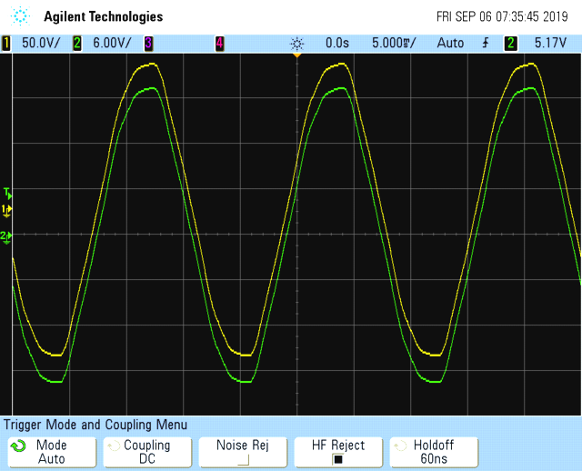

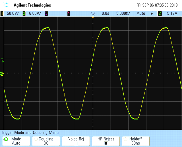

Here is what the grid waveform looks like where I am. The first image shows the waveform as seen by a 100 MHz isolated differential probe (yellow), and through a filament transformer (green). The two waveforms are offset so it's apparent that there are actually two waveforms:
In this second image, the two waveforms are superimposed so the fidelity of the filament transformer provided waveform can be easily compared to the differential probe waveform:

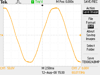

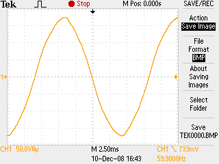

Some time ago I measured some grid waveforms in the Puget Sound area. Here, just to show the variability, are some of my captures:

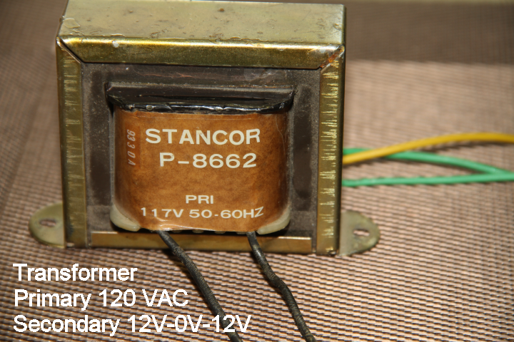

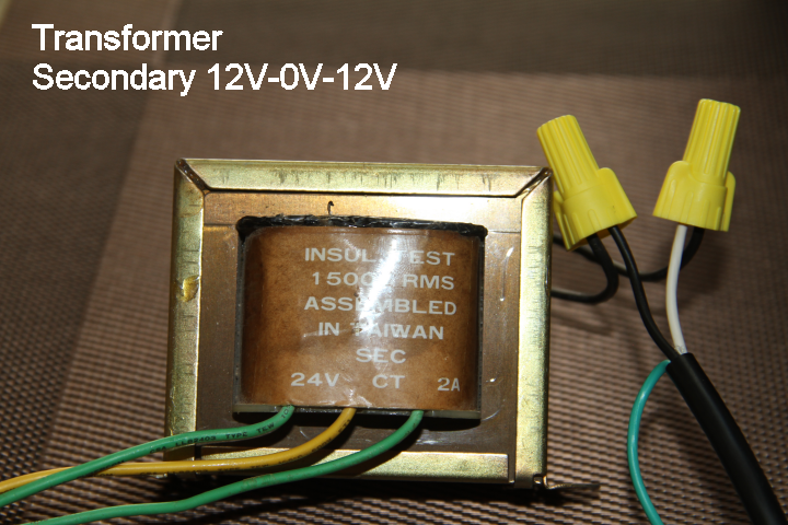

Well then if he has a transformer he can use it. Here are a few examples of using a transformer:
This transformer has a CT (Center Tapped) secondary:

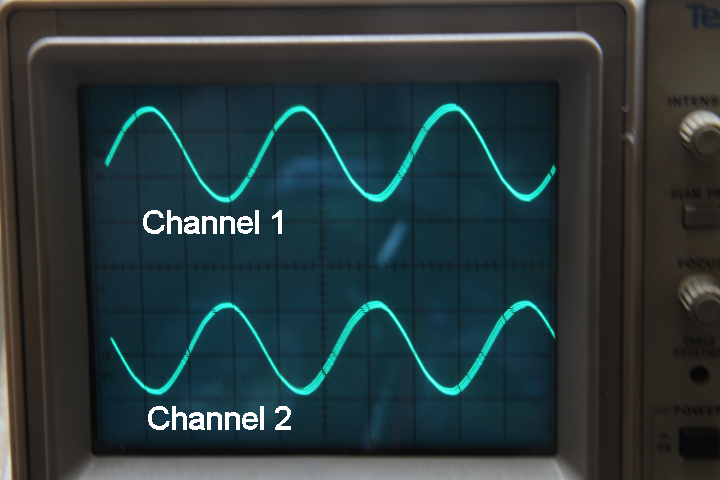

Looking at both secondaries with respect to the CT is a good representation of how power is delivered to a US residence. The two wave forms are 180 degrees apart. While a reduced voltage if we were to algebraically add both channels the sum would be about zero so we can invert channel 2. Doing so will yield the following:
Now we let the scope add both vertical channels to present a single trace.
This would be the equivalent of what residential mains would look like. About the only way this can be done is using a transformer or an expensive differential scope probe rated for AC mains.

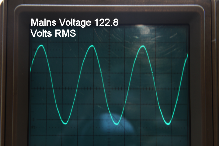

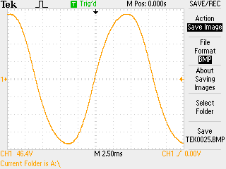

This image reflects house mains as passed through a UPS (Uninteruptable Power Supply.

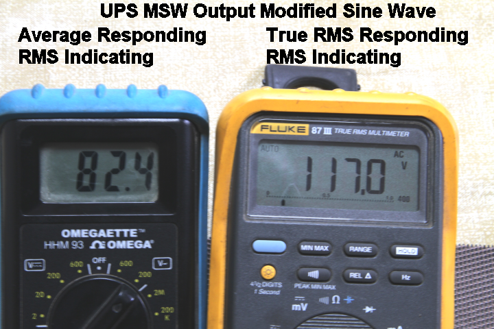

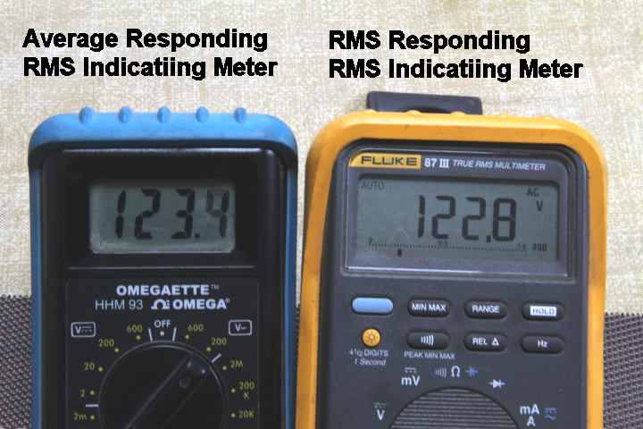

Here is that same signal as metered by an inexpensive average responding RMS indicating DMM and a better quality true RMS responding RMS indicating DMM.
Both meters are reading the above sine wave. They are reading relatively close or within 1% anyway. The actual voltage is 122.8 so my money is on the better meter.

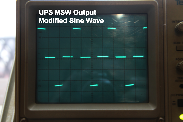

AC mains power is removed and the UPS kicks in resulting in a 117 VAC MSW.
Not visible on the scope is jitter in that the MSW inverter is not a stable exact 60 Hz, but obviously the signal is a long way from a nice sine wave. This is what a MSW looks like.
Now lets look at the same two meters.
So the inverter voltage while being 117 VAC RMS only reads correctly on the better quality meter. What both meters tell us when compared is the signal being measured while 117 VAC about 60 Hz it is not a very good simne wave.

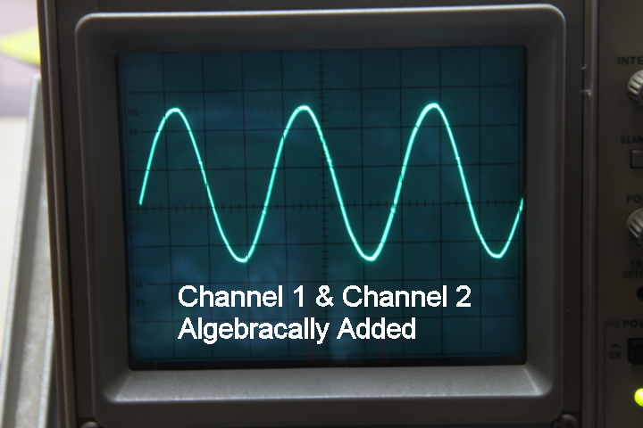

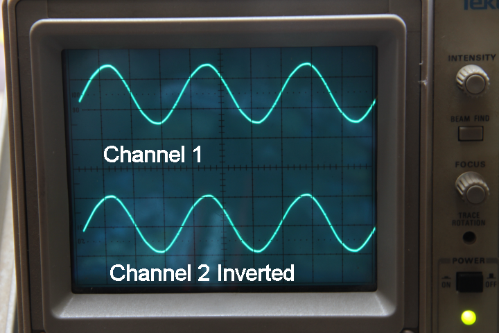

What about this? My Oscilloscope is a 4 channel unit......
differential measurement is the safest way to measure line voltages (it's also good for looking at SMPS waveforms on the line side)

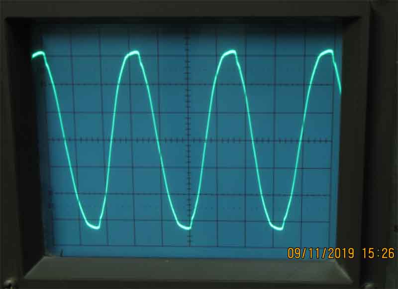

Ok,
Beginning to attempt some photos of the waveform with my new camera.
I'm still learning to use the Manual settings and Macro focus but I'm getting there.
ReloadRon has superb photos....that's my goal.
Not perfect but MUCH better......
House AC
Once I get all the settings right I'll do the NON Inverter generator. It still has a sinusoidal wave form, but nowhere near
as nice as the House AC or the Inverter Generators. Most of all, I'm just having fun with it all.

It works but …. it can really trick you
once you get the two channels nulled, it's not so bad... it's easier in the US because it's only 120V. of course the better the scope's input stages, the better. i might try it on 220V if it was a Tektronix, but not with a B&K or a Sencore.

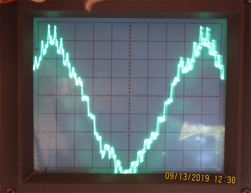

So here's a few (not so good, had a hard time with these) photos of the output from my only NON inverter generator.
Really ugly waveform as you can see.
Not sure if this is what would be called a "modified sine wave" or just a noisy sine wave? I've seen Inverters that make 90 degree block modified sine waveforms. So I think this is slightly better than that?
This is all I was really looking for as was quite expected.
The waveforms from ALL the Inverter generators are PERFECT sinusoidal waveforms. Better than the house AC
Only caveat, I haven't tried them under load yet....but I will.
Waveform from Coleman PowerMate 6250 NON Inverter Generator
An uneducated WAG on this waveform would be that the rotor and stator have less magnets and coils than better generators might have?

I have been examining the waveform displayed above, my best guess is that there are vot many low order harmonics (ie 120, 180, 240 Hz), but the wrinkles are due to frequency components at about 720 Hz.
Very interesting Jim.
I wonder if there's a way to add a filter of sorts to suppress those 720 Hz spikes?
Would larger capacitors help?
