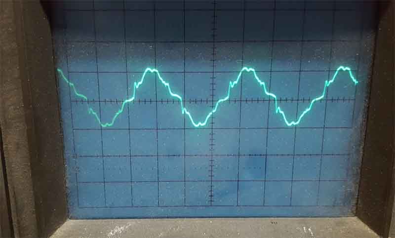

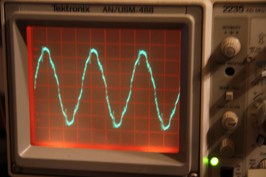

Here is the result.
A few notes.
1). I attempted to check the house AC first.
2). This connection was to a multi outlet (cheap) adapter (Not directly to a home outlet)
3). The probes did not have to be unsheathed....this signal was generated when the probe was placed within 1 mm of the hot or neutral.
4). The probes were set to 10X

Placing the probe in close proximity to the AC source is not good enough. The probe needs to be connected directly to the source. You can use either method suggested as to using a single or both channels. You can get the same results by just placing a finger tip on the probe tip and increasing the vertical gain of the scope. You don't mention the scope's time base settings or the vertical gain setting but what you see pretty much looks like general 60 Hz noise.

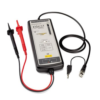

The 1mm air gap makes a fractional pF capacitor. So you are ac coupled. It is likely that high frequencies come through stronger than low 50/60hz frequencies. It is hard to know from here, but likely the high frequency noise you see on the 60hz is not as strong as it appears.
I have some 100:1 probes that are good for 1500 volts.
If money was not a problem:
120155
There are a number of diff probes made for measuring signals like yours.

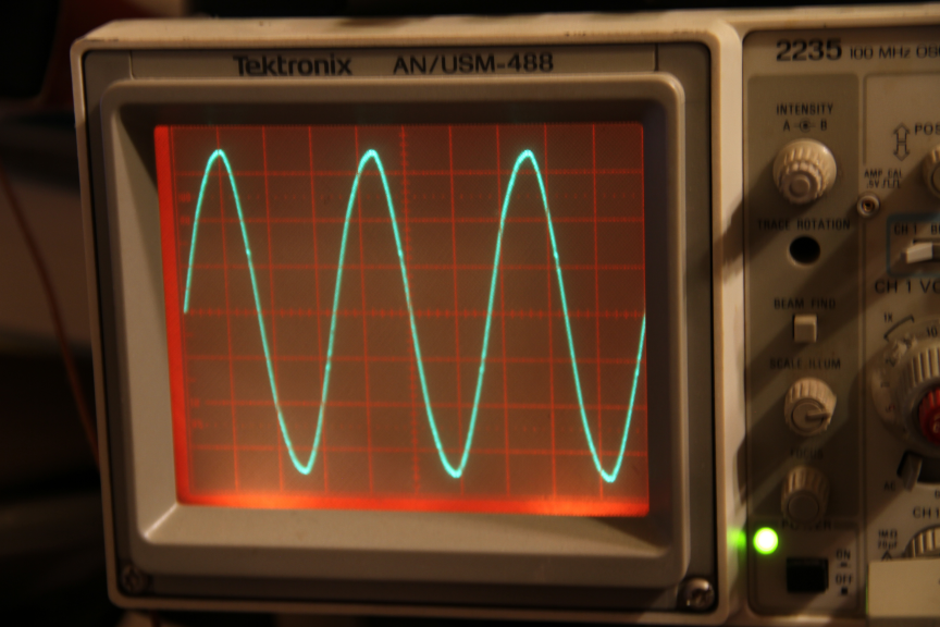

Here are a few examples of using a scope, single channel and looking at AC mains: 60 Hz Sine Wave
120158
V/Div 50 (Using 10:1 Probe)
Time Base 5.0 mSec/Div
Measured True RMS voltage was 123 VAC
Example of placing probe tip in close proximity to AC Hot but not connected:
120159
V/Div 2 (Using 10:1 Probe)
Time Base 50 mSec/Div
Just a noisy garbage signal and not a true representation or actual power quality.

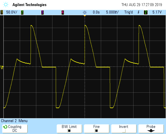

Ylli is right on about the use of a filament transformer, and Reloadron is overly pessimistic.
If a typical filament transformer is used with no load other than a 10x scope probe on the secondary, the frequency response is more than adequate. When there is a resistor load on the secondary the leakage inductance forms an LR low pass filter which rolls off the response (just like an RC low pass would).

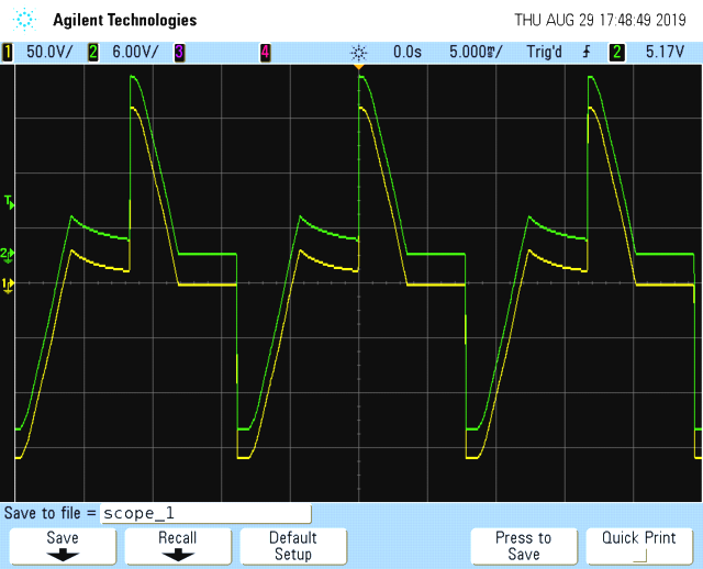

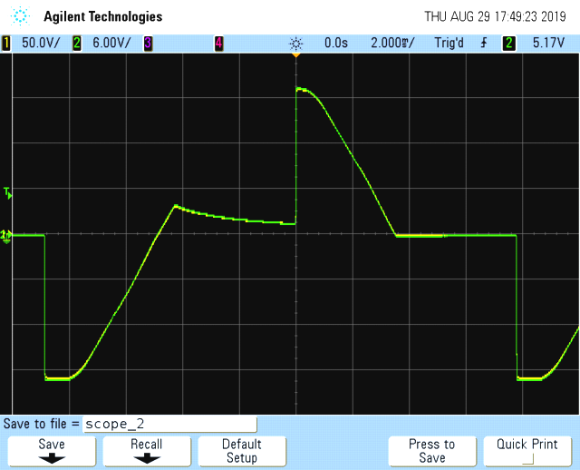

Here are some scope captures showing just how good a filament transformer can be in this situation. I used an ordinary dimmer with an incandescent light bulb to create a distorted grid waveform. The primary of a filament transformer was also connected in parallel with the light bulb. A 100 MHz bandwidth isolated differential probe like the one ronsimpson showed in post #12 was connected to the light bulb/filament transformer primary, and that signal is shown as the yellow trace on the scope. The waveform is somewhat asymmetrical, apparently the fault of the triac in the dimmer:
Here is the output of the filament transformer shown as the green trace. I've offset the green trace to better show each waveform separately:
Here I've increased the sweep speed and removed the offset. The two waveforms are almost perfectly superimposed now--they appear to be essentially identical.

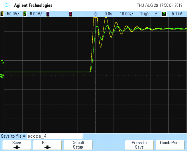

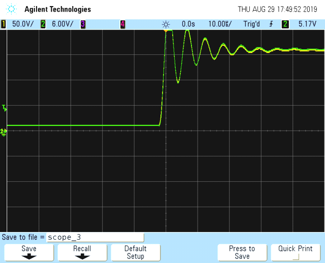

Here i've increased the sweep speed even more to zoom in on the fast rising portion of the waveforms. Again, they're essentially identical:
Now, to show the effect of a load on the secondary creating an LR low pass, I've connected a 100 ohm resistor to the secondary. Notice how the rise time of the green trace is now slower. The bandwidth of the transformer has been reduced enough to cause the secondary waveform (green) to not be essentially identical to the waveform from the isolated differential probe:
I used the FFT function of the scope to look at the harmonics of the yellow (wide band) trace, and compare them to the harmonics of the green (filament transformer) trace. They are essentially identical out to the 40th harmonic as displayed by the FFT, and probably even higher.
The lesson here is that a filament transformer is more than good enough to accurately examine the grid waveform. I did this test on 5 different filament transformers, all less than 50 VA, with the same result. It's unlikely that there will ever be distortions with significant harmonic components beyond several kHz on a typical grid (or generator) waveform, and an unloaded filament transformer can handle that.
I would hope that it goes without saying that if there is noise with components at high audio frequencies and above, this technique won't accurately show them. This method is mainly to see gross deviations from a 50/60 Hz sine waveform.
