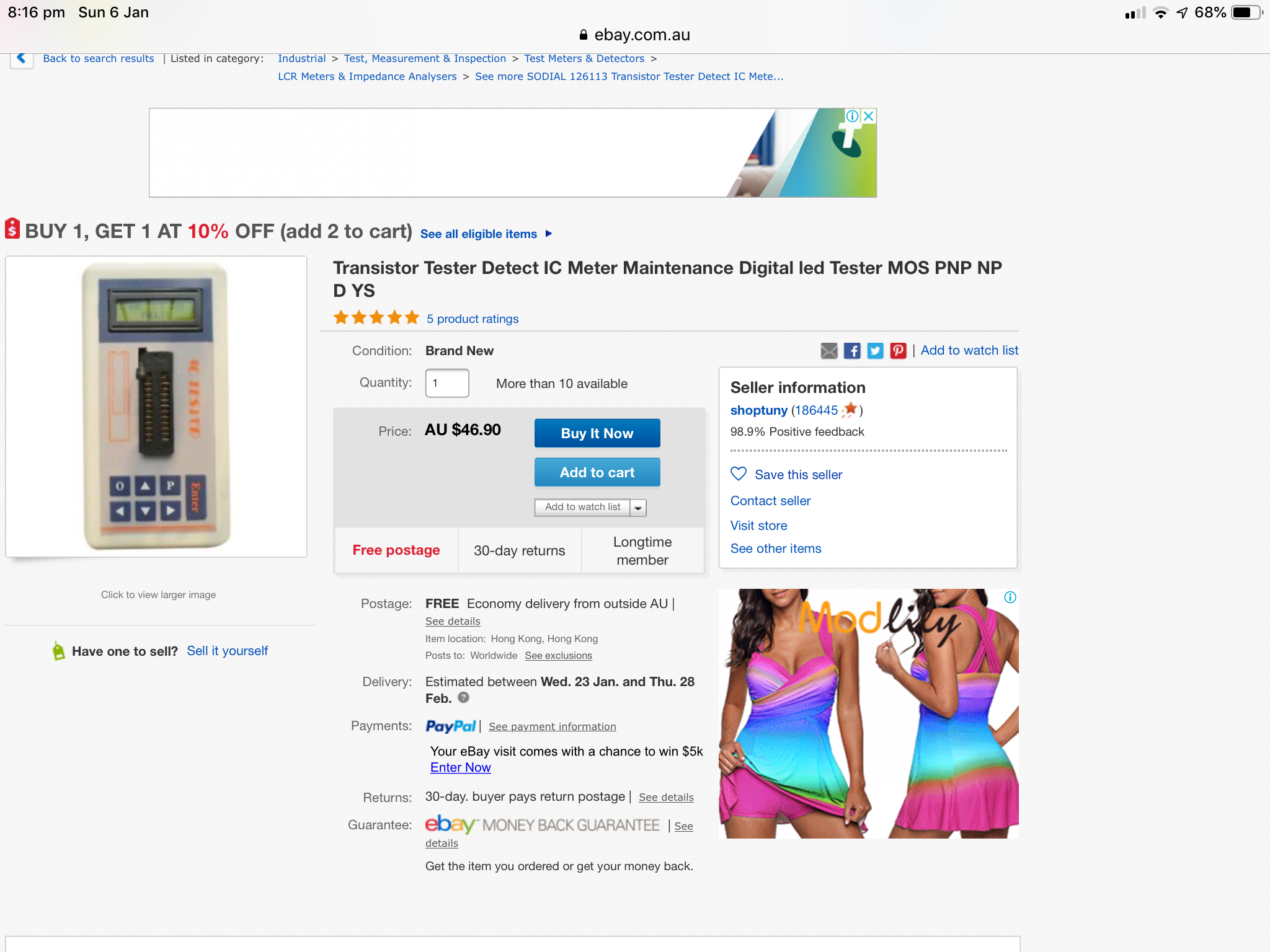

Would one of the IC testers do the job of determine wether the nan gate is faulty.
Testing 14 pin CD4093BCN.
What else can this device measure.
