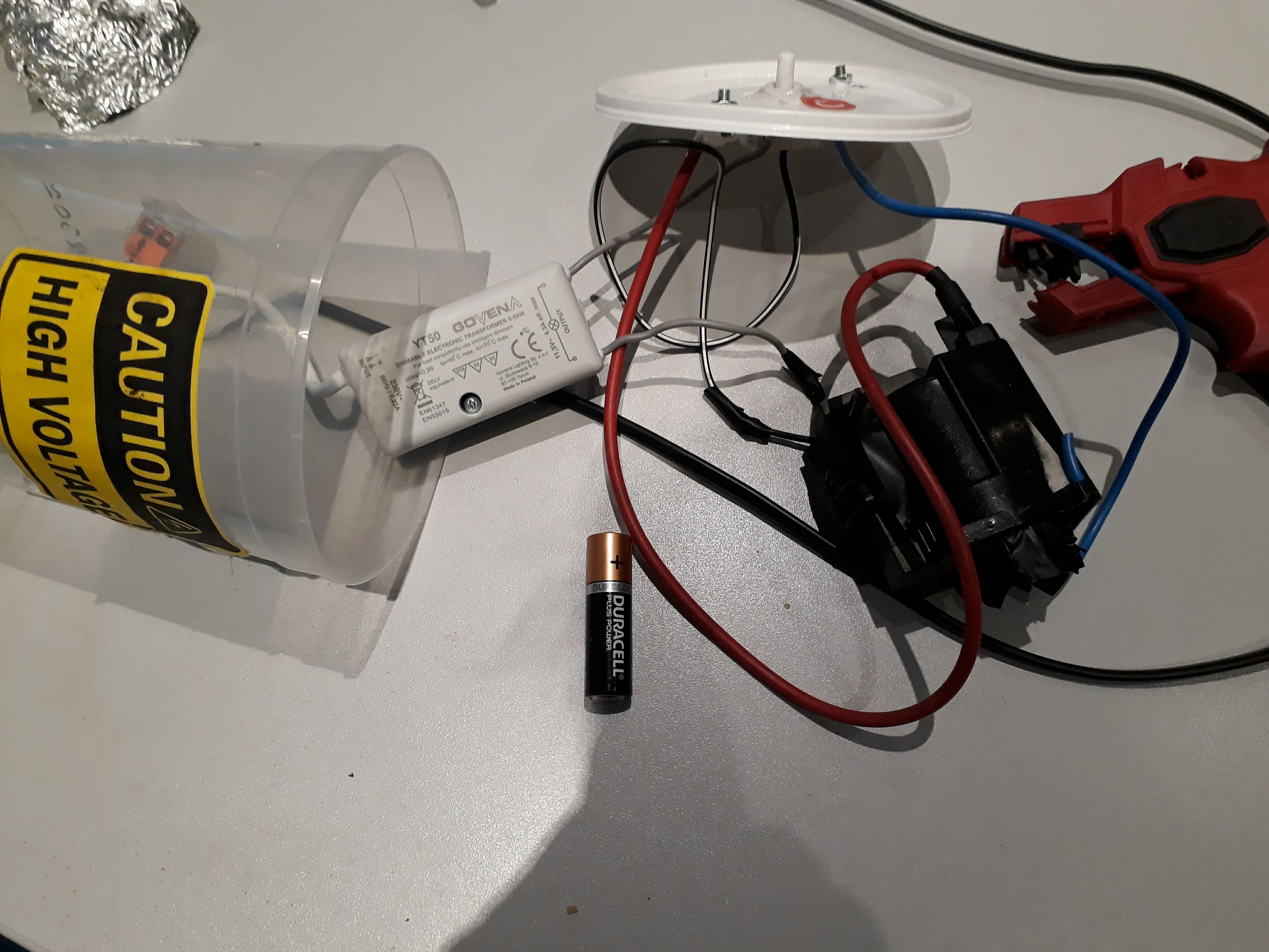

Tesla coil problems.
Hello, my name is Ruben i'm 16 and an electronics enthusiast.
I'm actually dutch so don't mind my bad grammar.
So, i have recently tried to create my first tesla coil.
But the results are verry disapointing; (neon lightbulb barely lights up when held against the coil)
and i am kind of lost as to how i can optimise the capacity of the tesla coil.
And since i do not have an adult with the knowledge to help me in my proximity i have decided to ask the o so great internet for help.
Anyways i will leave the information i can provide below with some photos. any help would be greatly appreciated.

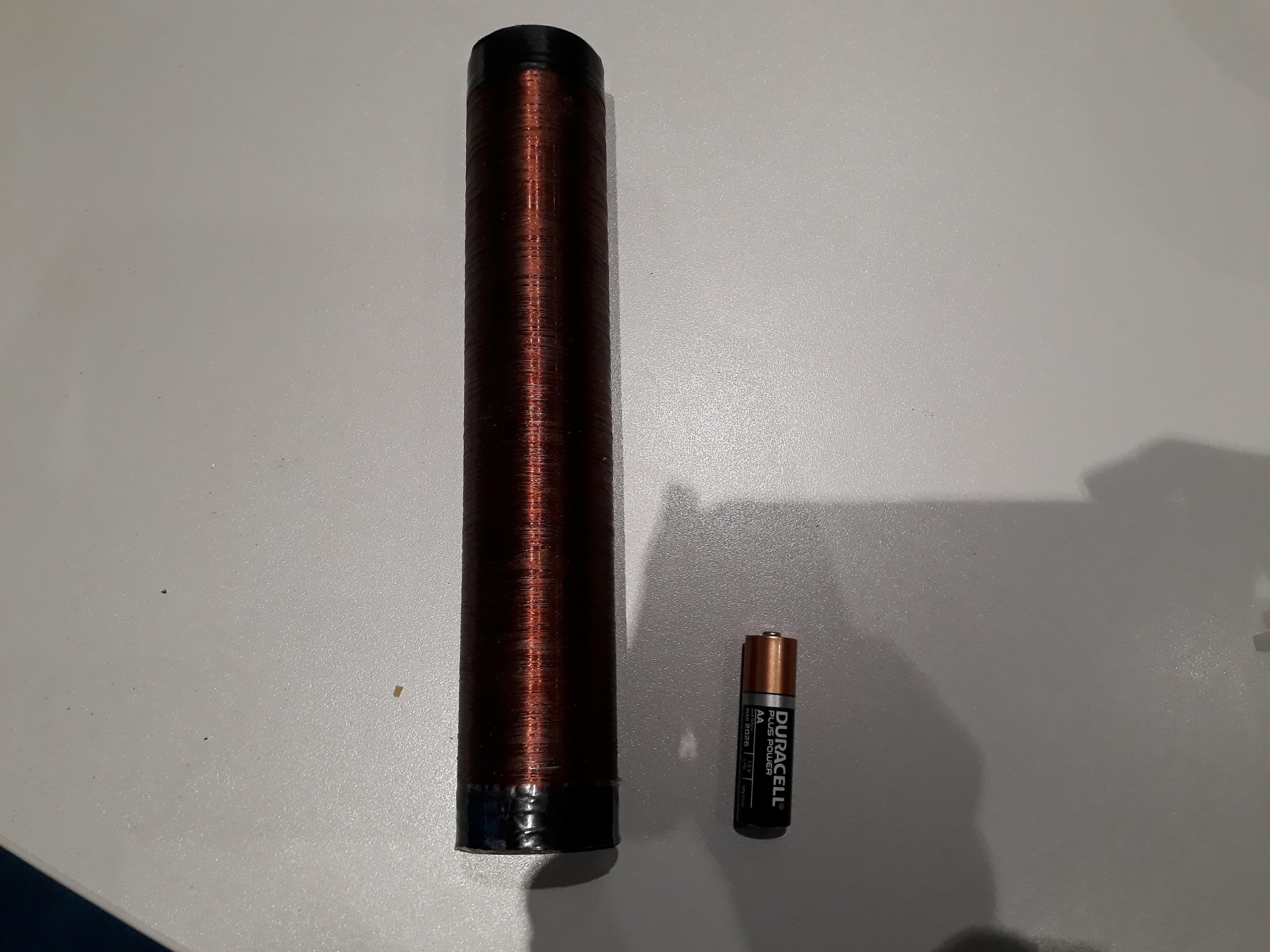

Secundary;
-0.1mm magnet wire
-pvs pipe is around 20cm in length and 4cm in diameter.

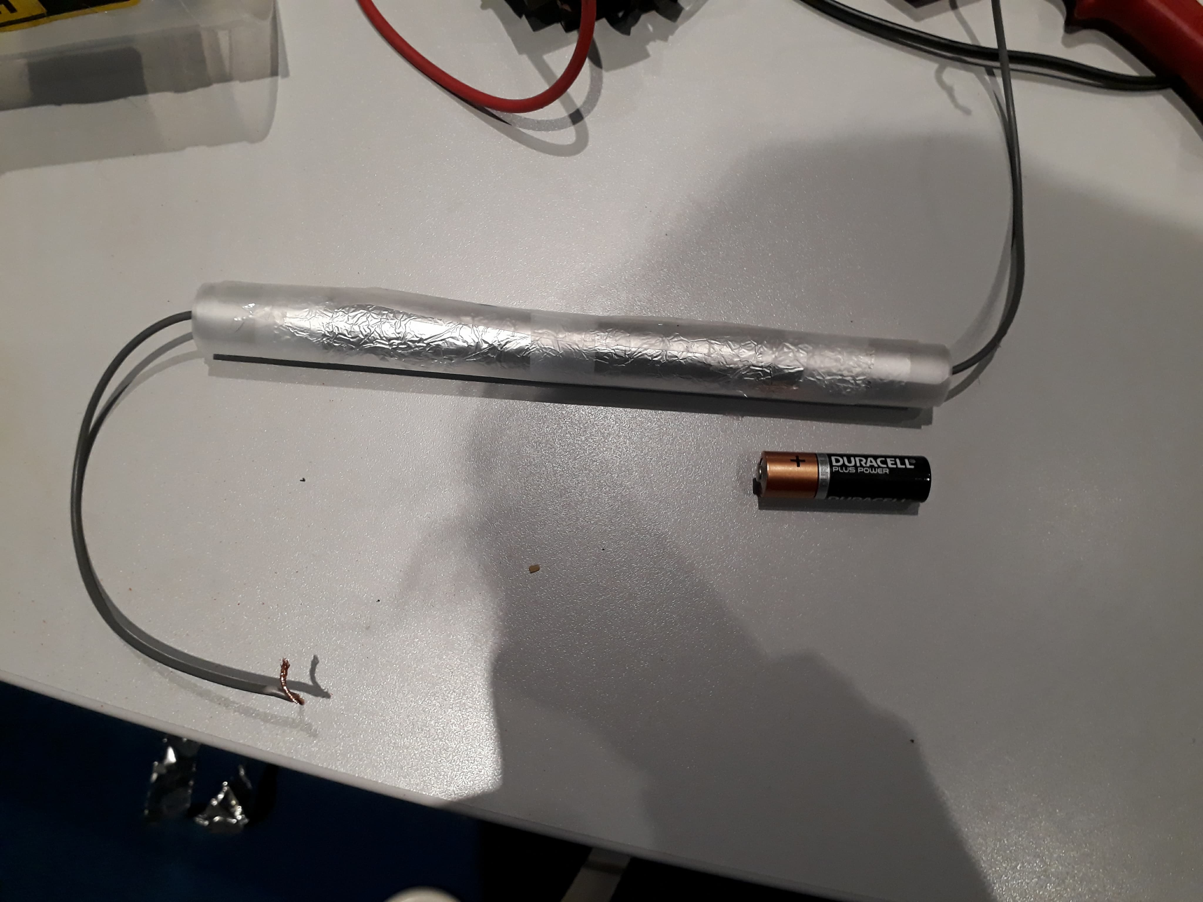

Capacitor;
-Its a homemade capacitor (see picture below) so im not really sure as to what the capacity is.

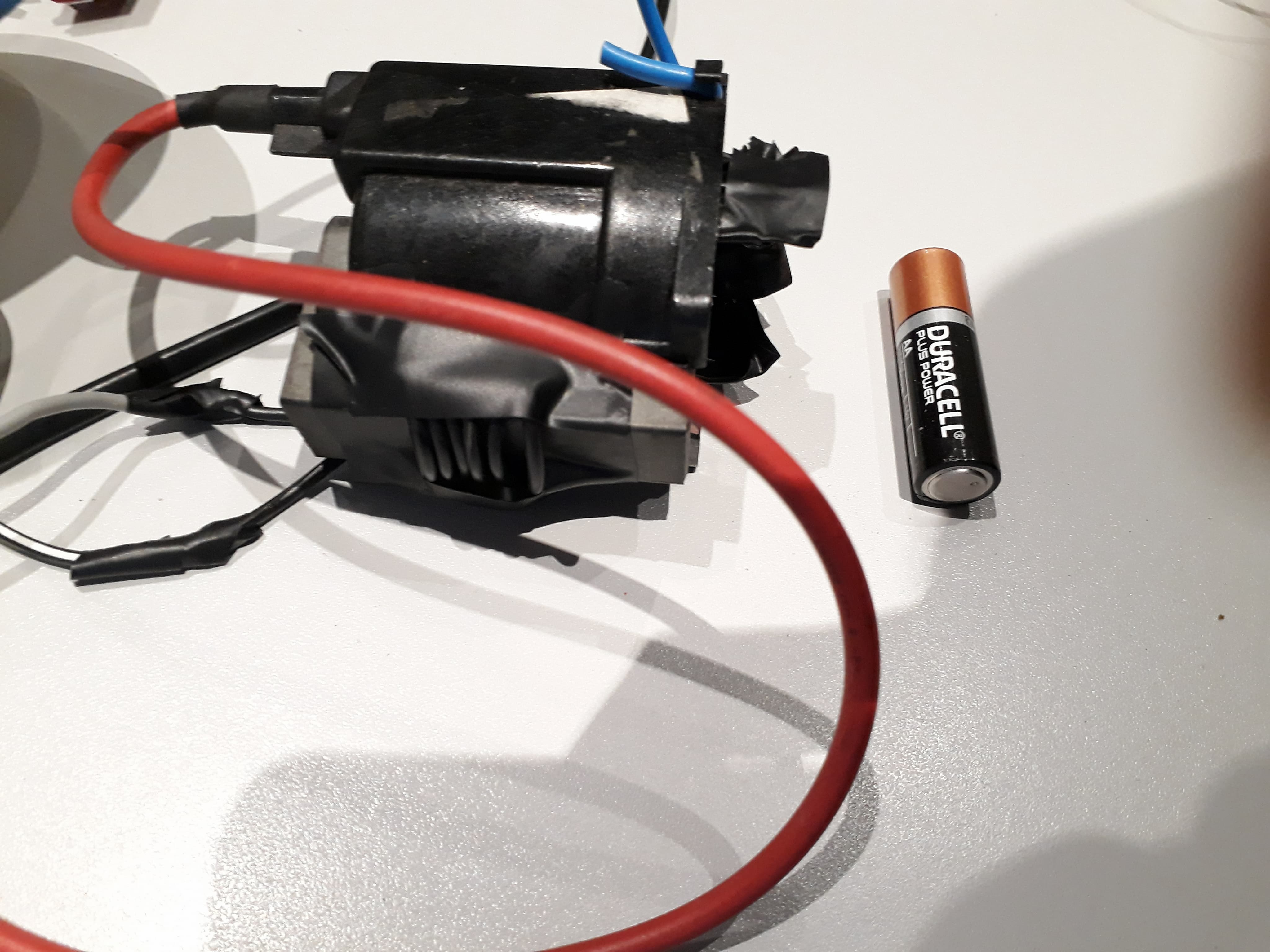

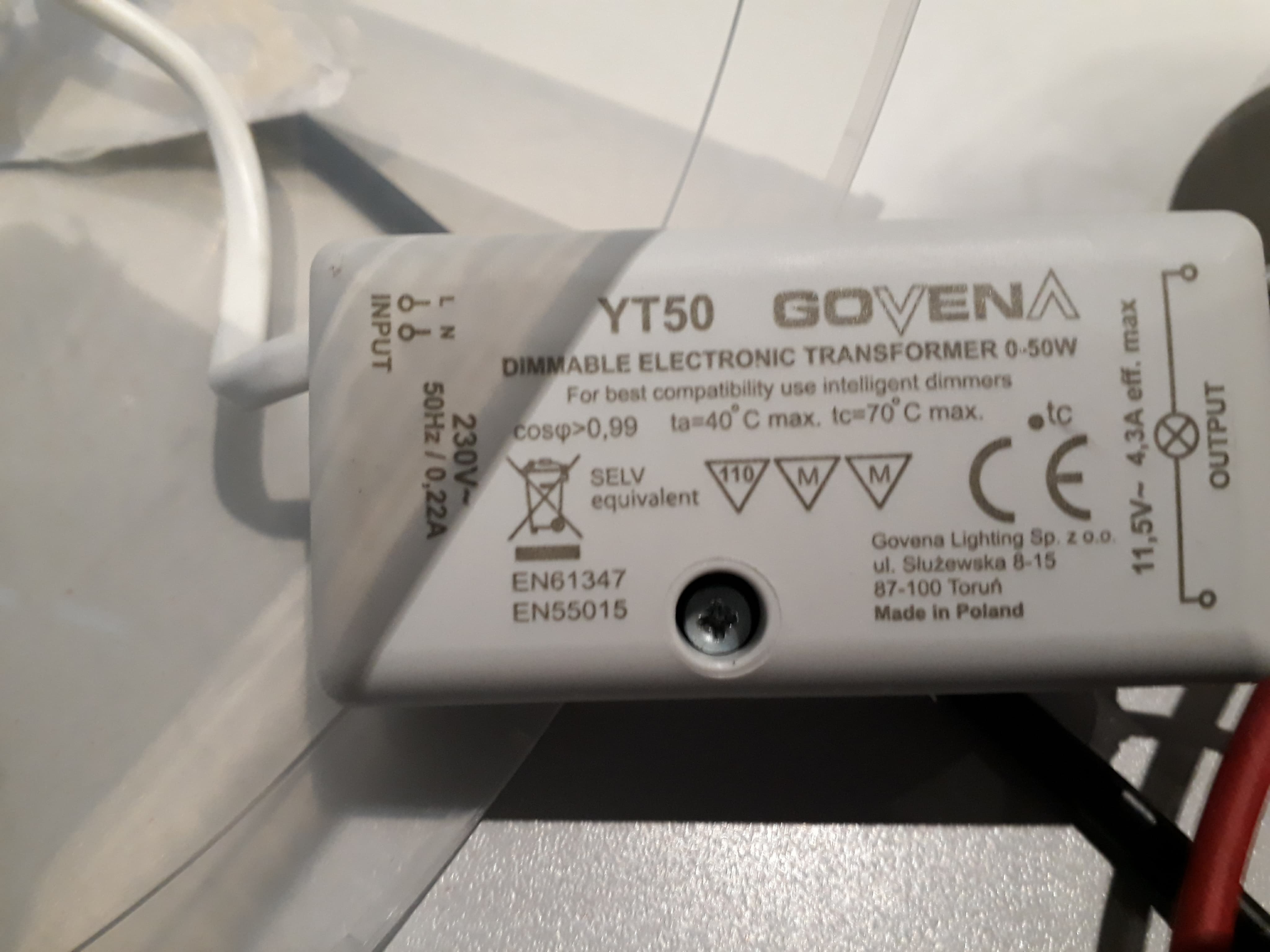

Powersupply;
-Basicly an AC flyback thats conected to a 12v led driver;
*So i need to know how many windings i should use for my primary coil and how big my spark gap should be.
Also i need help with my capacitor; my capacitor looks like it has enough capacity but i am not sure...
NOTE; i have tried to use online tesla coil calculators but i cant figure them out.
Any tips would be greatly appreciated!
if you need any exstra info just ask.
(battery for scale)

1. Diameter = 4cm Height = 20cm
2. 0.1mm copper magnet wire ( i think 38 AWG)
3.0.03mm
4.should be around 2000windings
5.its a Toroid 1.5cm thick and 8.5cm in diameter
i used deepfried neon's site to calculate it. (https://deepfriedneon.com/tesla_frame6.html)
0.03mm is not a standard insulation thickness for 38 AWG magnet wire, so I am using the closest standard value (0.02 mm).
With a coil radius of 2 cm, height of 20 cm, and 38 AWG wire with 0.02 mm insulation thickness, I'm calculating only about 1093 turns. That should be fine though.
Using JavaTC (written by Bart Anderson - someone I have spoken to on numerous occasions) I am getting a toroid capacitance (based on the dimensions you provided) of about 2.267 picofarads. This is probably much too small for your coil, and will cause the resonant frequency to be way too high to be practical. Based on the dimensions you provided I am calculating a secondary coil inductance of about 8.6 mH, meaning the resonant frequency will be over 1 MHz. When you take the parasitic capacitance of the secondary coil into account it's closer to 850 kHz. While there are indeed coils that run at this speed, it is probably a bit high for your particular coil. That being said, let's carry out the remaining calculations. Your target Fres (resonant frequency) is 850 kHz. Remember that number - you'll need it.
Next let's look at your primary capacitor. You say it's 7.5 nF simply because that was the value of the one made in the video. Unfortunately that's not good enough. The value can change significantly from one capacitor to the next. You really need to know the EXACT value of YOUR capacitor, you can't simply say yours is 7.5 nF because that was the value of the one in the video. Most multimeters nowadays have a capacitance setting. I recommend measuring the capacitance of yours using a meter. From there we can calculate what you need for a primary coil.
It seems to have a capacity of 3.9 nF
