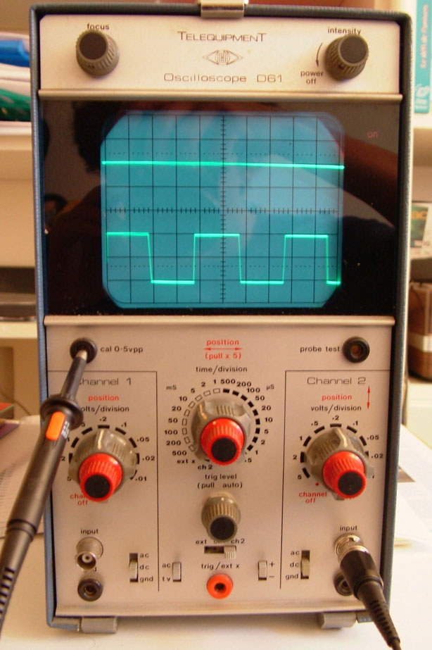

I have a relic D61 from the 70's, its mainly used for iffy jobs on high voltages so I dont blow up my newer philips I recently aquired.
The trigger circuit stopped working, and using my other 'scope and a sig gen I traced the problem to the trigger amp, one of the transistors wasnt making connection in its socket, so its now soldered direct.
The trigger still isnt good on certain ranges, it'll trigger ok for a second if I move the trigger switch from normal to tv and then back again for a second or so then fail, most of the ranges work ok, I think maybe a cap is leaking or breaking down or maybe the h timebase switch is bad, I've cleaned it a couple of times.
Another issue that concerns me more is if you turn up the brightness past a certain point the displayed image gets bigger as if you just increased the input signal, I'm thinking maybe power supply issue, the caps are original.
This thing probably should go in the skip however it has it uses and there is some sentimental value, my mrs bought it for me a while back
The brightness/size issue is called blooming and is a sure symptom of PSU not regulating very well. Most likely caps gone bad (as you said).

Yes I have a esr meter, and it does in circuit, and I have tested all the caps, 3 4u7 150v caps were slightly high and have been replaced, it didnt make much difference the scope still didnt trigger, only when I soldered the 2nd and 3rd stage trigger amp trannys in did the scope start to trigger properly (they were in sockets), theres still 2 or 3 ranges where the scope will trigger ok for a second then bomb out, making me think dodgy cap or range switch contacts, the trigger amp looks like it has variable bandwidth controlled by the range sw.

I squirted all the pots and switch contacts with switch cleaner, however I dont know if the trigger pot is crackly or not, that did concern me, looking at the output of the trigger amp on another scope there doesnt appear to be any crackles, if changing the psu caps doesnt sort it then I'll take out the trigger pot and check it off the scope, putting dc accross the track and connecting my tracer to the wiper I found to be an excellent way of finding noisy pots.
