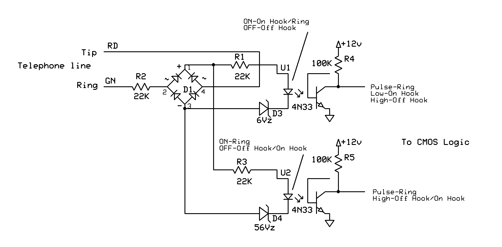

I read this thread here about telephone monitoring circuit :
There is a circuit as shown(attached). How can i connect the output from the optocoupler to a microcontroller to detect whether there is ringing, off-hook, on-hook? the output has +12V supply connection whereas microcontroller detects +5V as high.

ravi17,
That's my circuit. It was part of a system that did many, many years ago to add HOLD to all the phones in my home. To use it with a micro-controller just use +5VCD on the opto-transistors instead of +12VDC. Then you can use the two opto outputs to have the micro-controller logic determine the three states:
On-Hook: Upper LO and Lower HI
Ring: Both Upper and Lower Pulsing
Off-Hook: Upper HI and Lower HI
Ken

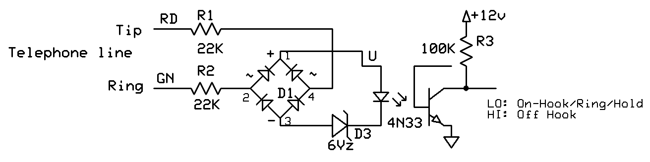

the circuit is not so detailed. can you tell which diodes you are using in the bridge and also the zener diodes? is it 6Vz or 6Yz?
i will try this circuit
6v Zener 1N4735 or equivalent
56V Zener 1N4658 or equivalent
Bridge diodes 1N4002 or equivalent
Ken
the condition is exactly opposite for on-hook and off-hook,
On-Hook: Upper HI and Lower HI
Off-Hook: Upper LO and Lower HI
could you confirm?
thanks
That circuit will not allow the line to open. You cannot leach any more than 0.5mA for the line to open.
more importantly, i do not understand the output interface to microcontroller. the output is connected to 5V supply via 100k. The voltage is in the output for on and off hook is 1.55V and 0.12V. how to interpret these are logic 1 and 0? then the ringing signal is ac signal. how to convert this to 1 or 0?

Having had a telephone company employee come to my house and cut the wire between my home-made line monitor and the wall I can tell you the telephone companies don't like people drawing continuous DC current from their lines. The central office continually scans the lines looking for persistent leakage. My equipment was drawing only 500 uA when they found and unceremonious disconnected it. Maybe another approach that only sniffed at the lines, drawing a few uA or so would be a better choice.
