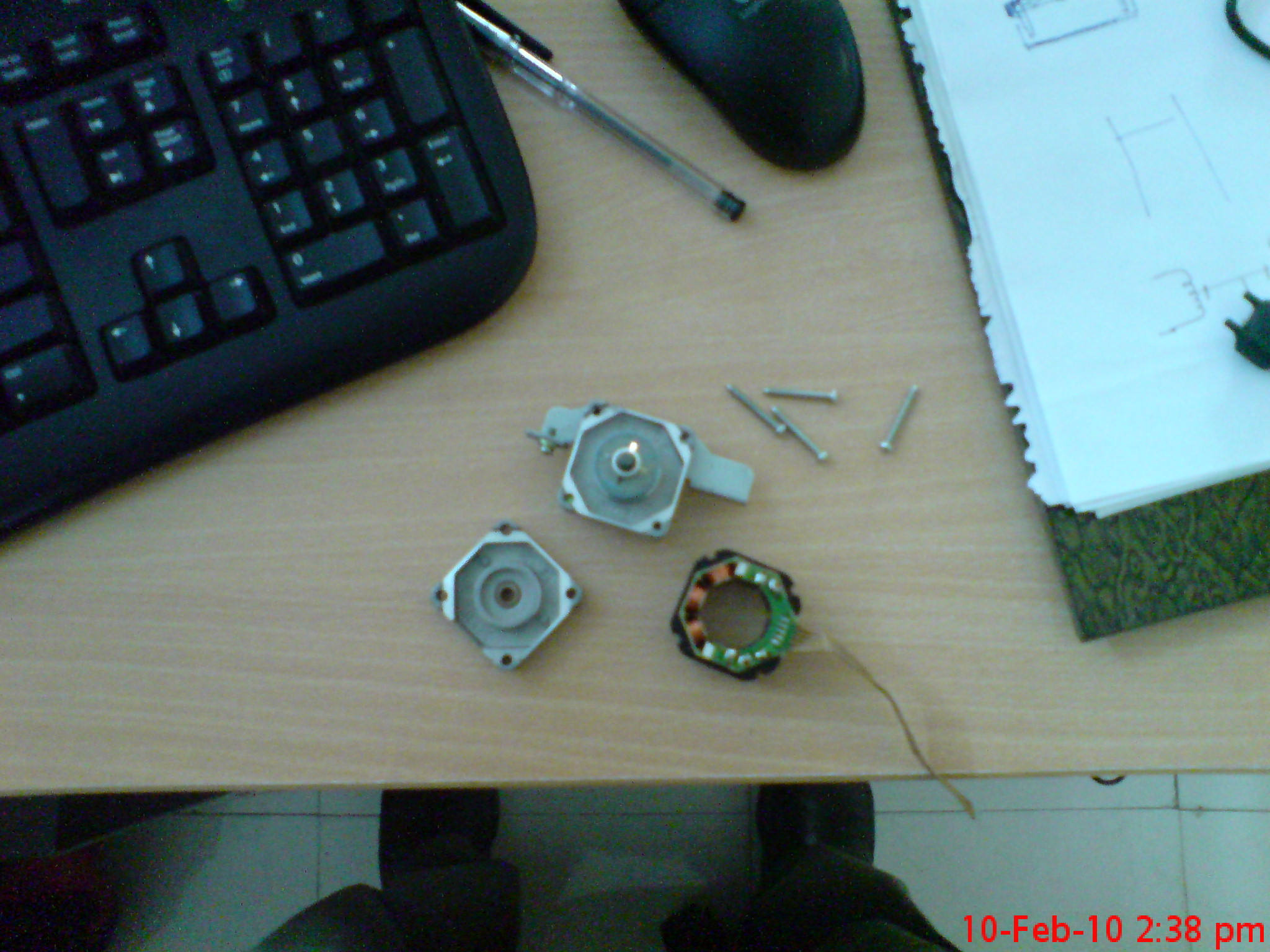

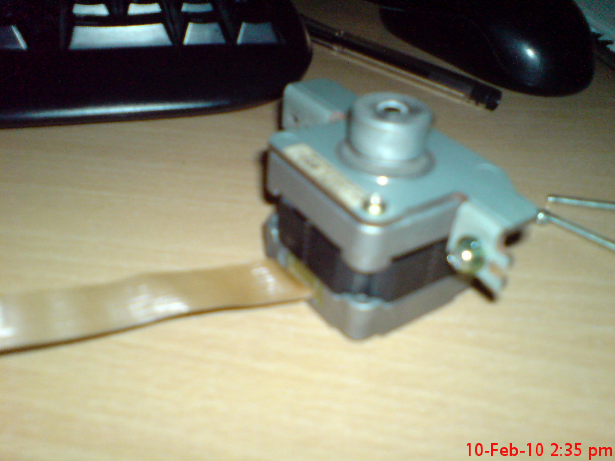

As per the above image
The internal wirings are like this.
The resistance Between A and B, A and C , B and C = ~ 471 Ohms
A or B or C or D with E is = ~ 71 Ohms
The coil can with stand up to 750 mA.
I will measure and I will let you know the maximum speed and Maximum Torque.
contact in personal for advise :sanalece@gmail.com
So you cannot use this like an ordinary stepper motor, which has indipendent A1, A2, B1, B2......!
Because it hase connectivity with the entier coils....
Here are the Photos of the same ........
