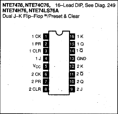

Hi there. Im new to the forums and have a question. Im building a circuit that uses the momentary tactile switch I have as a push on push off button to light up an LED. However the only solution to this I found on Google through just one site found HERE was to use a J-K Flip Flop IC. Now I managed to score some off of RadioShack.com, only the ICs I purchased are NTE74H76, which are 5v J-K Flip Flop IC with Preset/Clear. I also managed to download the PDF to what each of the pins do off the IC chip. I followed the instructions the site gave, but the only difference was I have my 9v battery running through a 7805 voltage regulator to drop the voltage down to 5v, run it all through the breadboard, and....the LED just stays on no matter what, even if I output it from Q or /Q. Heres how I wired it:

Power it up and it stays on no matter what. After repeatedly pushing the button, it still stayed on. No flicker or anything. And like I said I even tried wiring it to /Q as the output but same thing happened. Here is a pic of the chip Im using. What could I be doing wrong? Thanks in advance and let me know if you need more details or pics.

I would have gotten to this days earlier, but work and real life caught up with me. I managed to kinda get it working by putting J, K, PR, and CLR on High according to a website I found. They said this puts the chip on toggle mode. I also wired the tactile switch wrong like alec_t said. Turns out after hooking it up to a potentiometer and messing around, I had to put the (-) of the button to ground, and connect the (+) of the button to the CLK of the chip, not feed in 5V. When I had the 10kΩ pot down to 0Ω, the light stayed on. When I added a little resistance turning the knob, It started doing what I wanted it to do. So I replaced the pot with a 2.2kΩ resistor since anything about higher caused the light to stay off. Only problem is, it did what I wanted it to just 60-75% of the time, not fully 100%. Pushing it for on, and pushing it for off caused it to sometimes momentarily turn on and off, but once in awhile. Another thing is, is that I think the IC chip itself has a little bit of resistance cause the LED wasn't fully bright when compared to directly wiring it to 5V DC. Would use a multimeter but the Radio Shack one didnt even last me 2 weeks and I couldnt return it. I might resort to Mikes alternatives, but I feel Im so close with the circuit I currently have. I think a 2n4401 transistor might help if I output Q to it, so it makes the LED bright again, but I don't know how much power or current that transistor is truely gonna make it become. Anyways I never went to school for electronics as Im just a hobbyist, although I can understand some but not all schematics. So here is a rough sketch how I wired everything in the breadboard. Resort to the pinout of the chip in the first post if you have to:
That's because of switch contact bounce. You have no debounce capacitor on the breadboard. Connect 10uF between the switch+ and ground (with the -ve leg of the cap at ground).

Holy cow you are right! I put a 10uF capacitors (+) leg at the switches (+) leg, grounded the capacitors other leg, fed 5VDC into the resistor, which is connected to the LED, and grounded the LED at Q of the IC chip. Powered it up and bam! It works! Problem resolved. Thanks alec :D
