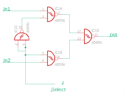

Can a 4093 do this? I think it can.
The output is inverted, so this would not work, but a logic chip rather than an analog switch does seem like a better choice.
But a logic chip does solve the "We join this message in progress" sync problem.
Something like,
Ah, gotcha. That would work great, except for the sync problem in switching between streams.
