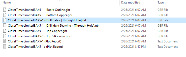

Question: should the "Drill Data" file be type Exceleron or Gerber?
Here is a plot i created in feb of last year. See how the file name is called "Drill Data"? thats just how it was outputting the plots before the update. And its type is Excelleron.
When I talk about a drill data file, I'm referring to the file content format, not filenames or extension names.
The Drill Data file should always be Excellon format. JLCPCB has their file naming requirements but the file content for most of the files is Gerber EXCEPT for the Drill Data file.
The Drill Data file is still Excellon format, not Gerber.

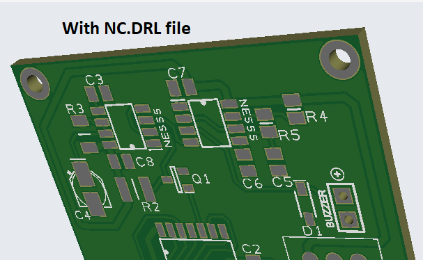

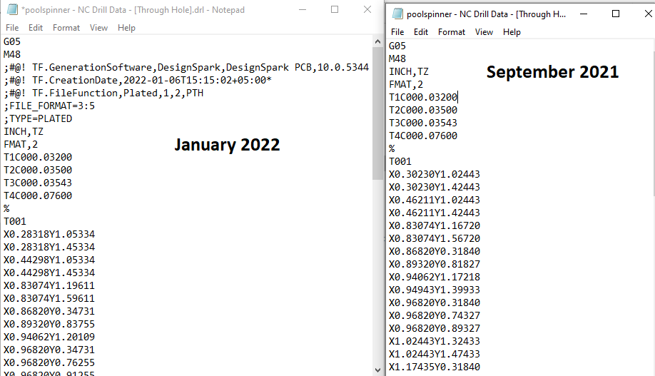

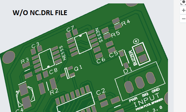

I ran a test.
here are two NC.drl files. You can see what 10.0.1 added to the NC file. Some reference notes. they are supposed to be ignored by the viewer but they are not because i uploaded this file once with the additional info and again with the info removed. The manually modified file rendered in their gerber viewer.
These are from the same project that were compiled under version 10.0 in september and then under 10.0.1 in january
This is what i removed from the .DRL file
;#@! TF.GenerationSoftware,DesignSpark,DesignSpark PCB,10.0.5344
;#@! TF.CreationDate,2022-01-04T23:26:32+05:00*
;#@! TF.FileFunction,Plated,1,2,PTH
;FILE_FORMAT=3:5
;TYPE=PLATED
