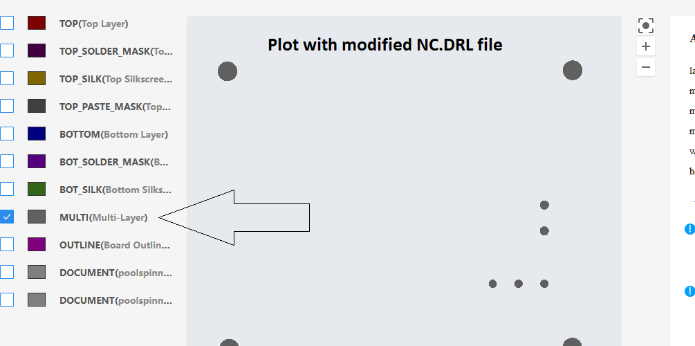

Modified (Edited) NC.DRL plot

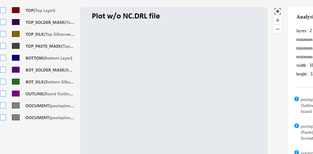

Note of all the available layers here the .DRL file is not available.
Understandably so because it is not a Gerber file (GBR) however there is a difference as shown so i can assume the .DRL file is utilized but not shown in the viewer.

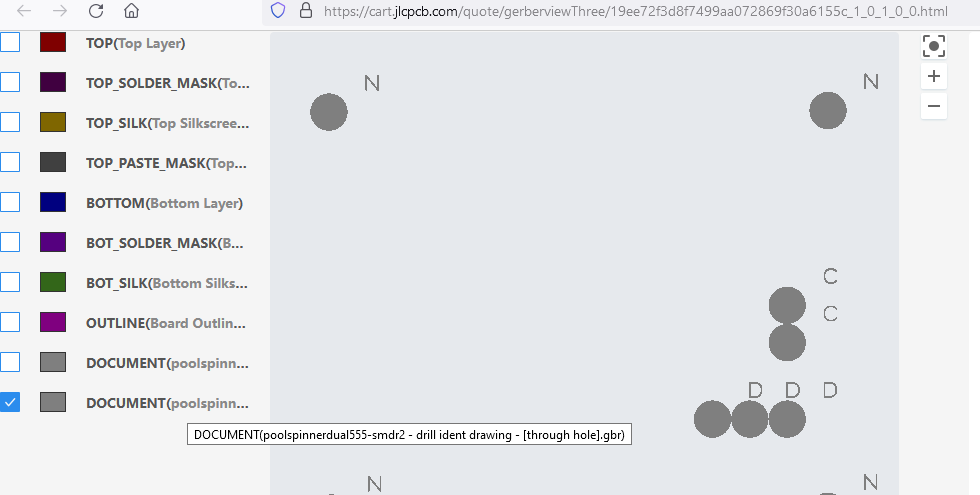

That looks like the drill identification drawing. That one IS gerber.

i wouldnt know but without the .DRL file the plot is not right so i dont think it can be left out. however... in DesignSpark if you AutoGenerate plots your prompted with an option to include 3 plots or not. one is the NC.DRL file. :rolleyes:

This is the "poolspinnerDual555-SMDr2 - NC Drill Data - [Through Hole].drl" file - This is the correct excellon drill data file.
And it should look like this(I turned on the board outline layer (red) for clarity):

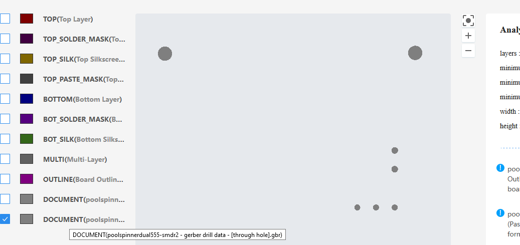

I don't know what the "poolspinnerDual555-SMDr2 - Gerber Drill Data - [Through Hole].gbr" file is for and I don't think that is needed.
This is the "poolspinnerDual555-SMDr2 - Drill Ident Drawing - [Through Hole].gbr" drill Identification Drawing. It is also correct:
Ill play it safe and include it anyhow. :D

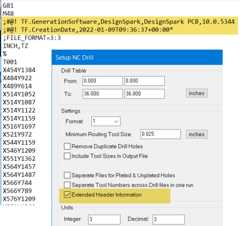

I made the following parameter changes to the NC.DRL output that i found on the DS support site. I uploaded the plot files to JLCPCB and it rendered in their online gerber viewer.
Ive attached the plot file for anyone wishes to verify it.
Format from 2 to 1
Checked "Remove Duplicate Drill Holes"
Changed Decimal from 5 to 3
UPDATE: THIS SCREEN SHOT IS FROM THE DS SUPPORT SITE.
It is 1 year old and does not include the new parameter options from 10.0 and 10.0.1. See post #37
The .DRL data file.

Should be. Thank you for helping me. I only ordered 5 boards. I feel more confident after the modifications I made to the .DRL file parameters. I havent done any more tests but i believe it was the FORMAT setting change from 2 to 1 that was the problem. Im gonna call this one solved.
Well i couldnt resist. here is a comparison between the .DRL files before and after the parameter changes.
Here is a link to the most common header commands for drill communication for Excellon files.
UPDATE: .DRL
JLCPCB can read Format Type 2 just not with the header comments in the .drl file.
But, if it is Type 1 Format JLCPCB can read the file with the comments in the file.
A rep from DS showed how to remove the header info from the .DRL file by setting another parameter change. He also recommends using Format 1 as it produces a pure drill file i.e. no milling profiles as are available in FMT 2.
Considering that selecting format 1 and leaving the comments in the header produces a file that renders in the online gerber viewer still leaves me to believe there is an illegal character in the header when other options are selected. In my software programming days it may have been a huge problem for me but ill leave this one to DS to figure out.
