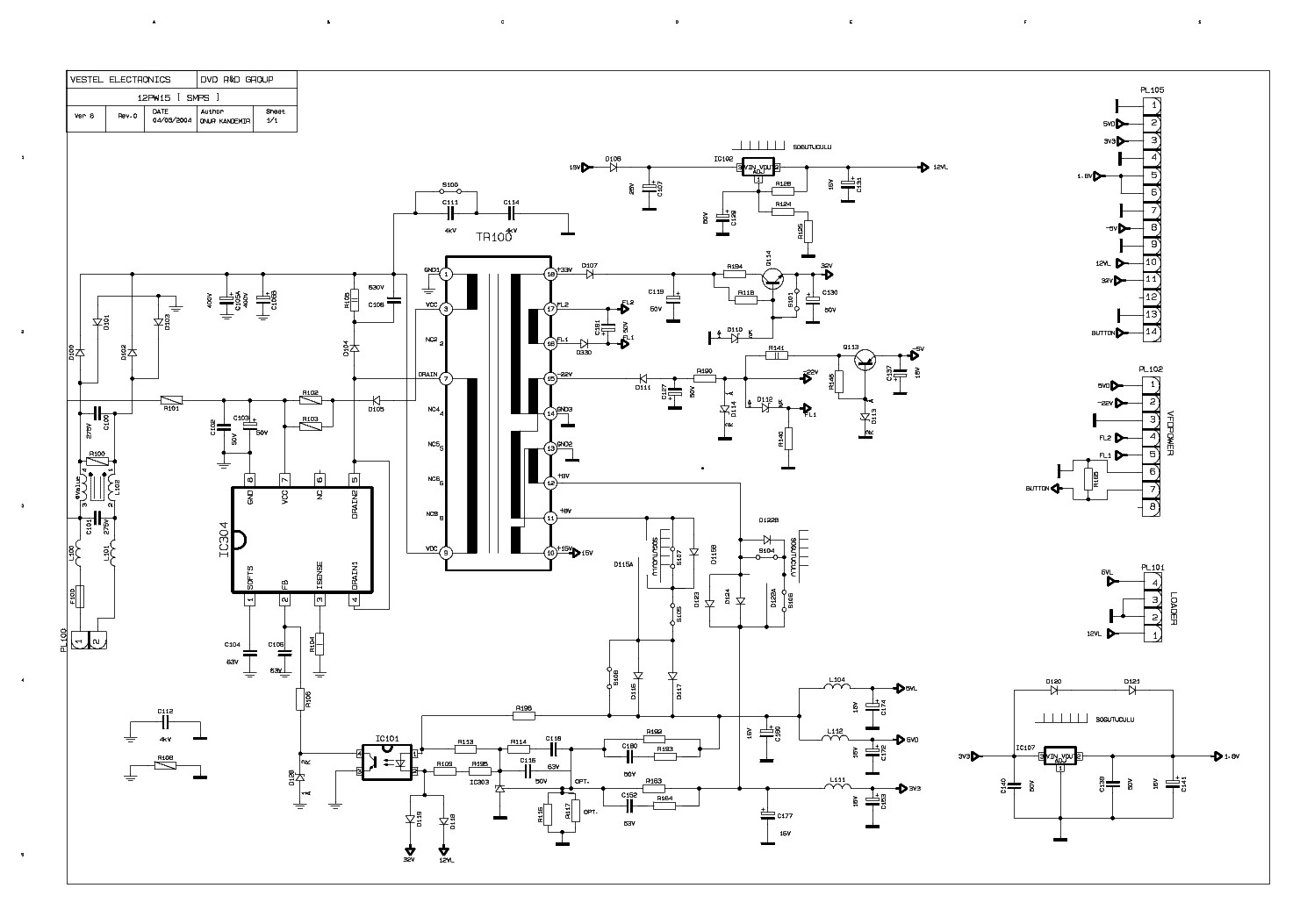

yeah i understand what you mean, and i agree, but the power supply i'm dealing with it's just childish, there's no way an experienced person
not to understand how to repair it, even me, that i don't have any serious knowledge i can understand enough of it, for example...
all the "high voltage" side it is built around the SMPS IC which is probably the ICE2A265 (unfortunately has nothing to do with
what KeepItSimpleStupid proposed) the pinout it is exactly as the ICE2A265 and even if it is not the exact IC the board uses, then
it's another less wattage or more wattage.
if you check the board all the left side it's just filters and a bridge rectifier out of 4 simple diodes, and the standard infineon circuitry for the ICE2xxxx series ICs.
the right side is more mystery to me and i only understand the circuitry around the LM317T which is correctly placed
from the factory because while i was thinking it again and after a talk with a guy, there's NO way the DVD motor to require 12V/5A to spin!!! probably 5 amps are needed only as a peak current.
so to summarize...the initial problem i don't know the cause, could be broken joints that i haven't noticed maybe?
i found the lm317t that i had desoldered and i tried it somewhere else and it works just fine! even though while it was
on the power supply it was getting extremely hot (120c) and it couldn't start the dvd motor.
why the lm317t was getting hot while i was connecting the dvd connector? maybe the input-output voltage difference+current
was too high?? (too much dissipation on the TO-220 package)? if that was the case..then what could cause the
transformer pin to output higher voltage to the lm317? maybe the SMPS IC it's the cause of the issues and was already
faulty and that's why it blew after awhile? the board has a deep brown colour around the IC long before it blows off... and that probably means it was getting already too hot...
this device deserves to be fixed and i will be very sorry if i don't, could you please try to boost my effort? thank you.

Is there any chance you can make a drawing of the circuit board connections (schematic) yourself by tracing out the circuit board?
I've done this a few times in the past when there was no schematic available. It's not easy but if you take good photographs of both sides of the board (maybe a couple each) you can do it, and this circuit does not sound super super complicated. So maybe we can get this thing up and running again.
If you cant make a drawing (and i really really hope you can) then maybe at least post good pics of the front side and back side, so we can see the connections too. This might not be possible though because although the boards are two dimensional (more or less) the components are three dims and get in the way sometimes, so you may have to draw up the schematic yourself.
I can tell you that if you draw a good schematic and label where the inputs and outputs are and what voltages to expect there (inputs and outputs should be easy to tell) we can almost definitely fix this thing, unless maybe a transformer is bad and is too hard to identify or figure out what a replacement could be.
One of the other things i would also look for is bad snubber caps, asuming they do use snubbers, although they might not use them.
the schematic could be similar to this
Image isn't really readable.
this is the schematic...right now i'm checking it and the high voltage side it's exactly the same with mine, could you please download from here...because i've reached my download limit for today and i can't get pdf, i could only get the png photo.
https://elektrotanya.com/vestel_12pw15-6_dvd_power_supply.pdf/download.html
also..the SMPS IC has been replaced with the ICE2A265 but the power supply does not start.. (i can't hear the high pitch noise from the transformer), i took some measurements and the voltages don't seem right.
