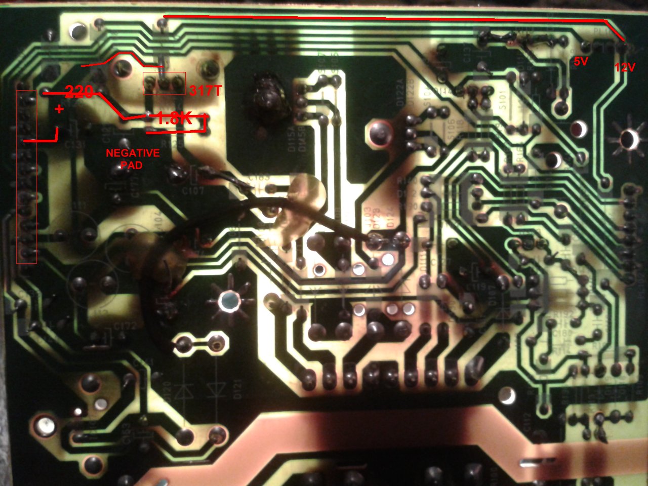

i'm facing a very weird issue with a DVD device...
by mistake i've damaged the power supply from a dvd player, replacing some components i've managed
to make work again, but the internal dvd device refuses to power up.
there's an LM317T on the power supply board, following the rails they go to the power connector for the
dvd but when i'm connecting it, the LM317T gets quite hot (120c) and the dvd doesn't spin, so i've tried to
replace the LM317T in case it also got damaged, but nothing happend.
i've measured the LM317T without load and it seems it is regulated at 11.45V also if i connect
something else, it works just fine!! without getting hot, also noticed the regulating resistors are 220ohm
and 1.8k so i guess the output i've measured it is quite ok.
now if i use an external power supply for the internal dvd it starts to spin and everything works perfect!
so then the internal dvd isn't damaged, but what happens when i'm connecting the dvd power connector
to the internal power supply?!
checking the label of the dvd it says that it needs 5A for the 12v rail and 1A for the 5v rail and that probably
explains why the LM317T (TO-220) gets so hot! but how on earth it worked all this time and what should
i do to repair it?!!
thanks in advance if anybody is willing to help!!!

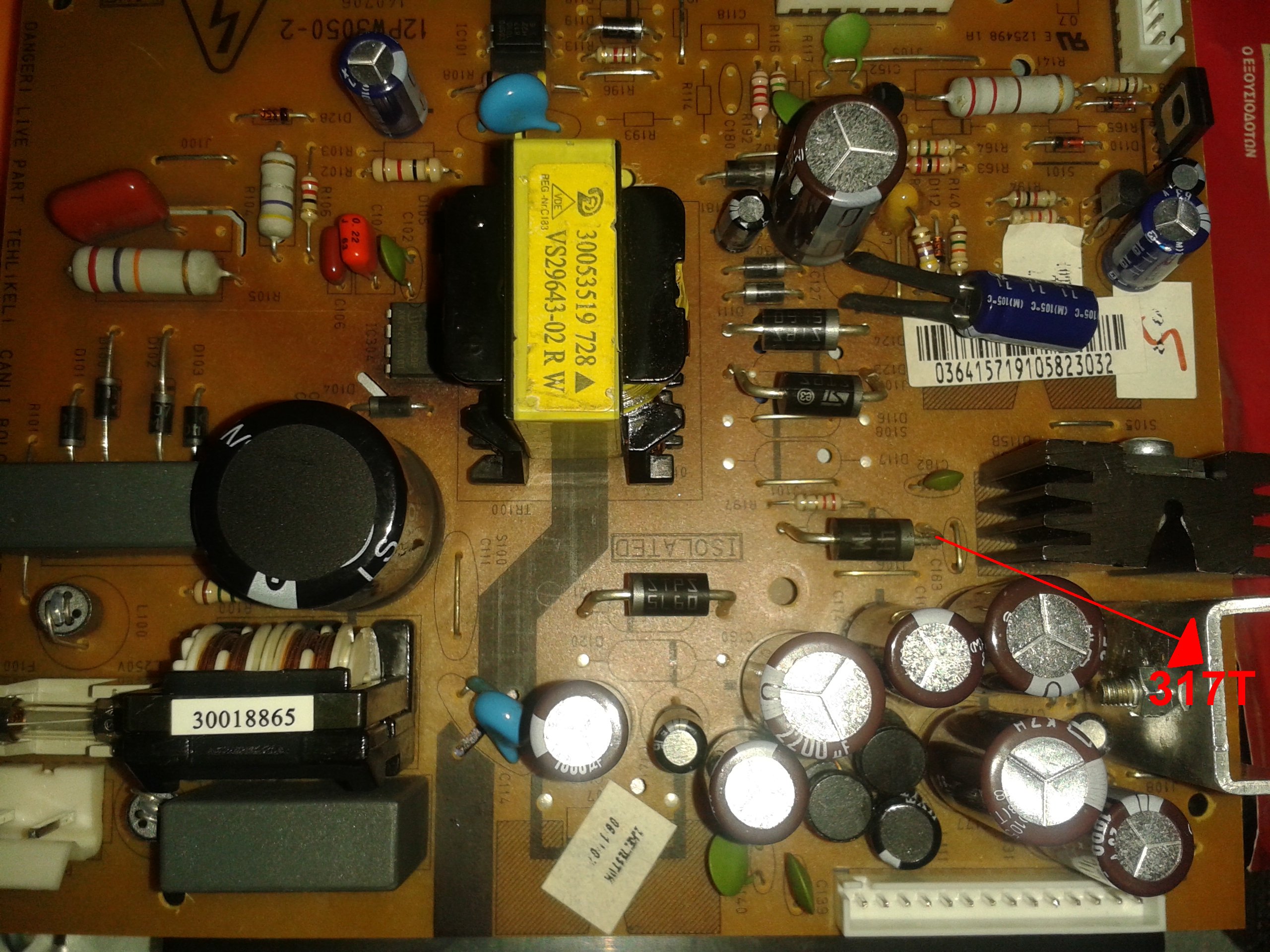

here's some photos.. i've replaced almost all semiconductors and some capacitors
the 317T, BC337, TL431, BD238 the input voltage for the 317T seems to be
around 13V it is supplied thru a huge diode.

What's on the heat sink above the regulator? Could it be a pass transistor?
ronv
To me you have a common mode filter, a big cap. near the yellow/black transformer we have an IC which could be a switching regulator. Topagraphy is consistant with a switching pre-regulator.
The thing that you think could be a pass transistor is consistant with a "FET switch" for the unregulated supplies. Then you have a +12 regulator which isn't heat sinked much because it's already pre-regulated.
Your 5A measurement really does suggest the wrong regulator is there, You also mentioned a huge diode. The current rating of the diode would also be a clue, The part I suggested is a plug in replacement for the 317T.
i haven't measured any current... and yes from your sayings and from what i can see that's what i also believe, they placed wrong regulator.. but how exactly it managed to work all this time?!
it's a diode, the IC it's for the switching.

My guess is what you think is a huge diode is really a large transistor that works to share some of the current for the 317. If it were really just a diode feeding the 317 it wouldn't need a bigger heat sink than the 317. It could never have supplied 5 amps with the 317 alone. Can you measure the actual current when it is running from your power supply?
So, just to recap, in this snip of the 4 pin connector:
have you confirmed the voltages you listed? Or are those number assumed?
hi, yes, the 5v rail it's 5.25V and the 12v rail it's 11.45V without load.
the 12v rail tasted with an external load and it worked..the consumption was around 200mA and the LM317
didn't went hot.
it's not a large transistor it's a power diode on a heatsink
https://www.farnell.com/datasheets/1761342.pdf
the diode that supplies the lm317 it's obvious on the second photo behind the heatsink of the regulator

also!... notice the power line in the first picture that goes in the left side of the pcb to a pin
these pins are various output voltages 3.3v, 5v, etc seems it also supplies 12v to the processing board, so then the current consumption is high enough and obviously a single lm317 can't make
it.
so i'm puzzled with all this thing.....

Hi the 12v power supply comes from the regulator...the regulator is supplied by the axial diode next to the btown capacitors
There are a lot of things that don't make sense.
1- If the diode is on the big black heat sink when it only dissipates 2.5 watts and the 317 is on a little heat sink when it would need to dissipate over 10 watts. Besides the diode looks like it has 3 leads when viewed from the bottom side.
To me it looks like the 317 is fed from the little diode next to the text isolated.
2- If the input to the 317 is 13 volts it can't be a regulator for 12 volts as it needs ~ 2 volts (14v) higher than the output. But since the divider is set up for 11.5 volts it would seem the input is to low.
Anyway we are missing something.
indeed it looks like that...but the middle pin is not connected anywhere...
also the lm317 INDEED its feed from the smaller diode the axial one! i said
that before also there's a red line on the second photo that shows it.
