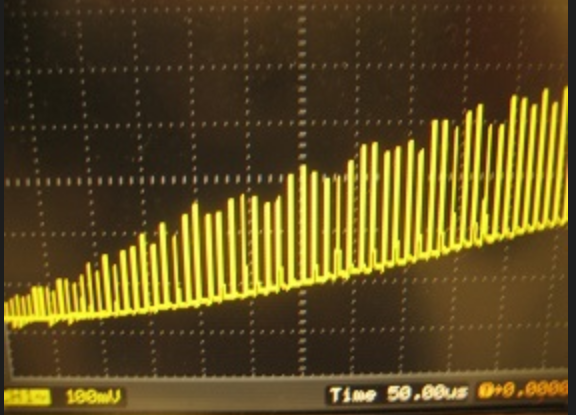

Another way to find bad DC filter caps in power supplies is to set your meter on AC to measure the ripple voltage when the supply is running under load.
There will always be some ripple, but not too much. Unfortunately there is industry standard number for how much is too much, but I'll throw out a target of < 10% of the DC value.
I'll start measuring those values on good and bad supplies to gather some statistics.
Here is the output on a scope (AC coupling) with the bad cap 100mv per div

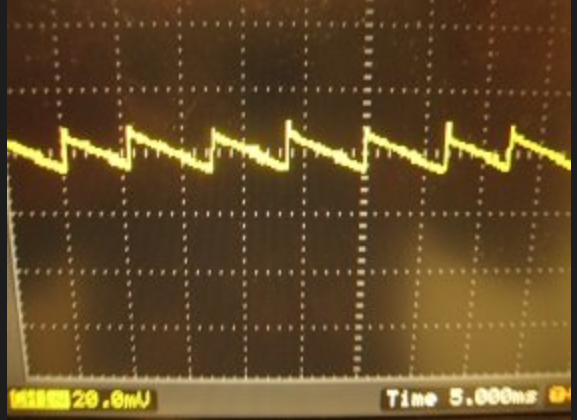

Here is a back up power supply with the same specs. I suspect the output will be similar when the defective one is fixed. 20mv per divison
As always, only some meters would do that, for most you would have to add an external blocking capacitor.
But why bother?, simply measuring the DC voltage across it (as tvtech suggested) would clearly show the fault.
