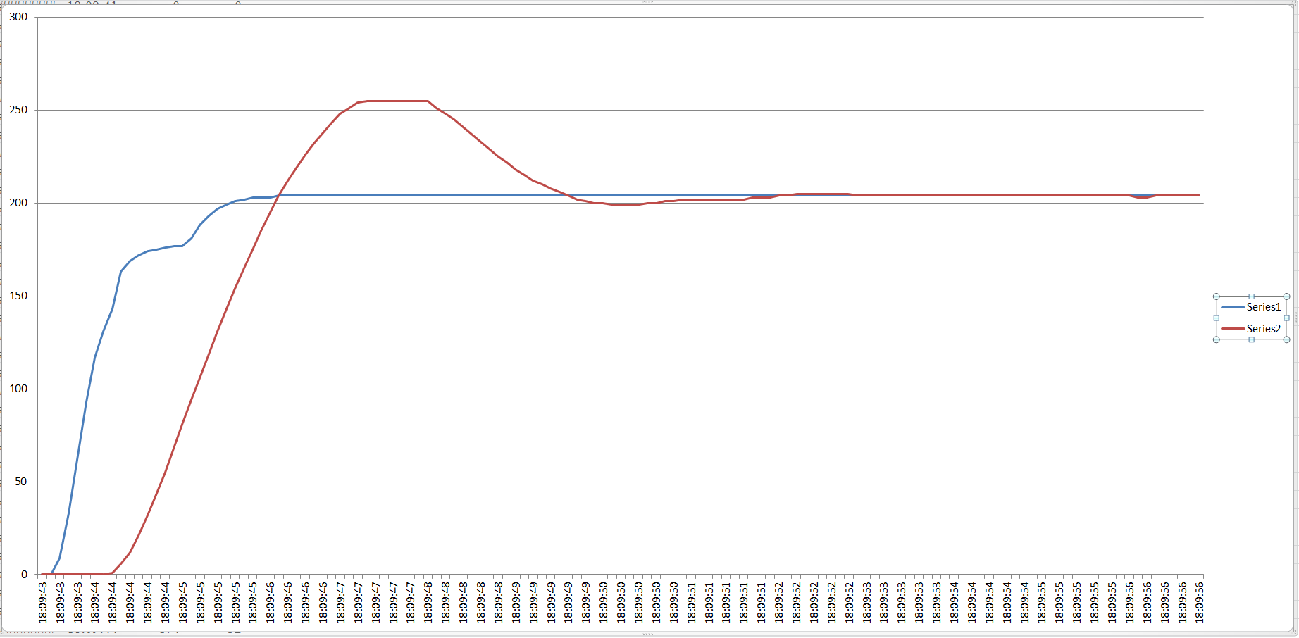

I made a laminar flow element, connected it up & there is now only a minor variation hardly noticeable maybe around 2mm of water, very good.
I have attached an Excel graph of the PID working, no particular voltages set in the sketch as yet.
There is a time stamp on the bottom & you will see that due to the plenum the settling time is very long, but that's the plenums effect. You will notice the table top on the overshoot, this is how long the plenum takes to stabilize.
Obviously the area under the curve needs to be a lot smaller, opposite to engines actually but the PID is working, you will see a step in the setpoint voltage but that was me with the switch on the wrong notch, not easy for me to dial things quickly now, hence the need for automation?
I will now try with the plenum removed to get some response & then I will tackle the hysteresis if it is a problem.
All looking ok at the moment, yes I will now put the correct values in the sketch on the graphs but I just wanted to get it working first, no good putting numbers to something that doesn't work.:)

Hi Kiss,
I just did a test without the Plenum, the response is not to bad but there is still an issue, it doesn't appear to be oscillating but there is something not quite right.
I guess it's time now to adjust some cancellation into it, just a little should do it.

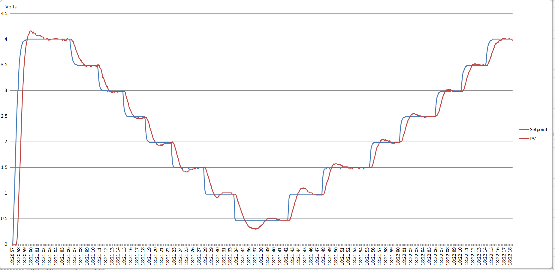

I decided to make a settling chamber today & connected it up without the plenum & tested it all out again, I understood very quickly that no matter what changes you make the PID needs to be tuned to suit each & every application which is understandable. I have learned a great deal today!
For the first time I have taken it to full power, the maximum of 4V input to the Arduino & no sign of clipping without the Plenum.
I applied a very small amount of Hysteresis as you mentioned & found that it was very good at some settings & a bit unstable at others just like you mentioned also.
So, being PIG headed & loving a challenge I decided to see if I could actually get it ok on all the 8 setpoint settings without to much instability, even though I only require a couple of set points.
I was mentally challenged for hours not thinking correctly about it which is not unusual anyway, I was about to give up & thought logically for a change & realized that if all else fails in a car & you hit the brakes & can't stop you apply the Parking Brake.
So with that philosophy in mind I applied that to the sketch & bugger me it has started to work.
Basically for each setting the perfect scenario is an individual amount of Hysteresis that is perfect for the particular setting, so on each setting I have X amount as a starting point & the more the instability is present the more hysteresis is applied automatically cancelling the instability out.
On each setting besides 1, once the PID has settled, there is about 1mm of water variation which is excellent & it is working.
I have attached a quick graph of the PID stepping, it looks worse on the graph than on the manometer but I wanted to see if this is what you meant as a step test.
I will do a better test once I know what I am doing I was moving to quickly through it in a hurry to catch you..
Anyway what is done is done, see what you think!
Is that the sort of test you were talking about?

At 18:22 or so is what you want. PID seems to be working very well indeed. You did step the values around the values of interest which is what's necessary. You did plot what you needed to see.
Hopefully you didn't add hysteresis, but in reality you tried to make PID act more analog like. Some options are averaging of the measured value. You could also do a running average of the measured value. Your using a successive approximation A/D and that's inherently noisy. It's by no means dual/slope. The issues you have are real word issues. Fixing them requires going to the school of "hard knocks" or whatever it is. The problems don't show up on paper.
You want to ignore the Hysteresis. Maybe that's the same as adding it?

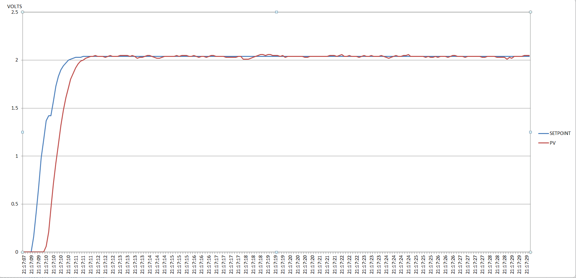

Hi Kiss,
I have been attempting the Ramp stage in the PID sketch & have it working beautifully now.
Basically the ramp stage is time & amplitude adjustable which doubles as a set point feature as well, all adjustable easily with the keyboard, now I can have 255 accurate set points if needed all with a few keystrokes.
I never realized before just how good this software thing is, it's great!
Everything is working really nice & accurate with no problems, the new program makes things a lot easier so I can now visually see what is happening, good stuff!
