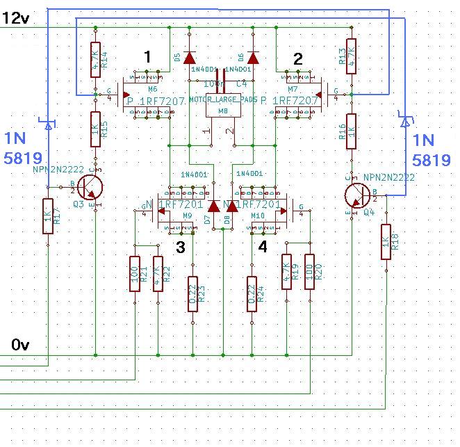

camerart Well-Known Member Oct 24, 2015 #21 Dvrefiokm said: The improvements you are requiring can be achieved. And then you will find that they will be slightly slower when the p channels turn off. Click to expand... Is this ok? Thanks, C. Attachments N-FET P-FET H-BRIDGE with Schottkys.jpg 82.4 KB · Views: 159
