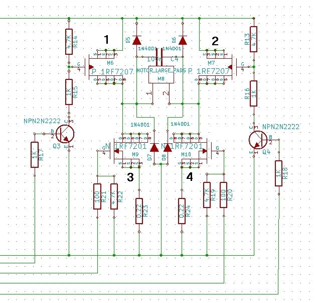

I have been using this design of H-Bridge for years quite successfully, only switching 1 and 4 or 2 and 3 on and off in pairs. I am now trying to use PWM, by switching PWM to 1 and 4 or 2 and 3. I have been getting odd results, because the settings for PWM need to be higher than I would have thought to start the motor. Thinking the problem could be a difference in ON/OFF timing between the transistor switched FETs and the directly switched FETs or the different characteristics of P and N FETs or both, giving misaligned square waves, I tried different switching. The stop/forward/reverse/stop sequence: ALL OFF>>1 ON then PWM 4>>ALL OFF>>2 ON then PWM 3>>ALL OFF. This gave good results.
Can someone confirm that this is a good way of switching please?

Looks as though it'd work, the resistors to the gates of the p channel fets, why are they 1k, 100r like the n channels might be better, you might find that there is shoot through when the p channels turn off as they will be slightly slower.
Also are the 2n2222's drive by a digital pull low/pull high, if not then a resistor to ground on the base is a good idea to prevent unwanted turn on.
A motor will take a certain amount before it starts, if your controlling a motor from software then program a 'kick' of higher pwm to get the shaft turning, if its practical to do so.
I agree with Dr Pepper, the gate resistors on 3 and 4 are marked as 100, while 1k is used on 1 and 2. This will give them inherently different switching times due to charging/discharging the gate capacitance. In addition the additional transistor stage will add some signal propagation delay.
At low duty cycles it may mean that your not turning on the upper and lower fets at the same time. And as pepper points out you might get shoot through if your switching between 1&4 and 2&3.
The sequence you suggest "OFF>>1 ON then PWM 4>>ALL OFF>>2 ON then PWM 3>>ALL OFF" will work well as the switching delay will be neglected. And you've selected the correct 'slower' switching fets to turn on while PWM the faster switching 4&3.
If you wanted to PWM both upper and lower fet at the same time i'd suggest changing the gate resistor so they match and possibly putting an extra transistor stage on the lower fets.

Hi Doc,
"Looks as though it'd work," Do you mean that it looks like switching the NFETs on, then PWM the PFETs will work?
EDIT: After reading this again and Misterbenn's post I now see what you mean. They should be changed.
Well spotted! I will add pull down resistors to the 2n2222 bases to GND. Thanks.

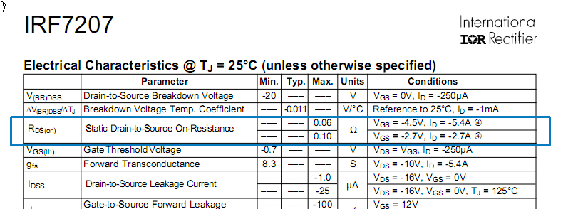

Hi C,
The IRF7207 is already hard On with the existing Vgs of close to -9V, check this image
The 2N2222 Base is connected to a PIC output pin via a 1K, you will not get unwanted turn On, unless the Base is left disconnected.

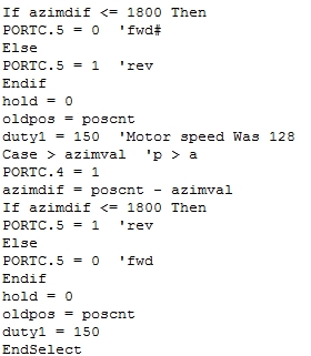

You are using 8 bit resolution for the PWM setting, this means 0 thru 255, as a program setting figure.
If you assume 255 is equal to 100% On period, then [150/255]*100% = ~59% On time.
Your current program only switches Forward OR Reverse, no parallel sequences.
It is very IMPORTANT that you determine the PWM control settings when the geared motor output is driving Fwd or Rev, the final head load mass.
E

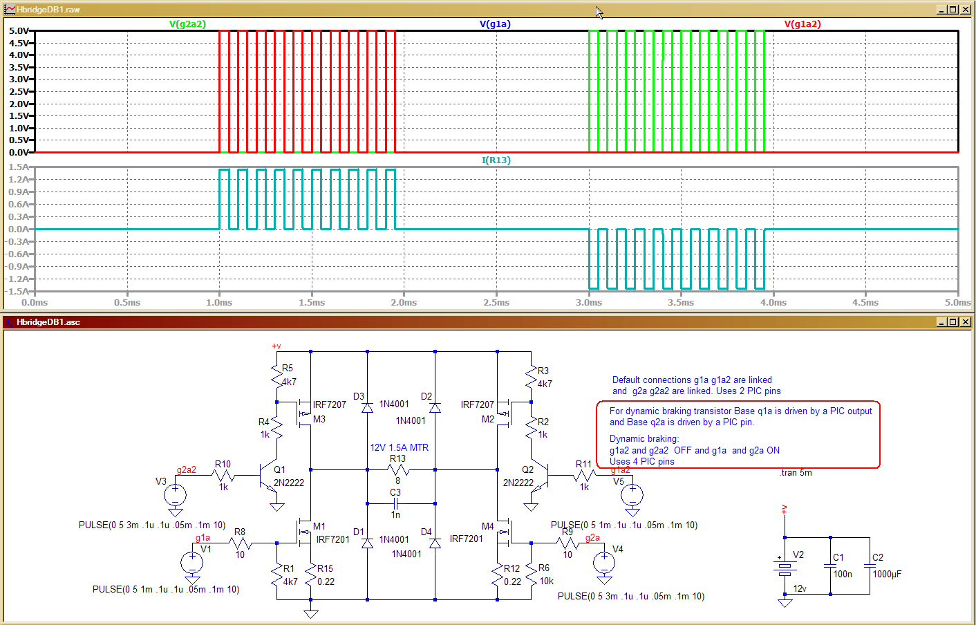

Hi Eric,
I have a simulation image sent from you last year, attached, with a note outlined in red. Is this now not viable, after finding the Oshonsoft PWM difficulties?
Camerart.
