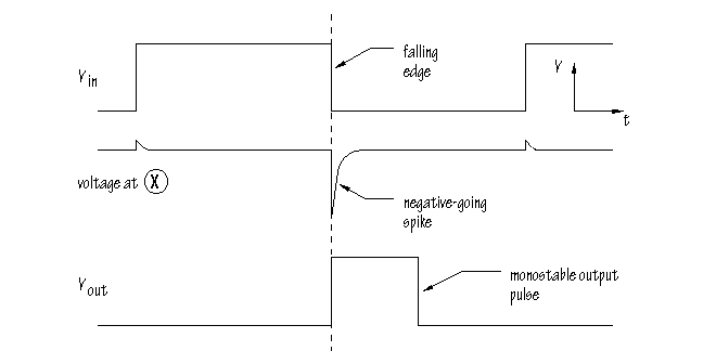

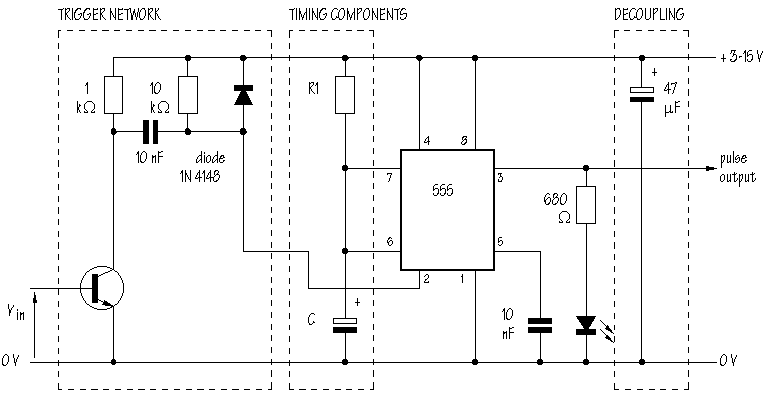

Hi Netguru5, the solution by Dougy83 looks simpler, if you want you can try this, here you can design the time you want the LEDs to be on, and the 1 sec. delay is exactly designed with those components, it will give 0.99 sec, the transistor in the CLOCK will invert that signal, so when the time delay goes high, it will be a LOW in the CLOCK and when it goes LOW after that 0.99 sec. the transistor will send the rising edge that will turn on the other LED.
That should do what you need, the first two images are the explanation of how is that going to work, and the last is what you need, it will also remember the last LED on turn on, but by turnin' the opposite when you turn on again, you won't exactly remove the power supply but by moving on and off that switch, and by the way, when you turn it off the on LED won't turn off instantly, it will be on for the time you programmed it, and then the other LED won't light.
It is not complicated, and not as big as it looks, by doing 1.1*C*R you will have the time ON of the monostable multivibrator, that will light the LEDs.

Sorry Karkas, I can't see how your circuit will work. You've tied the 2 outputs of the 555s together. If that wasn't the case, the LEDs would only light for a second after the change of state and then stay off. The clocking to the FF (and the feedback from the rightmost 555) also looks a bit sus...sorry I don't mean to be negative; just have another look at your circuit.
I haven't tested it yet but see, When the switch is closed, there is a positive edge at the clock, and that sets the FF, setting it means that Q* is low and because of the rrangement of those two resistors and the cap, thar 555 can be triggered, and it will last as long as Netguru design it, when it falls LOW, the right-most 555 is triggered, and it will last aproximately 0.99 sec. and that will inhibit the CLOCK, once that 0.99. sec are over, there's another rising edge at the CLOCK, and that will RESET the FF, doing the same thing in the opposite LED, did you see it?
I think Netguru is after a 1 second delay between the transitions of one LED going off to the other coming on; the LED then stays on indefinitely until the switch is pushed again.
The FF clk pin is not held at a defined voltage - perhaps a pull-down resistor is warranted? Also, check the two 555s on the left - are the outputs supposed to be connected together?
No, That's a mnostable multivibrator it won't be on undefinitely, none of them, and yes the two outputs are supposed to be connected together, because the third 555 needs the two falling edges to be triggered, that transition is between the two LEDs,
I'm maybe it won't work, but if it doesn't I don't think it will be for the cuases you're saying, no offense.
I'm sorry but tell me something, isn't that 10K resistor a pull down when the transistor is cut-off?
Having the 2 outputs connected together will mean that both LEDs will always be displaying the same state. To get the 3rd 555 to detect a falling edge from either of the 1st or 2nd 555s you could use a diode from pin 2 of the 3rd 555 to the output of each of the 1st & 2nd 555s (note 2 diode in total) - this will isolate the outputs of the 555s from each other and the 3rd 555 will then get the falling edge of either output.
The 10k is connected inline with the switch and won't be in-circuit until the switch is pressed. Perhaps the leakage through the transistor will pull the clock down when the switch is open, I don't know.

Yes you're right, the two diodes are necessary, well, I don't think it is necessary to put them on the picture, unless Netguru doesn't understand how to put them.
But tell me, a pull down resistor isn't the opposite of a pull up? I mean the pull ups are put in the outputs to make sure the desired output is given and that output is not in a floating state, what's the differenec between them and the pull down?
He is more clever than me for assuming that; I didn't mean to state the obvious.
a pull-up usually pulls an input high; a pull-down usually pulls an input low. It keeps the input in a defined state when it's not being driven by another source. The 10k resistor inline with the switch in your circuit does nothing until the switch is turned on.

I didn't assume that Netguru was going to put the diodes there, I didn't realized what you did about the HIGH in one output was going to turn ON the two LEDs.
Yes itdoes not do nothing, but the CLOCK will be low anyway, because closing the switch will give a HIGH level, coming from Vcc 'cause the transistor is cut-off, by the way, when you have an open collector in a gate, for example, you need a pull up resistor, not to pull the output high but to complete the arrangement of the internal transistor, that thing over there with the BJT is a NOT gate, if the 10K resistor wasn't there would be happening the same that if you had a NOT with open collector and you don't use the pull up resistor, so as I see it that's a pull up, I agree with you that's not a pull down, but do you think it needs it?
