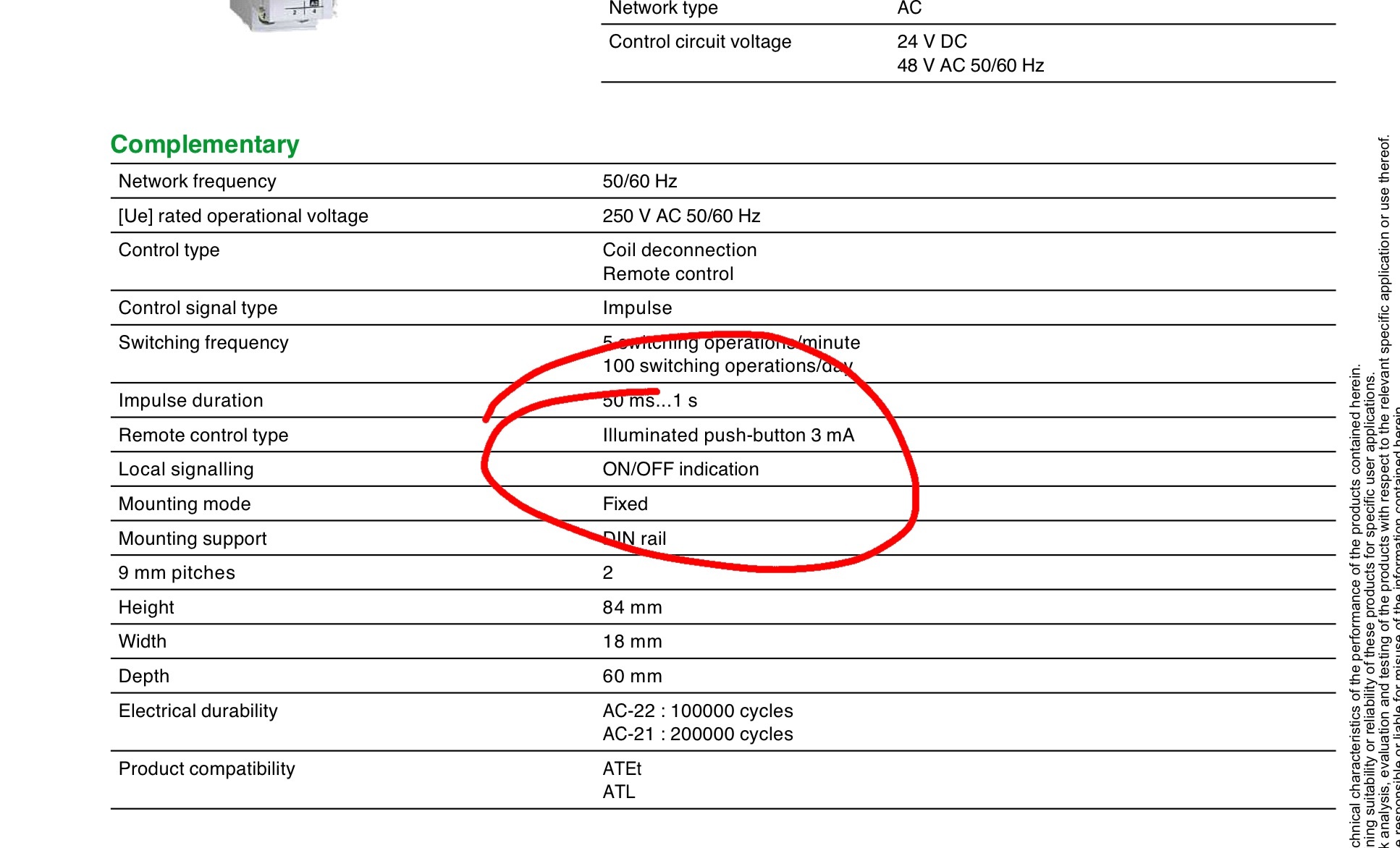

Obviously the data sheet of the relay isn't very good! The schematic suggestion using the same neutral for the pulse button as for the switched current seems odd to me and at least doesn't make sense if drive voltage is not the same as switched voltage???
Anyway, I am sure about the following:
- These relays take either 48VAC or 24VDC to switch
- The switch is supposed to be an impulse (recommended 200ms, but 50ms-1s are OK), but I'm sure I at some point read that they are designed to handle a constant load (of 24VDC) as well. Anyway, that shouldn't be a problem.
- There are 6 connectors: A1 and A2 for the input (24VDC) and 1-4 for the switched current. At every pulse (rising voltage triggers) on A1-A2, the connections 1-2 and 3-4 are switched on/off. There is never any other connection between 1-4 other than between 1 and 2 and between 3 and 4 when the relay is ON.
- So most places my plan is to have the 24VDC ground on A1 and 3. I send a pulse on A2 to trigger, one 220V wire (for a lamp) is run through 1 and 2 and I can read the ON/OFF status (as a 24VDC signal) on 4.

The data sheet says remote control is via a push-button switch @ 3mA. I doubt the relays draw nearly an amp.

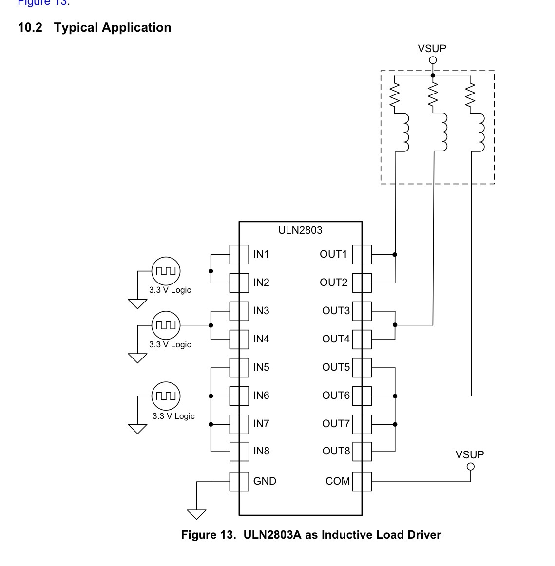

The wiring you described will not work with a ULN2803 which can only sink current to ground. V+ is connected to the positive side of the relay. The negative side is connected to the ULN2803, which grounds the line when activated. V+ is also connected to the ULN2803 for the kickback diode.

JonSea, I'm not sure I understand about the ULN2803. I can connect A2 to +24VDC and then the ULN2803 between A1 and the ground of 24VDC, right? Or are you saying I can't use ULN2803 at all here?
Yes, that's exactly right.
This drawing is from the TI data sheet. It shows several outputs strapped together for larger loads which you won't need to do.
VSUP = +24v, which is connected to the positive side of the relays AND to the COM pin of chip.
The GND side (well, the zero volt side) of the power supply is connected to the ground terminal of the chip.
The ULN2803 is a low-side driver. It provides a path to ground from your load.
The chip is wierd. The COM is the common point for all of the anti-Kickback diodes. COM isn't necessary to function, but is required for reliability. If you were riving LEDs, COM could be left unconnected.
