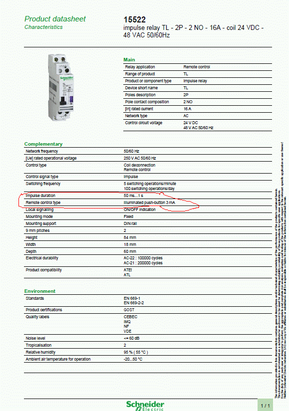

Are we making it harder than it needs to be? Look at Knuth's data sheet. Doesn't it say that it only takes 3mA to actuate the relay?
The ULN2803 is still the way to go, since the relays require 24 VDC. They're cheap and take care of all the details.
According to this data sheet, KnutH's 15522 relays are of the 2 pole TL 16A variety, which seems to have but a single pulse input, which toggles the relay to the opposite state each time it is pulsed.
I cannot find a confirmation that the open-circuit voltage across the normally-open pulse button is actually 24Vdc, or how much current flows in the button while it is closed. What a piss-poor data sheet!
It implies that the pulse button is returned to the Neutral line, which really does beg for opto-isolation between a digital controller board and the relay rack...
What a dumb way to build a relay!
Here's some additional information. Looks like the state toggles with each press of a button but there are some more complex options available.
If in fact the state changes with each impulse and there's no feedback to the control system, this isn't a great choice for remote operation.
