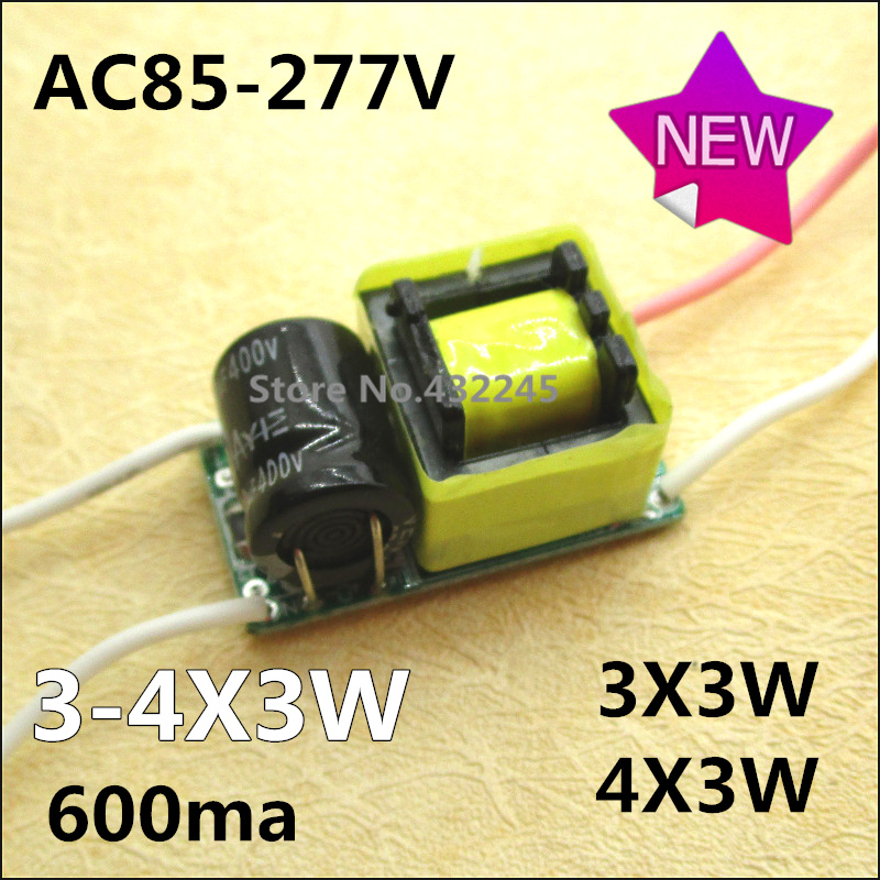

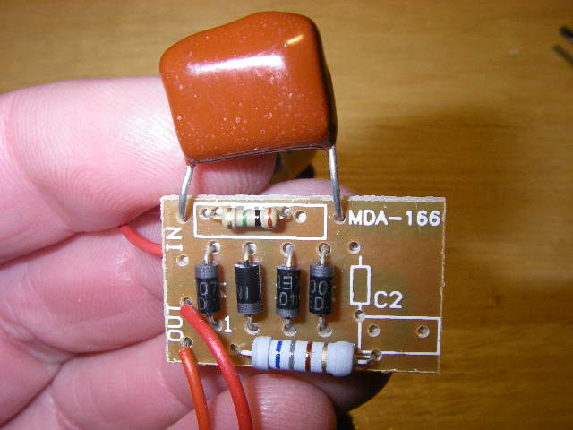

The problem is now the domestic bulbs (specially LED) consists with capacitive supplies or some high current drivers with a built in chopper transformers.

But that's not the problem.The problem is Does this Triac durable for capacitive loads or inductive loads? Such as capacitive LED lamps & driver driven LED lamps, CFL lamps etc?
