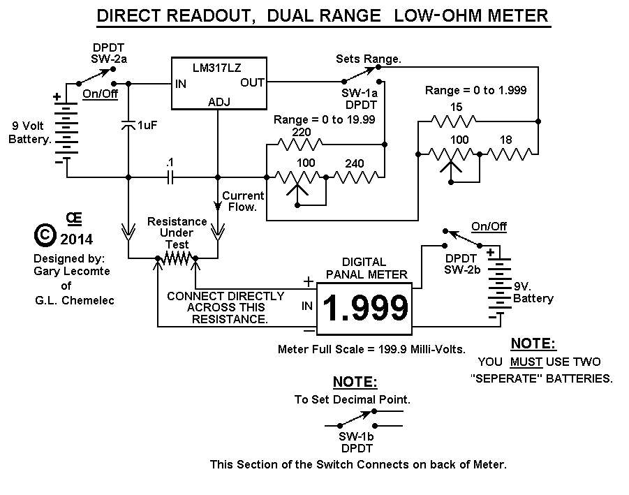

Some members will remember Chemelec - Gary, who passed away, seems like a few months ago, but I bet it's a couple of years .. .. he was a great bloke !
He showed me this and I had intended to build it but not yet got around to it; Knowing Gary's designs I'm sure it will work well .. .. .

I agree that Gary was a nice guy and provided us with many of his excellent circuits.

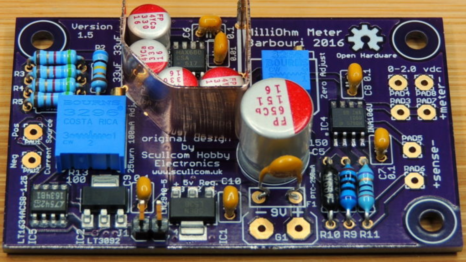

A friend of mine designed and built one the other year, very similar to that - he'd been wanting to built one for many years, but couldn't find a reasonably priced four point probe, then he discovered cheap parts from China :D
I was going to built one for work, but then I just ordered a complete meter from China.

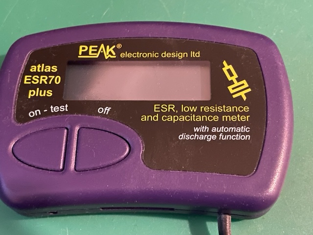

For info and depending on the accuracy you need, the Peak ESR70 meter reads low value resistance to two decimal places, eg. 10 mOhm increments - and it's a very useful device for checking capacitors, the main reason I got one.
And are made not far from me, in fact I visit a friend on the same Industrial Estate as Peak are - we sub-contract work to my friend.
The Peak instruments are also PIC based, but pretty expensive, I have two of them - where my friend has the full range, given to him for evaluation purposes as he's very near to them.
I actually have an ESR70 (old version) but there's no mention of using them as a low resistance meter, only for ESR - as it uses 100KHz for it's readings it's accuracy as a resistance meter would be suspect (such as trying to read wirewound resistors). Great little instruments though.
Looks like a great device; just more pennies than I can justify for something that might get used twice a year.
If you're repairing switch-mode PSU's (in TV's, set-top boxes etc.) then you use them multiple times per day for checking ESR of the electrolytics - otherwise you're unlikely to use it as much as twice a year, I've not used mine once in the three years or so since I stopped TV etc. repairs.
As I mentioned above, it's not designed for resistance measurements.
does it work OK then on wirewound resistors?

I don't have a large selection of low value wirewounds, but I've found three:
0.22 10% = 0.28
1R0, no tolerance = 1.34
1R5 10% = 1.82
As a comparison, a one ohm metal film 1% reads 1.00
It does appear to read somewhat high on wirerwounds.

Surprising on the 0.22 ohm, as when you look at them there's VERY few windings, so presumably not much inductance?.
However, it's always been suggested that you don't use wirewounds for emitter resistors or zobel networks in high quality audio amplifiers, because of their inductive nature.
