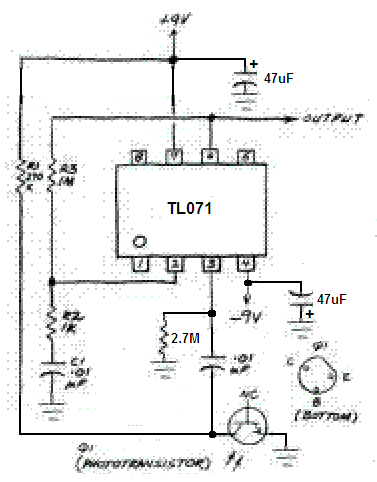

Also, what do I do on the attached circuit, do I run 2 9v's in parallel, +9v to the positive end of the battery, -9v to the negative end, and earth to the join between the two cells?

And above the photo transistor the diagram reads "NC" I assume that means don't connect that connection to anything?
I think you mean connect the 9V batteries in series and connect the earth to the point in between the two batteries.
Also note that you don't need to physically the earth symbol to the ground, in most cases it's just a reference point; if a circuit actually needs earthing the text explaining it will say so.
Yes, it stands for No Connection.
I think it is a stupid circuit.
The very old 741 opamp is inverting with a very low 1k input impedance produced by R2. But the impedance of the photo-transistor is 270k which is produced by R1. Then the photo-transistor is shorted by R2. DUMB!
The opamp should have a high input impedance of 2.7M so it doesn't load-down the output of the photo-transistor. Then the opamp should be a more modern FET input type and be non-inverting like this:

Cheers guys, Hero999 that is what I meant, audioguru I don't know about that, its out of a book collection of old popular mechanics articles/ projects. Best practical introduction to practical circuits I could find!

Maybe the stupid circuit designer is sneaky.
Maybe he planned the very low input impedance of the inverting opamp to be an attenuator. Then he could use excessive gain for the opamp which reduces its bandwidth. Then he didn't need to add two capacitors. SMART?
