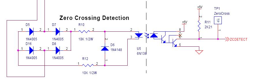

the triacs do stay on till it passes zero, BUT its important that the trigger pulse is REMOVED before this event happens...
SOOO....if light 1 delay has elapsed...i turn on the output... but i need to turn it off too...say after 1ms... (acual trigger time i cant find in datasheets) - apparently its very small time...
so how would i turn it off???
i dont understand ur code that well mate... i dont really know what ur gettin from it...
also my ZC detection is a bit weird... when the sin wave starts... the pulse goes high...after 10ms, the sine wave passes ZERO AGAIN (going down)... the ZC pulse stays high for a further 2ms... then goes low... then when the sin wave rises again, it goes high... so the freq is 50hz, but duty cycle is about 60% when it should be 50%...why this happens i dont know...
IDEALLY id like a ZC pulse whenever the wave CROSSES zero...but mine doesnt so i cant use ZC interrupt...as it would only happen every cycle..i need a pulse TWICE a cycle...

I would look into fixing the ZC detection - it should not be that hard. Getting a square wave should be pretty trivial. With a square wave at 50 hz, you can still get interrupts every 10 mS. there are at least 2 ways and probably more. RB.0 (aka INT) can be programmed as to which edge it sees. You simply flip the edge sense with each interrupt. Or you can use the Int on Change feature of RB.4..7 which will interrupt when ever there is a change on any input pin of the upper nibble of PORTB.
I think you don't see the power and flexibility of the timers. You can create a timer chain to create an arbitrary sequence of timed events.
why don't you post your ZC schematic?
here there are 2 ZC circuits...both are quite identical, and to be honest ive mixed and matched them...
ZC1... i have wired it WITHOUT THE 4 DIODE ARRANGMENT...everything else is the same...inc the 1n4148 diode,,,
ZC1... this arrangement WITHOUT THE DIODES is what i did, but i didnt use the 1N4005 for the diode across the inputs... the signal looked better when i used the 4148 that ZC1 used..
will i need this 4 diode arrangement to full wave rectifiy? should i get a different looking signal????

I would have used an AC opto, like the H11AA - much simpler. https://www.fairchildsemi.com/ds/H1/H11AA1.pdf
why did you remove the diodes? try putting them back in.

that chip...it does exactly what my circuit does but in a package... excluding pull up and the 2 input resistors...
so i DO need the full wave rectifier,,,???
You mentioned needing an inital delay (2 mS, iirc). I think that was because of your ZC was off.
yes, you need the full wave. as I said in my last post, "try putting them back".
